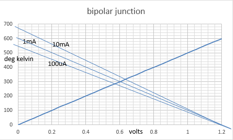

                          Don't have graph paper so I tried with Excel. Don't know how to remove the chart line. Hope the rest is correct.
                          Have to admit it took me awhile. Was worth doing.

                            That's it, Green. Once you've got that much, it's obvious how to add a line corresponding to any other current. Since you can know what change in current produces what change in voltage, you can know the AC resistance. Since the lines diverge uniformly the AC resistance is proportional to the Kelvin temperature. If you like doing 2:1 differences rather than 10:1, think in decibels. 2:1 is 6 decibels, 10:1 is 20 decibels, 2:1 is therefore 0.3 of 10:1, so if a current change of 10:1 is delta 60 millivolts, a current change of 2:1 is 30% of that or delta 18 millivolts.
                            Remember that the assignment of 1 milliampere to 0.6 volts and 300K is arbitrary, although many small signal transistors will come close to that. It's really about current density, so for a big honkin' power transistor that line might be 1 ampere. All the rest of it is still valid. For example, if you operate the junction at 1 mA, at 300K its AC resistance is 26 ohms. You don't have to look it up in the data sheet, the data sheet won't tell you anyhow.

                              Thanks green, to help me understand DJ drawing instruction (my English bad).
                              Here is my try:
