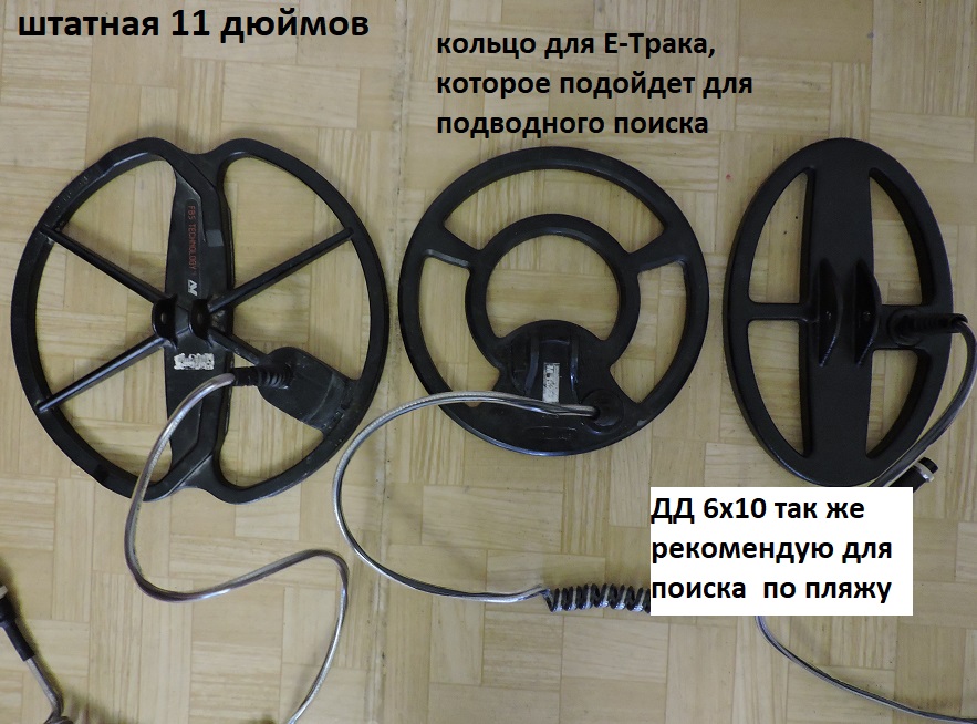

                  I don’t know anything about E-trac coils - why them vs homemade coils? What about the accelerometer - is it in the Etrac coil and that’s why it was chosen? I’d really like a bigfoot coil for the CTX. Sure the CTX as it is blows away most anything with a bigfoot on it today for depth but depth isnt everything - when the wet sand isnt producing sometimes I use an xlt with a bigfoot and work the dry sand. I’m also hoping a custom coil can find gold chains. The 11” finds pretty small gold but just misses the chains. This adapter thing means it maybe possible to interface a pinpointer... Whats next with this guy - will he be sharing the details?
                    Everything is known about E-Truck coils. They are made by various companies and radio amateurs. I also do the coils for E-Trac, such as in the photo.Click image for larger version

ID:	350964 In this video there is all information, for those who are engaged in metal detector coils. Video tells that the coils E-Trac and CTX3030, the same. Only in the CTX3030 there is an electronic board. The windings are the same. If you make a coil for E-Trac and insert an electronic board into it, the coil will work with the CTX3030. And if you pull out the electronic board from the CTX3030 coil, it will be a coil for E-Trac. And if you make an adapter, then all E-Trac coils will work with the CTX3030. Written through translator.

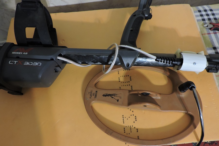

                          Do you have any tips on getting the board from the coil? An Excalibur coil has its board secured inside with what may be epoxy. I have one a guy tried to get access to and it was hopeless. I realize this board is different than the one in the CTX coil but just wonder if the CTX board is just as hard to remove.
                            Electronic board CTX3030, in the coil CTX3030. The other is not.
                            In other coils, other circuits.
                            It is necessary to disassemble the coil CTX3030.
                            Carefully.Click image for larger version

                              I about to obtain an 11" non-working CTX coil. How do I remove the board without damaging it?
                                Carefully, nothing more to add.
