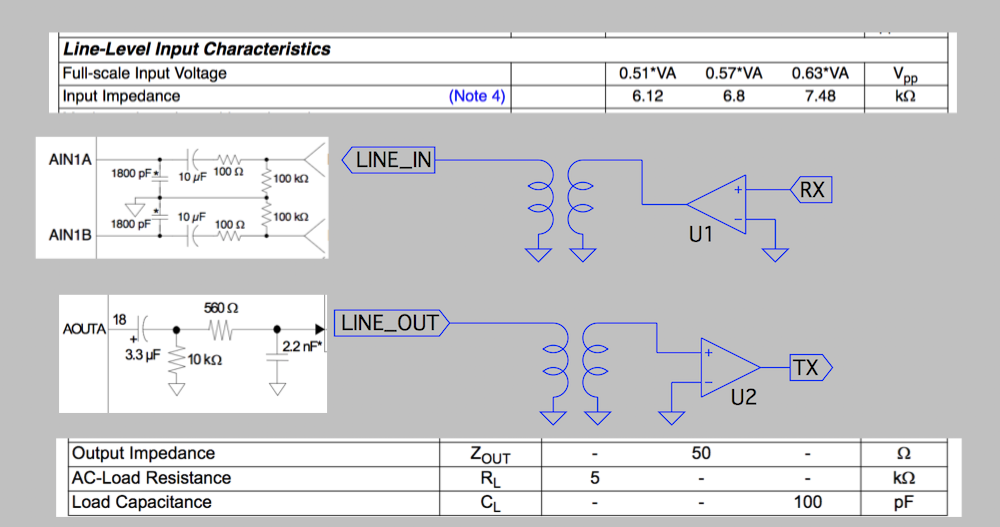

    I plan to use my soundcard to do some signal processing, however I noticed that the ground of the sound card is quite noisy, so I had the idea to use an audio transformer to galvanically isolate the analog front-end from the sound card.
    There's a lot of variety of audio isolation transformers, most common are 600Ohm:600Ohm and 10kOhm:10kOhm, what would be the best choice if I have the following source and load impedances:
    I have connected circuits to PC sound card and know about the noise issue. A RigBlaster to connect Ham Radios to PC sound card has been the best noise free interface.
    http://www.westmountainradio.com/rigblaster.php
    A schematic is:
    http://www.westmountainradio.com/pdf/Schematplus.pdf
    The Sound Card transformers are 600:600 Ohm.
    Good for you to actually experiment to find what works best.
      I worry a bit that the 600Ohm transformer might load the line-out too much? I attached some interesting PDFs about the topic:
      "Using the Creative SoundBlaster X-Fi Surround 5.1 Pro USB sound interface asbaseband sampler for QSD based SDR receivers
      "Audio galvanic isolatorFor soundcards and SDR receivers"
        The x-formers recommended in those pdfs are 1:1 600 Ohm.
        Remember that this is 600 Ohm IMPEDANCE not Resistive since Audio is AC not DC.
          Going to try this, I still have some old 56k modems with 1:1 600ohm line transformers in them
            Those should work fine.
            Post back on what you find.
