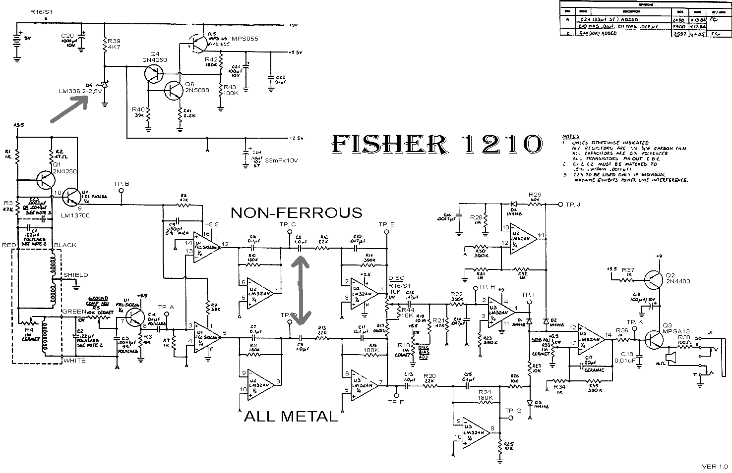

    My brothers, I build fisher 1210x as per shematic, can you tell me if I can use zener diode instead of lm336, .47uf instead of 1uf?
    A 2.5V Zener should work for D5. This sets a Reference Voltage. Just Measure that you do get 2.50V.
    0.47uF should be ok since these are AC coupling to the next stage.
    Of course you could parallel two 0.47uF caps to get 0.94uF which is close enough to 1uF as AC couplers.
      Yes, thank you very much. Always good to ask questions, even though the answer might seem obvious. But why did designer use special lm336 instead of ordinary zener. I'm just curious to know if their is some benefit.

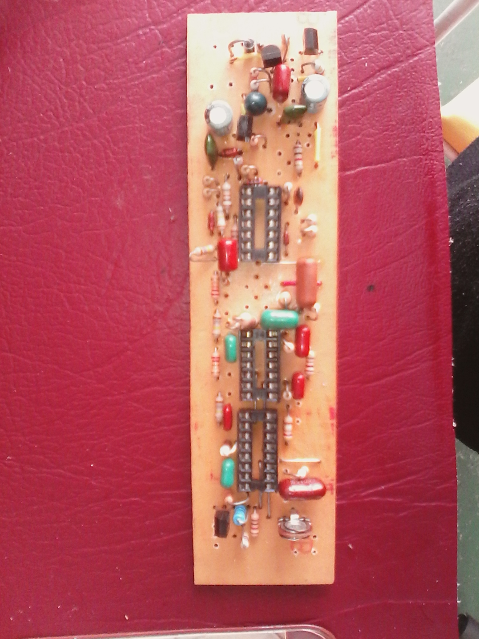

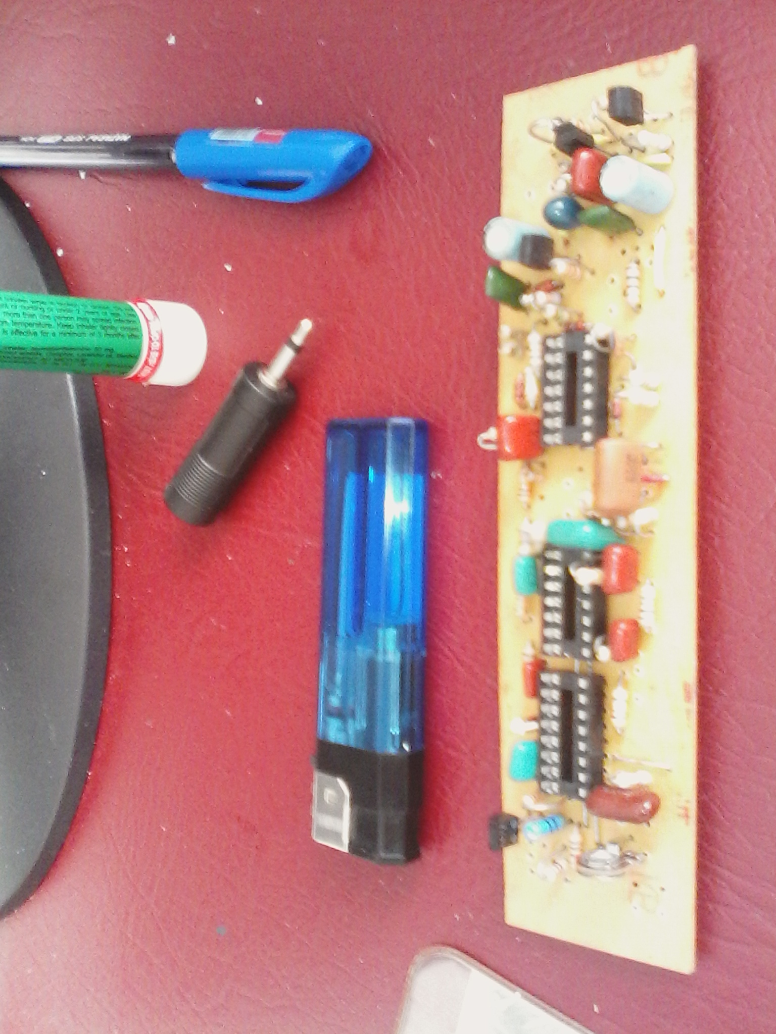

              I fully understand. Thank you. I used this very compact layout that I corrected, now it is good, the pin connections for op-amp chip are re-arranged to suit layout, but opamp- for op-amp are good, if you get my meaning.

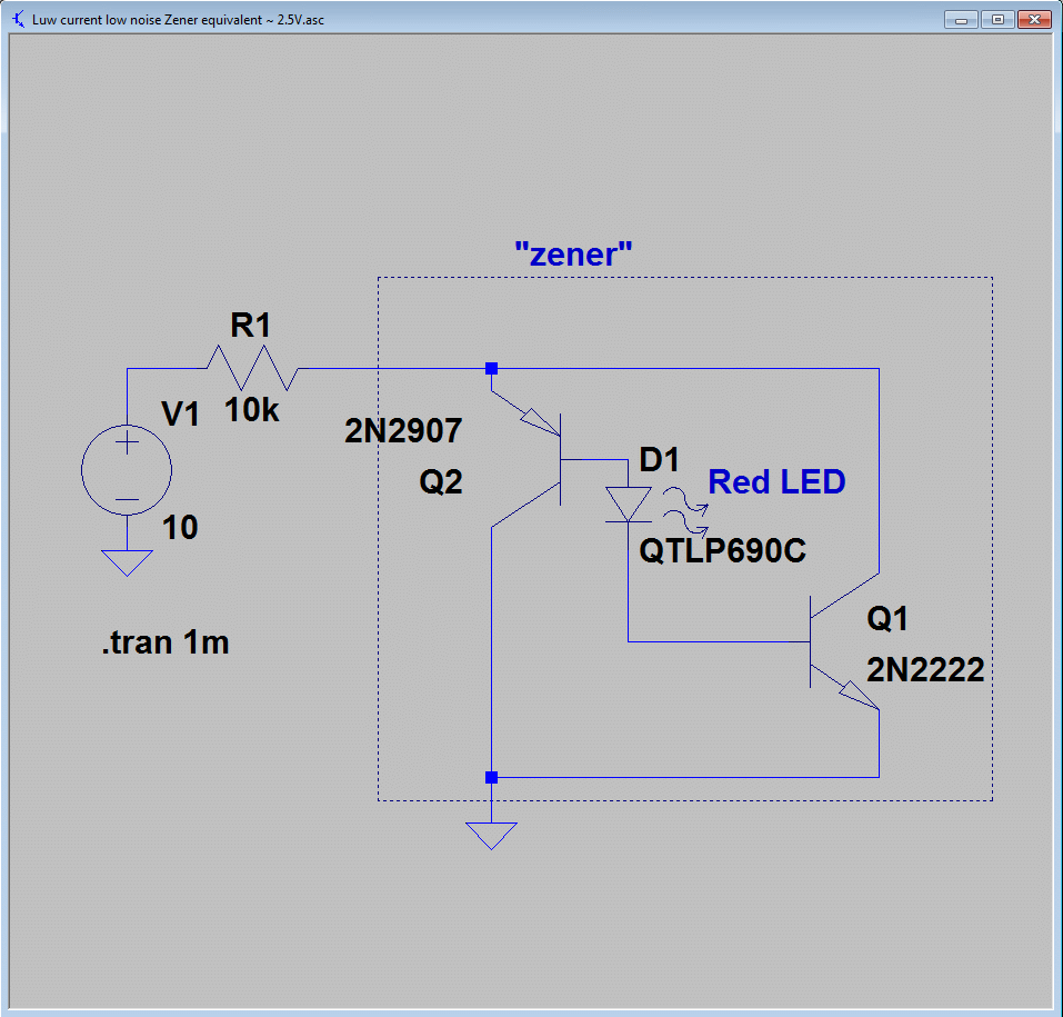

                A good substitute of a 2.5V zener can be produced using a pair of transistors and a red LED. It is even temperature compensated, and has superior noise to a zener.
                  Thank you very much, here I was digging through old box looking for 2.5 volt zener, guess what, I have a million zener diodes, but not a single one around 2.5volts! Its probably the only one I DON'T have! What rotten luck. Now I can use your circuit as substitute, thanks again.
                    There are red LEDs with different barrier voltages, but you'll get voltage close enough.
                      Yes of course, I have a bunch, will see how it works out and post results. I have a feeling that this little 1210 circuit has been under-estimated by many as good project for simple turn on and go detector.
