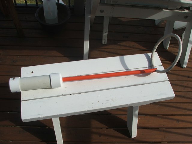

    With my Pickini up and running on the bench I have now started work on the waterproof housing for it.
    My intention is to make a detector suitable for shallow water snorkelling, but since I have had no experience with this type of detecting I am seeking advice on what dimensions are the most practical.
    This photo shows my housing to date -

    At the moment the entire thing is just a press fit with no glueing or seals.
    I would like advice on such things as -
    best length for shaft (currently 50cm)
    best angle for coil to shaft. (this angle will be fixed once completed)
    My concern is that if the shaft is too short the electronics may interfere with the coil and if too long it will be difficult to swing under water
    The housing is 20cm long 50mm diam pvc water pipe, the shaft is 50cm of 20mm pvc conduit and the coil housing is 16mm pvc conduit.
    50cm is too long - with such a relative small coil you can use 30cm without significant interference-problems.
    This is much better for sweeping and pinpointing while diving (also for scrubbing sand etc aside).

      I'm afraid I have already started the assembly of the housing and it may be difficult to alter, but if the housing is successful (and the Pickini works underwater!) I plan to build a modified Mk2 version.
      At the moment my biggest hurdle to overcome is going to be in keeping the sea water separated from the electronics. Fortunately I have enough spare parts on hand to build several more Pickinis.
      For a target indicator I plan to use a high brightness white LED inserted through the housing, sealed in and angled back towards the operator so it should be readily visible.
      Ultimately I hope to use vibration as well but ,at the moment, am trying to adhere to the KISS principle (Keep It Simple Stupid ).

            I've manager to 'shoe-horn' the standard Pickini board and 3 X 18650 Li-ion batteries into the pvc pipe housing.
            It was a tight fit getting the board in and I had to cut the excess fg from the sides of the board right back to the copper tracks.
            The next task will be to get some o-ring grooves machined into the ends of the pipe to seal the end caps but still have them removable for battery charging and adjustments. I would have preferred threaded end caps but there does not seem to be anything available to suit the pvc pressure pipe.
            The wall thickness is 3.3mm and I plan to use o-rings with either 2mm or 2.4mm c/s diam - the grooves will need to be very close tolerance!
