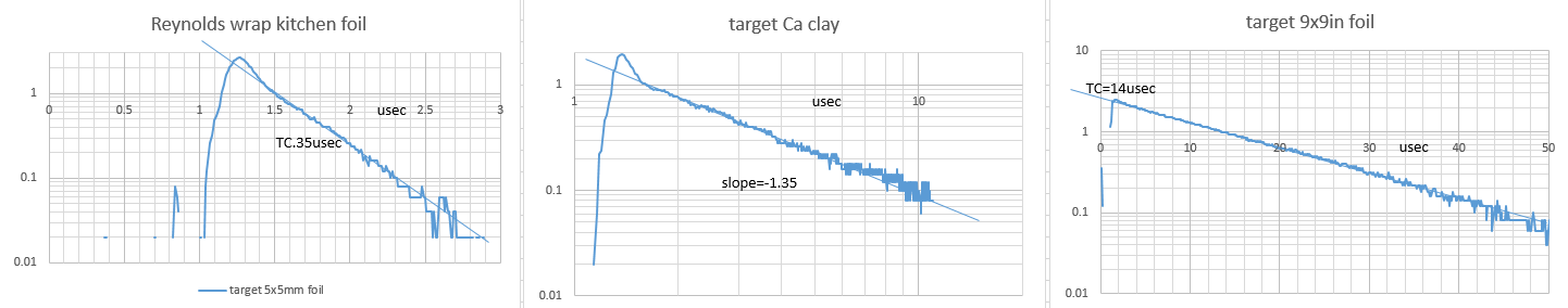

    Thinking about updating my target response tester to include a log amplifier and other modifications to compare with the decay curves I've been doing. Tx rate (1pps), Tx shape(constant current .5A peak or constant rate 1A peak), Tx width(adjustable 50usec to 50msec). Preamp(gain 450),post amp(gain 9). log amplifier(after preamp).
    Discussion: constant current peak 1/2 of constant rate peak for same average Tx current, the lower the constant current peak the shorter the ramp time to peak, preamp and post amplifier the same as I've been using, need to modify constant rate circuit to allow adjusting Tx width while keeping 1A peak, Tx rate 1pps for low average Tx current,
    Questions: any reason to make Tx rate adjustable? any changes or additions?
    Comments or thoughts appreciated, would be easier to include changes now than modify latter.

    What I would like to get is a digital scope module to use with a Windows laptop and that has both linear and logarithmic Y and X axes. If only Y then that would be good, but an X Y would be great for soil magnetics too where I need a LogY LogX display. If anyone knows of one that does not cost the earth, please let me know.A statement Eric made in another thread.
    The reason for wanting to add the log amplifier. Been wanting to add the Tx width adjustment for constant rate. Never used a log amplifier IC. Not sure what to look at in the data sheet. Been looking at log114 and MAX4207 log amplifiers. Anyone used either one or maybe a different one to look at? The log114 looks a little faster, has 7 instead of 5 decade capability. Think maybe 3 decades is all I'll need do to amplifier noise out. Don't know how fast it needs to be. Including some charts I made awhile back with a faster coil. Don't know if log114 or MAX4207 would be fast enough for the 5x5mm aluminum foil. Maybe someone familiar with log amplifiers could make a guess. Not eliminating present capability so if the log amplifier doesn't work with shorter TC targets it wouldn't matter.

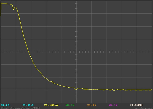

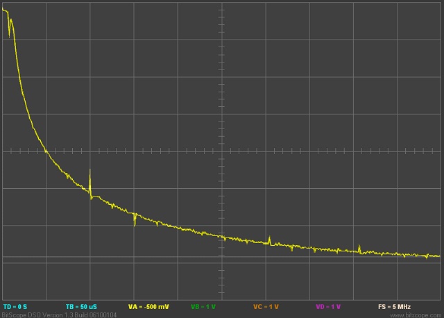

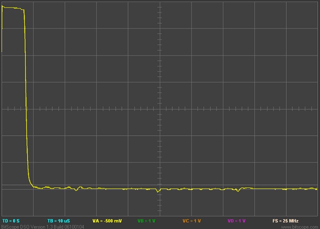

                    I've resurrected my digital set-up with a eight year old BitScope module and laptop to get better pictures. These I have inverted so as to get the decay the more conventional way up. Much better quality is achieved this way as the picture is saved to computer memory and no camera is involved.
                    1st picture is without target in coil. 2nd is with a Nickel and 3rd is the silver quarter. Time base 10uS for the first two and 50uS for the quarter.

                      Hi Eric, like your pictures. Very good trace after 5usec delay.

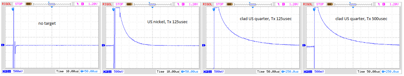

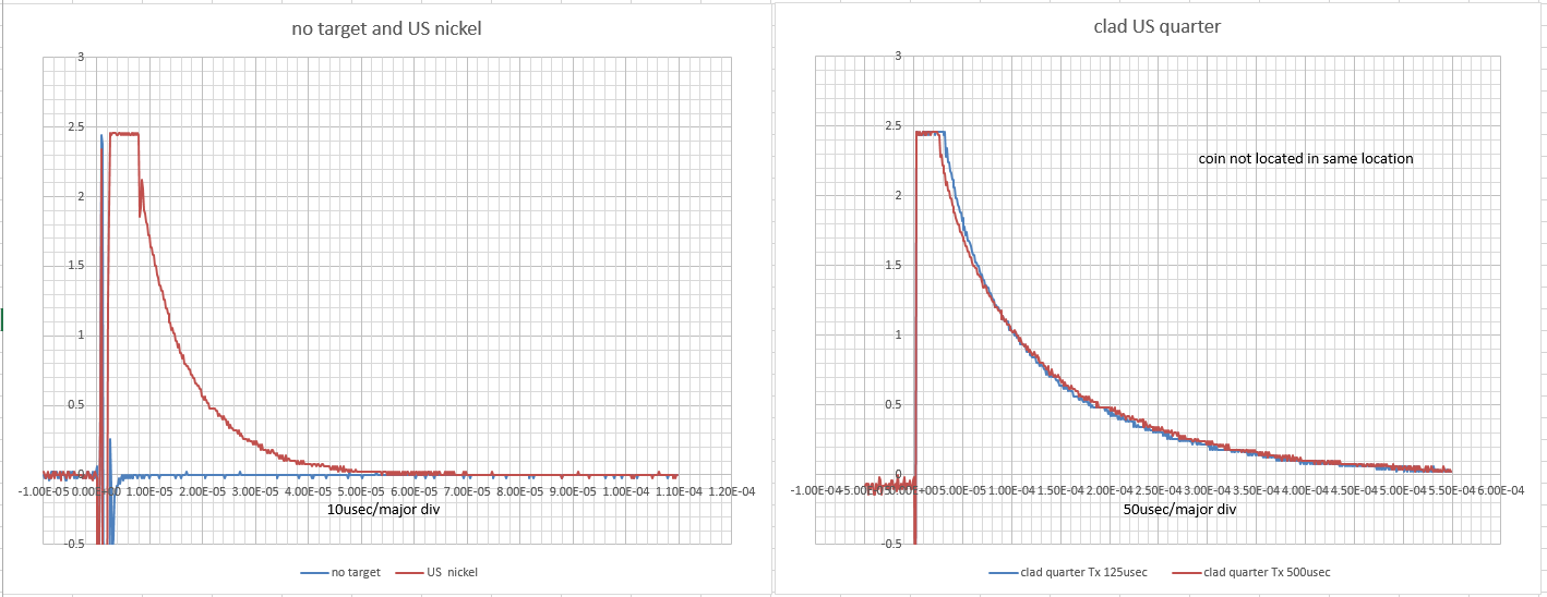

                      Including some pictures trying to repeat your test. Used a clad quarter since I don't have a silver quarter. My scope screen pictures aren't big enough to get TC numbers. Copied recording into Excel and charted, single recording not target-no target recording like I normally do. Our nickel traces crossed 20minor divisions at about 8usec. My quarter crossed 20 minor divisions at about 40usec instead of 30usec where yours crossed, changed target distance trying to get 30usec at 20 minor divisions for the 125 and 500usec Tx . Excel chart about the same size as your scope screen pictures. About the same readability.
                      Tried to get TC from your pictures. Nickel: time between 10 and 20 minor divisions 6.25usec/.7=9usec or time between 1 and 20 minor divisions 30usec/3=10usec. Subject to readability.
                      Quarter:time between 10 and 20 minor divisions 63usec/.7=90usec or time between 1 and 20 minor divisions 470usec/3=157usec. Subject to readability.
                      Looks like with a good zero and enough readability at 1 division the calculated TC isn't much different at 125 or 500usec Tx with my Excel chart. Maybe a 10% difference using time between 10 and 20 minor divisions. Wondering why the TC difference is higher between the two methods with your quarter. Maybe I'm reading it wrong. What was your Tx width?
                        Quote:"I was wondering why the TC difference is higher between the two methods with your quarter?"
                        I think the likely answer is in part related to where you choose your 'Zero' on the vertical scale. Your estimate of a drop from '20' to '1' might actually be '19.7' to '0.7' , which is a drop to (0.7/19.7) = 0.035 rather than (1/20) = 0.05. Hence your division factor would change from ln(0.05) = 3.00, to ln(0.035) = 3.35, which is 12% different. I admit it's not explaining-away all the discrepancies. If you measure decay from '30' to '15', you get TC = (85 usec / 0.693) = 123 usec. Similarly from '10' to '5' gives (85 usec / 0.693) = 123 usec. both more realistic.
                        If you drew multiple versions of the graph with a log vertical scale, and used different 'zero' values, you'd find one with a decent straight-line, I'm sure.
                        It's also likely that readings before t = 50 usec may be skewed by the initial more rapid fall-off that your (Green) charts show. The problem is that on a linear vertical scale, deviations from the ideal constant TC don't show up, it's all curve.
                        You will be somewhat surprised to know that Eric's "5c/nickel" chart actually matches what VLF machines make of that coin. Info on the web will tell you both George Payne (Teknetics etc) and Troy Calloway (Troy Detectors) say it has a fc about 17KHz. I've measured it (at 13KHz) as fc = 16KHz; TC = 9.95 usec. This time, the target coin and my machine's freq are well-matched, so the results should be good. And... interestingly, the skin-effect doesn't have much influence, either. Skin depth is very dependant on material conductivity, and affects silver/copper the worst, and bad conductors like Cu-Ni much less. So my VLF will actually see all the 5c coin.
                        Here's a wiki page on Skin effect, it mentions the difference between Cu and Aluminium being significant, and they're both quite good conductors.
                        Cu-Ni has a conductivity about 5% IACS, so it's skin depth should be Square-root (20) = 4.5 times that of copper / silver / the US 25c 'quarter' coin.
                          Hi Green, A clad quarter has a decay that is almost the same as the silver one, so my results will be valid for both. The TX width for the quarter was not optimum for the test as it should have been about 600uS and was in fact 400uS. Forgot to readjust it. Also you say 'Very good trace after 5usec delay'. The target trace starts after 10uS and I just wonder if there was confusion as the TB10uS is under the second vertical line which in reality is 20uS.
                            Thanks, you are correct, I did get confused. I was using 10usec/div but wasn't thinking when I replied 5usec, saw the 10usec under the second line just like you replied.

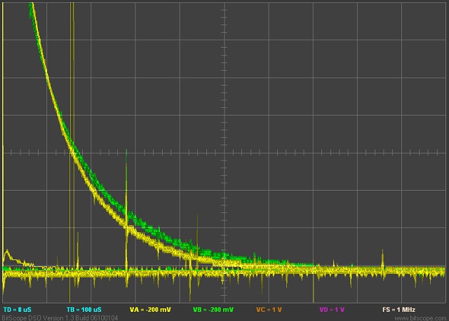

                              Here is a plot showing the small difference in the decay of a silver quarter (green trace) and a clad quarter (yellow trace). I had to to this in persistence mode, hence the fuzzyness of the trace which accumulates a lot of random noise. TX width was fixed at 1000uS.
                              Eric.Click image for larger version
