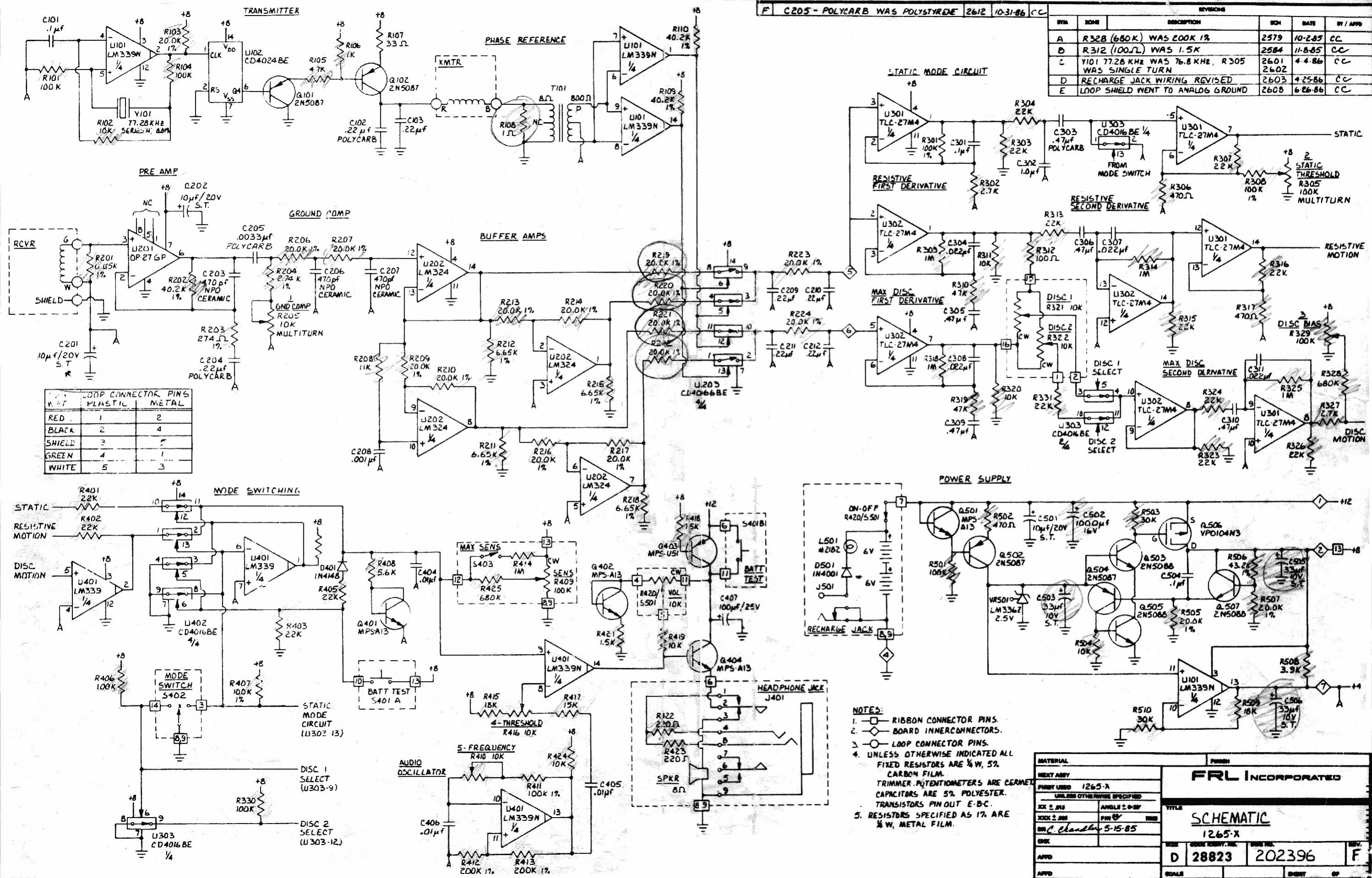

Help repairing Fisher 1265x
    U303 there's a dead short between pin 5 and 6
    Can't see on the schematics. Am I missing something ?
    Dam they are suppose to be connected.
    All transistors and diodes look okay. I will keep looking
      Pin 13 of U401 I get 411Hz and 7 Vpp almost square wave. So guess the audio oscillator is functioning okay. Although I never get a proper been in any mode
        Pin 9 of U401 look badly wrong. It's got supply volts on it ???
          Feel like an idiot.
          Testing the ribbon cable to the front panel everything was measuring wrong.
          I had put the cable on 180 degrees out. I don't remember the twist in the cable at all. It was a few weeks before my parts arrived.
          Lucky to get away with it. It is working as it was.

                    This is the schematics that match my machine.

                      Should be able to work this out without randomly changing capacitors.
                      I guess the extra load of R331 is why disc 2 continues to work while disc 1 fails.
                      U303 and switch have been changed.
