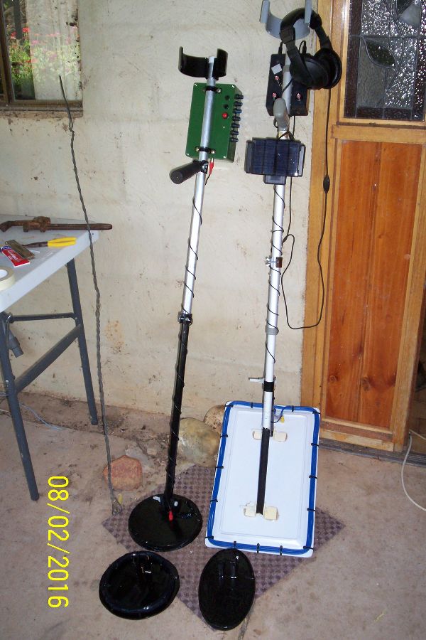

              I have successfully built the Baracuda and like it very much. It was a while ago now, and I did not make it waterproof. Mine has external delay/threshold/volume. I was able to build it without an oscope, but had to use a larger R pot to get threshold. That was the previous version to the one currently available. It has a preset self adjustment, but this could likely be made into a VSAT by replacing the appropriate resistor with a pot. Same with the SurfPI, but for waterproof/underwater it is best to have these things preset as external waterproof pots can fail.
              The Surf, being a longboard, can be easily fitted into a PVC pipe type waterproof casing. I also have the SurfPro I got as a completed board off Ebay (tacoma56). He does DIY kits too. It has external controls and is configured for DD coils. With Minelab/Coiltek coils it is a very impressive machine.
              These are all PI's designed specifically for the beach, but the Surf/Pro have extensive threads here on their modification for inland and small gold specifics. A fast coil is the first consideration before all else.
              As for the technical differences, I am not versed enough to extrapolate on their dis-similarities.
              For an IB, and with arduino experience, you would do well to consider berntes suggestions, but coil winding/making could be a challenge.
              As for the cheapest option, populating your own Silverdog board and making a PI coil would be best.

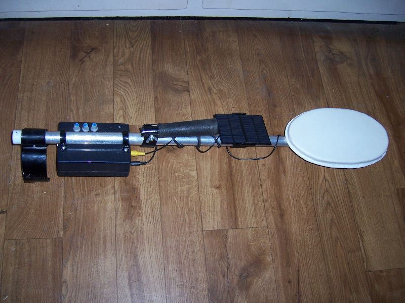

                yatahaze how old are you ? Personally I think Gifting your father a metal detector you made, is a beautiful way to learn something and make your dad proud of you achievements. you need to figure out what you want out of a detector , VLF or PI, If you Get a PI kit you ll be able to hunt in parks and beaches alike, but you will also be digging up a bunch of nails,bottle caps,pull tabs..... but you will also find all the good stuff too. A good rule I was told about metal detecting is, DIG IT ALL no matter the target.
                Do you have access to a 3d printer that prints ABS ? if so I would gladly share my files for the detectors I made , which are the Geotech Barracuda which is a fun easy build but take longer to properly setup, Then there is mini pules plus, which is a Good around Detect and if you are smart enough to follow the build guide to the letter, written up by our very own George ( Thank once again George :-) for all your efforts for us ) its a guarantied successful build. there is a lot of ways you can build a kit detector and keep the price much much lower then you would a store bought one and Learn a lot along the way.
