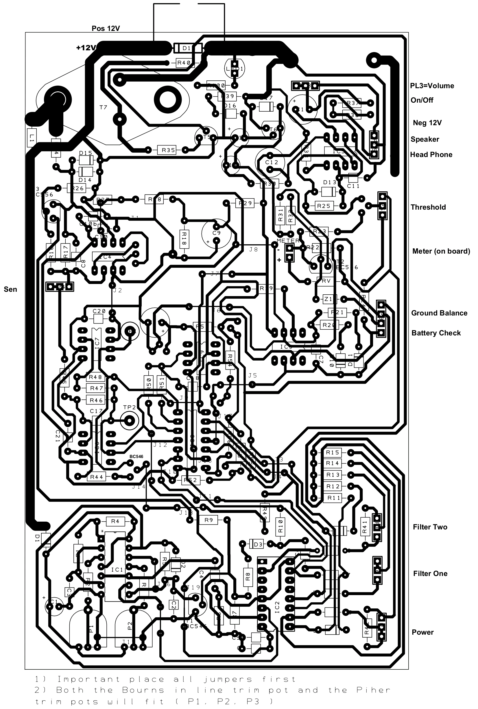

Oooo very good work.

It is used to adjust signal to pin 2 IC8 set it to voltage be about as voltage on pin 3 IC8, affects the potentiometer for treshold,I gave my device to a friend and I can not tell what's happening but I think that's what I wrote affects the adjustment thershold !Originally posted by kadir6141 View Post
