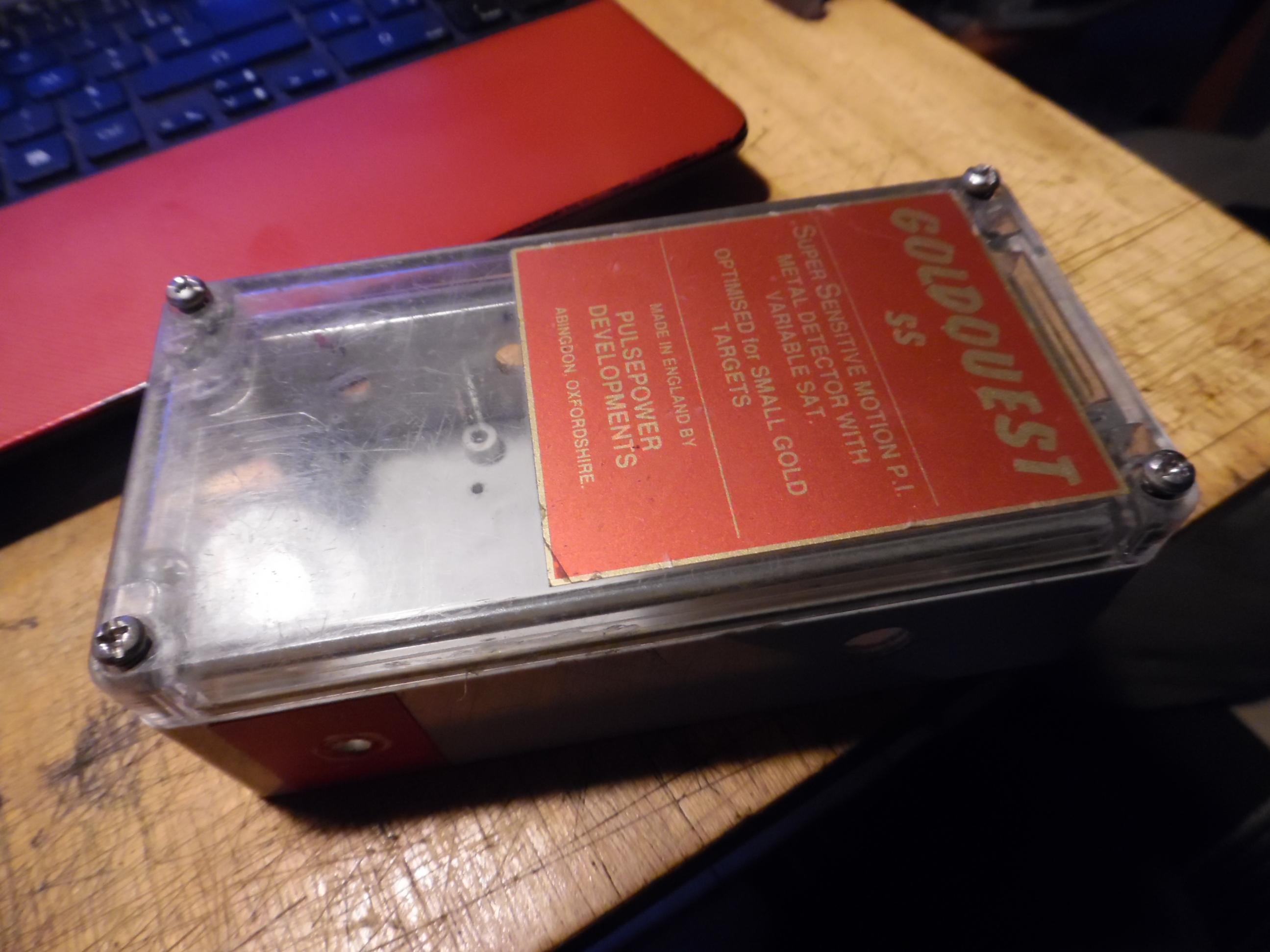

    hello
    I want to replace the case of my goldquest ss.
    who knows a seller of identical box, or the reference of the box?
    thank you and good day
    fred

    t could be one of these:
    https://www.digikey.com/products/en/...word=enclosure
    Also check Mouser using their parameter search.

      hello tifred,
      order from tme.eu
      fast delivery and best Prices
      just an example (also in other colours and size)
      https://www.tme.eu/en/details/z-74h_...dex/z74h-blue/

        Hi Fred,
        The exact case is made by Bernstein CT581T (polycarbonate) or CT582T (ABS) the T signifies a transparent lid. Size 120 x 80 x 55mm. There should be a supplier in France. In UK there is Farnell, but shop around for prices.
        Polycarbonate is harder to drill than ABS. It needs clamping down tight otherwise it rides up the drill and will be spoilt. ABS is easier but still needs clamping. A step drill is safer than a twist drill.
        Eric.
          oh, thank you all for the info!
          I will find a brand new golquest!
          very thank you !
            https://www.tme.eu/en/details/z-57jp...ex/z57jph-abs/
              thank
