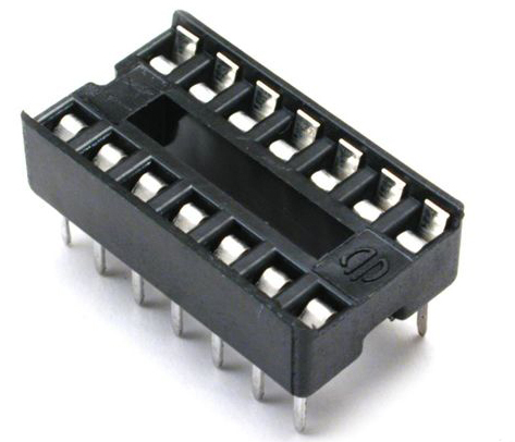

      This is just a random thought, that rang a bell when I was using gold plated machined IC sockets. I no longer use the IC sockets you used. Sometimes the internal pins break from the socket if you remove and replace IC's often. And you may not notice the broken IC socket. I now use the cheaper sockets, pictured below without any problems. This may or may not be your problem.

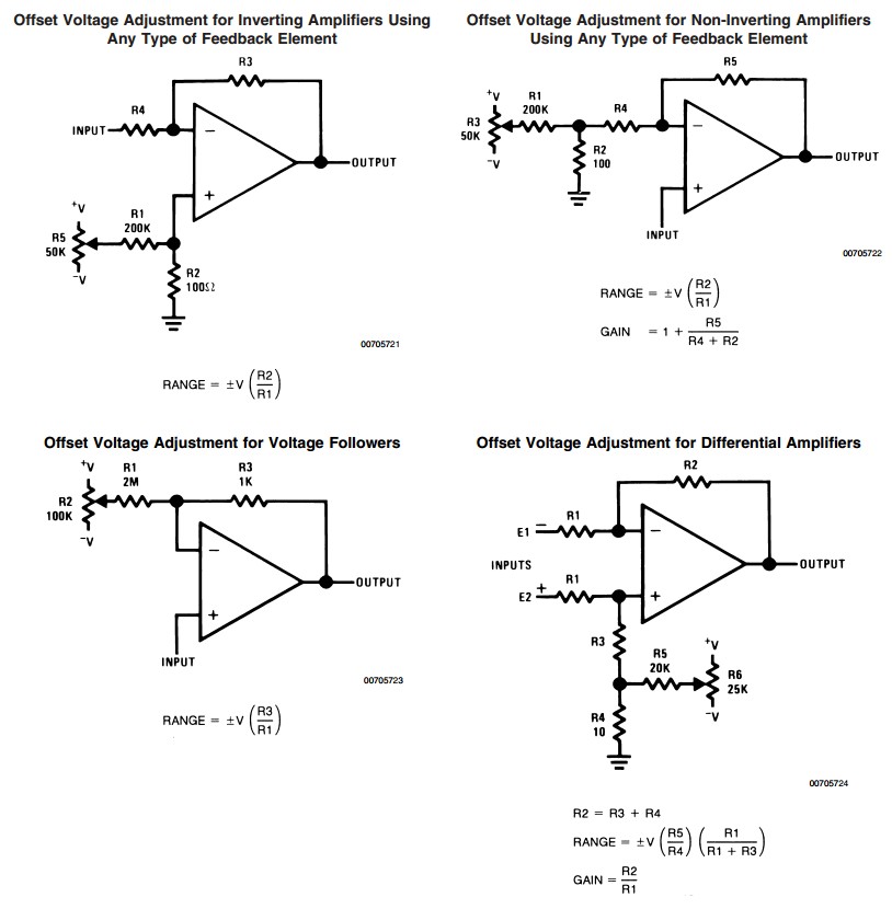

        I dunno if you want to waste more time on these chips, but just for fun while you have the breadboard out, just to get some satisfaction from these chips you could try some generic off sets
          Another good suggest and I was also thinking this.
          Does a simple inverting or non-inverting circuit work with those op-amps.
          Set for a gain of under 3 and use a pot as a Voltage divider for the input.
            This is an excellent point, sven1. I have noticed previously that the machine pins do fail quicker than the cheapo ones - The lack of the springy contact also does kind of bug me however I mitigate that by keeping the IC legs slightly bent outwards, and giving them a gentle squeeze when inserting it - to ensure a nice firm fit within the socket's holes.
            While very valid, and it did cross my mind after I'd removed and replaced the chips a few times, this also unfortunately wasn't the problem in this case.

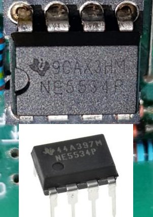

            PROBLEM SOLVED!
            Solution:
            DON'T BUY IC'S FROM EBAY
            I've only just gotten home and inserted a NE5534AP by On Semiconductor (the fakes were TI). At first it was sounding constantly - and then I turned the offset pot a little and it actually changed the offset!!!! Obligatory air-punch, pelvic thrust and loud cheer.
            It's now detecting a sterling Aussie shilling at around 20cm, and a 20c coin at around 25cm. As far as I've seen quoted from other people who've used this unit, this seems like an acceptable range for before proper calibration. I'm now going to try the other coils I've made to find which one has the best detection distance.
            What a relief. Thanks again for your help with this everyone

                    I'm considering throwing one of each in a beaker of acid and comparing the dies under the microscope. While I won't be able to see individual components I can see if the entire layout is different/simplified, which is often the case with counterfeits...and if I can get photographs of the dies I'll post those too - but in the meantime I do want to say THANK YOU to everyone for all of your input and guidance - you're legendary!
                    pictures of those dies would be very interesting, i've often wondered just how many fake chips there actually is out there, how many times have projects been built that seem to work ok but actually have gimped components in them.

                          Comparing the chip you got from ebay vs. other pics on the net from other sources, the appearance is quite different.
                          The rough lettering, logo, recoated blacktop surface, I dont think TI would be proud to let that one out of their factory.

                            Take a look at the 555 in my pics - no notches or markings WHATSOEVER to show a definite pin 1. I just followed "usual practice", and treated it as pin 1 being bottom left of the text.... I'm not sure if this is common or usual practice with these chips, but certainly was one of the things pointing me strongly twoards thinking it's counterfeit also....
                            I don't have a 'guaranteed genuine' TLC555 yet to compare with... Though the circuit does actually seem to work with this one...
                            And I think I'm in for a bit of chip flipping - looking over my collection of 40xx chips, I have many of the same series which look completely different - glossy/matte, flat/indented markings, mismatched notches, round/square/bevelled edges... Maybe I can improve the performance of my surfboard by finding a "better counterfeit"
