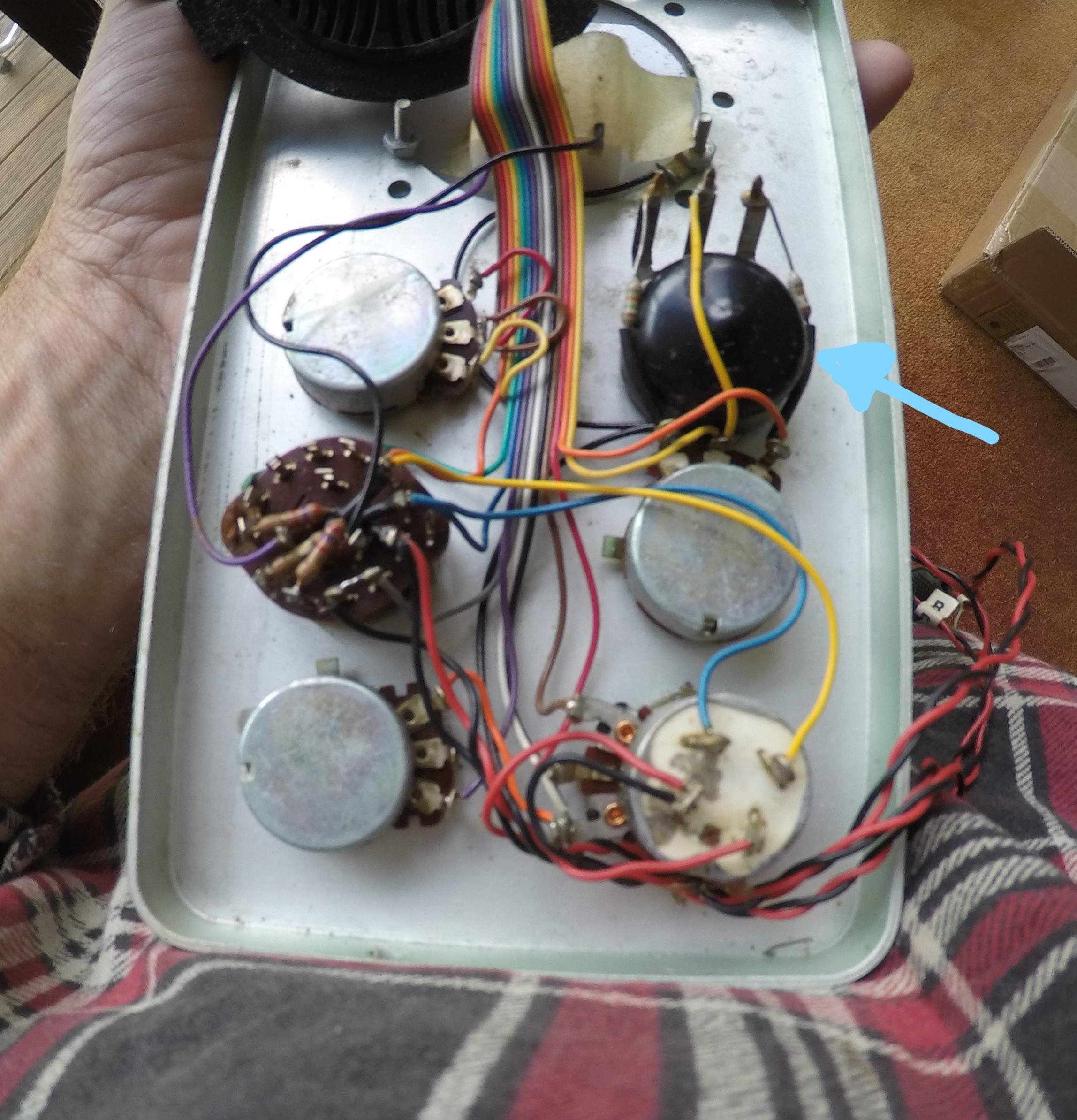

I have acquired this detector non working at a good price so I think, Replace a few caps that where leaking on the board and then walla it works, happy days.

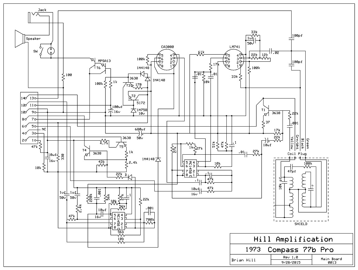

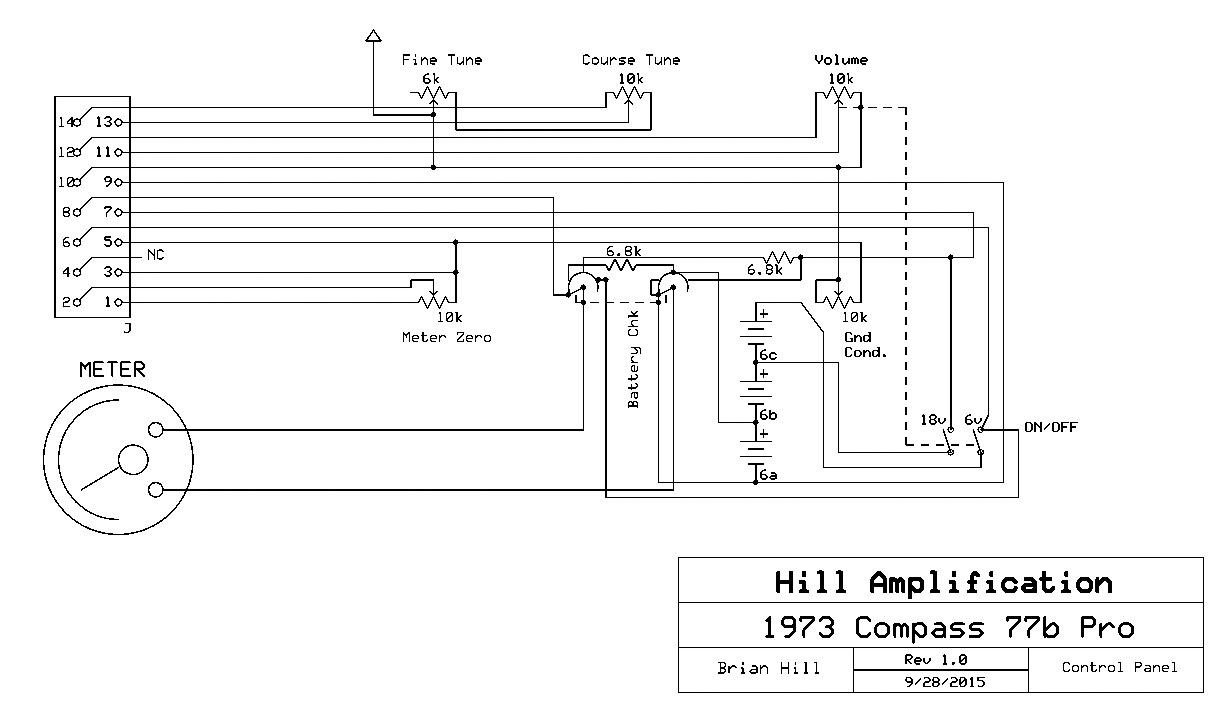

the only problem is the fine tune pot has sized and can not fine any numbers on it, the depth of the housing I was wondering if this was a multi turn pot. I have searched for a schematic and read quite a few post but not much available on this 77b. As I can not measure resistance on it been sized and if I try to take it out of the housing I Know it will tear of the shaft as it very corroded, looks like it either been in the water or high humidity
Can anyone put me in the right direction for this pot please
