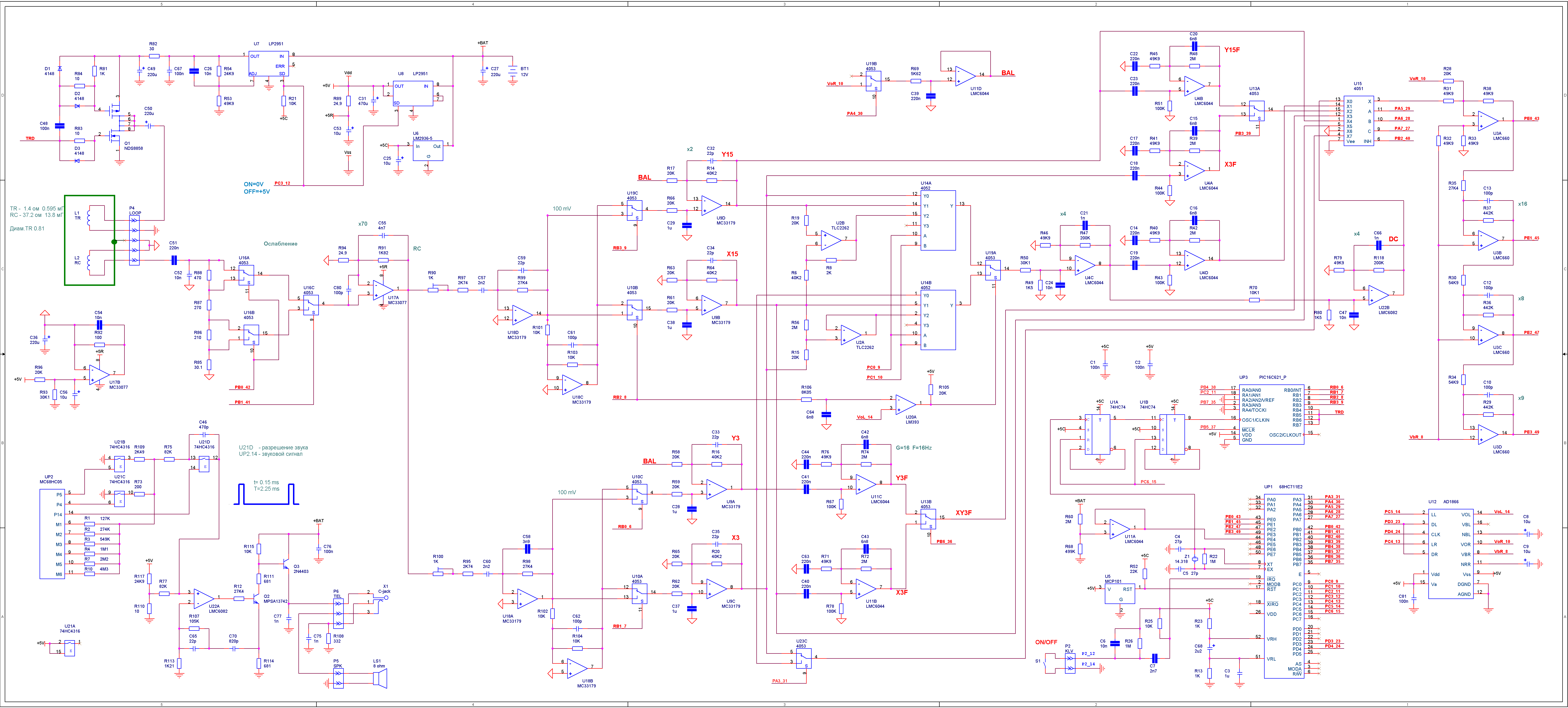

    Hi, a friend has fried his Whites DFX with a reverse polarity battery.
    Are there any circuit diagrames or repair blogs avalable?
    Currently reading the xlt repair posts which may give me some pointers.
    Geoff
    you can load whole block of whites VLF schematic https://dfiles.ru/files/88n8zxpc2?redirect
      hi thanks for the files ,a lot to look through.
        I had the same problem with the Whites DFX, it had a cold bundle code - a battery contact and when I replaced the LP2951 and the LM2936-5 detector was working.

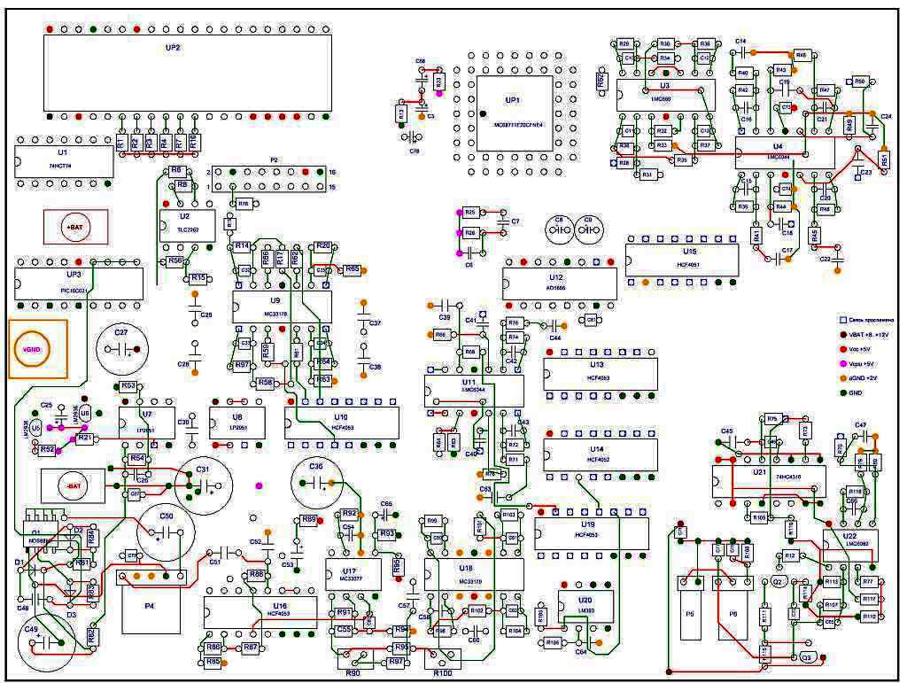

                I used this one.

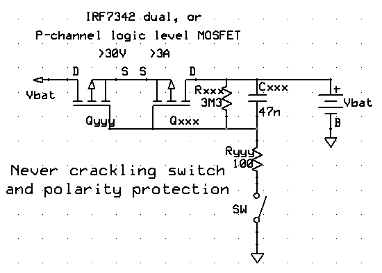

                  Once you fix it, put something like this instead of a power-on switch. It acts both as a crackling prevention, and as a polarity protector.
                    I was going to put a diode in series as protection but your idea looks better idea.
                      I like it because if everything is OK it will pass the battery voltage with virtually no drop at all.

                              Hi , I finally got hold of the dfx .It was totality dead so I replaced is u6 u7 an u8 the voltage regulators. Now the dfx turns on and the display is normal.
                              BUT it bleeps about every second and when a key is pressed once its as though its being pressed a number of times repeatedly. No debounce ? . trying to scroll through the menu is possible but eratic.
                              Any ideas ?
