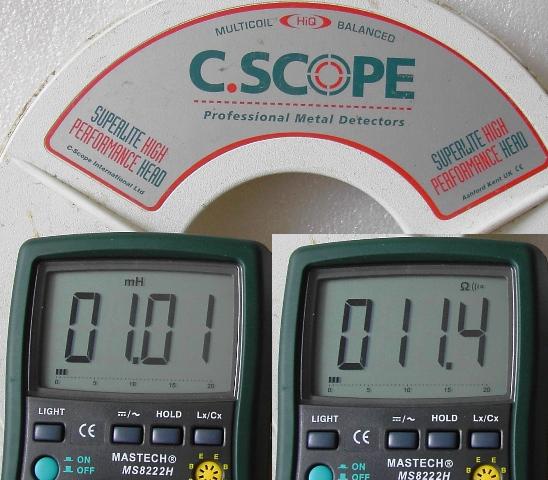

              thanks KT, i will check your link. I know goldquest is very sensitive to small gold, i don't try to replicate that, i'm interested only in depth of gold rings. Coil inductance is not critical, i will try to add some series resistor to see the result.
                Did some research on the forum and found some old post regarding GQ coil. It looks like goldquest has 300-350uh with 30awg(0.25mm) wire.

                    ok. TX pulse is 30uS - so decrease PULSE WIDTH to 30us. do first step.
                    second step use 1mH coil.
                    or then be back to NORMAL for surf pi frequency - 600Hz.
