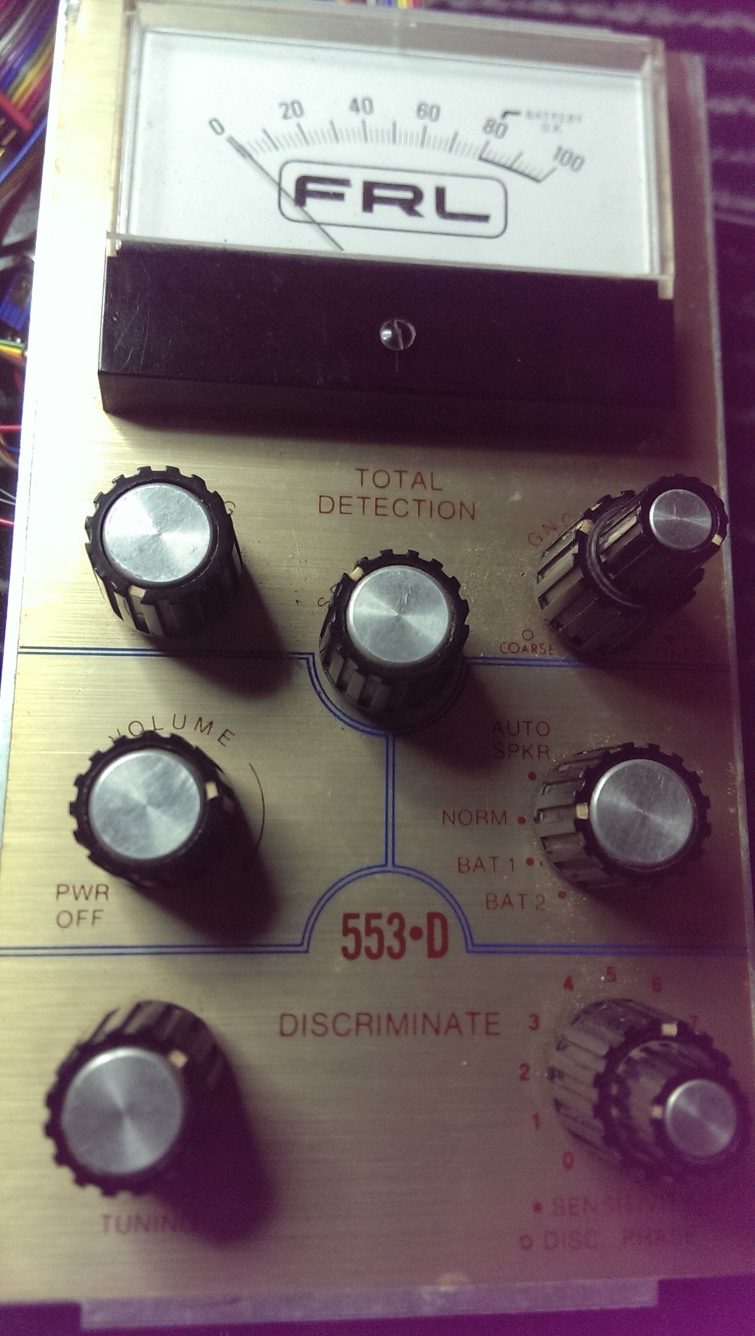

    I am trying to bring back to life this old fisher VLF 553D Metal Detector. The switch at the end of the handle is snapped off, is this actually a toggle switch or a push button switch on these detectors, also is it possible to remove the rubber grip because it looks like it maybe glued on. The detector is showing no signs of life apart from the needle on the meter pegging hard left.

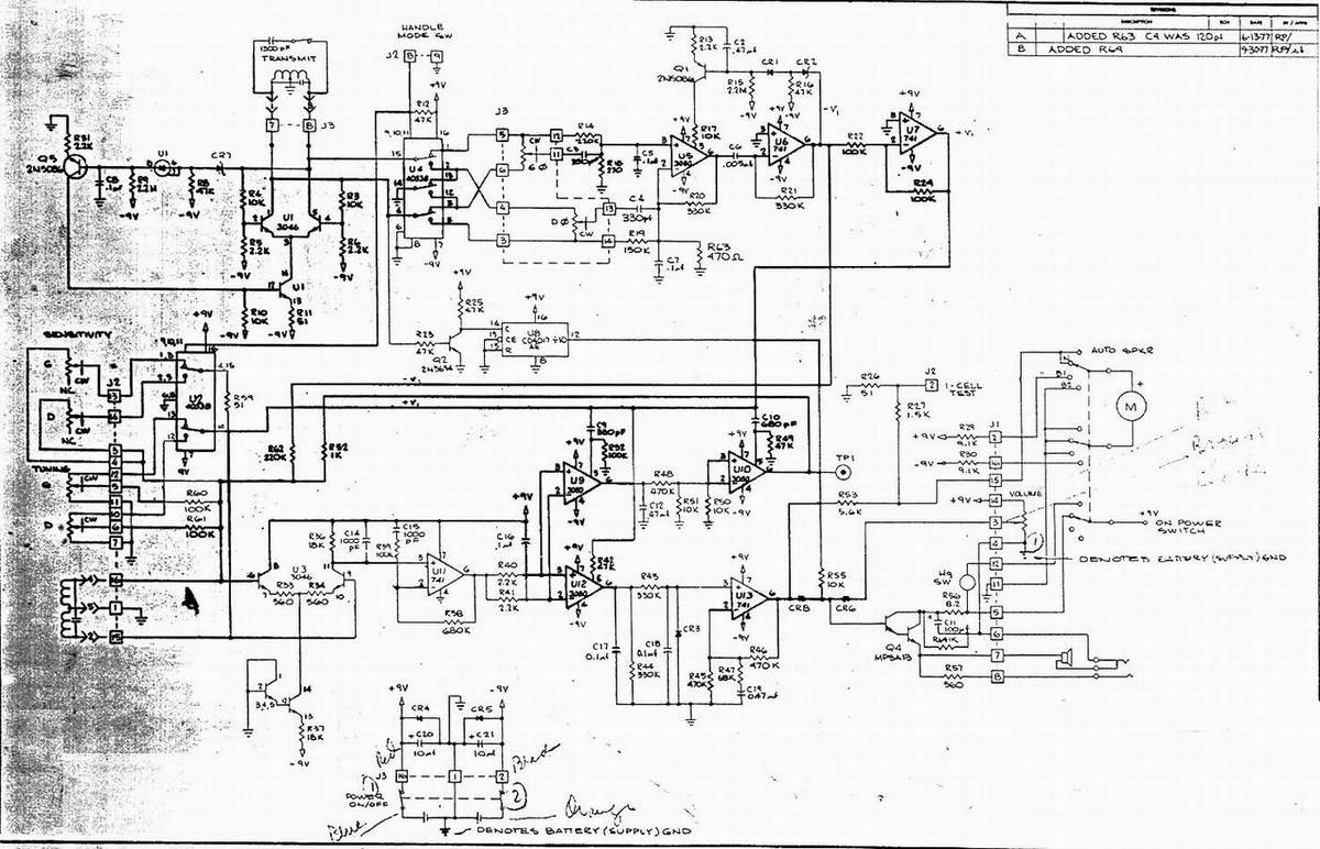

      Here's the schematic for the 533.
      I could not find a User Manual for the 533, but the 552 version states that it's a push button on the end of the handle.

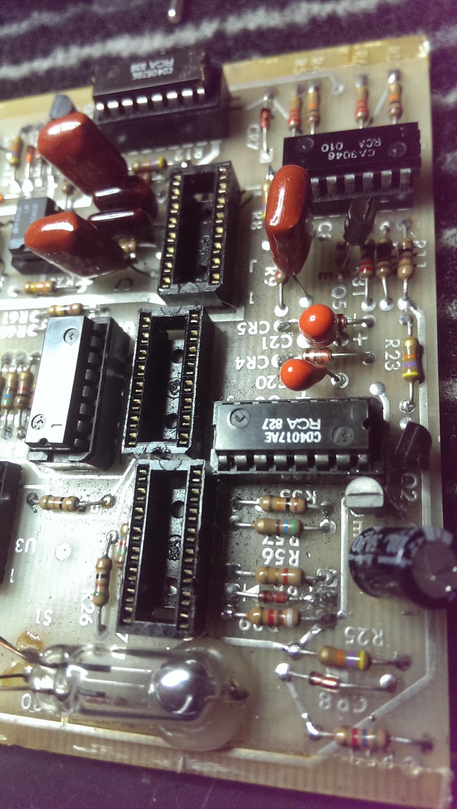

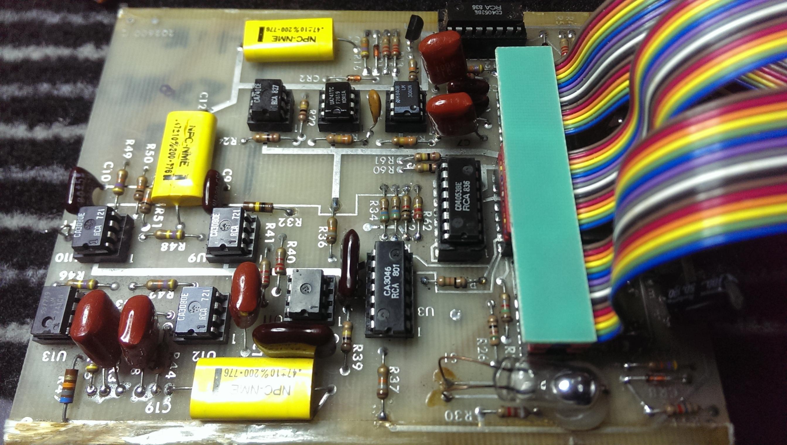

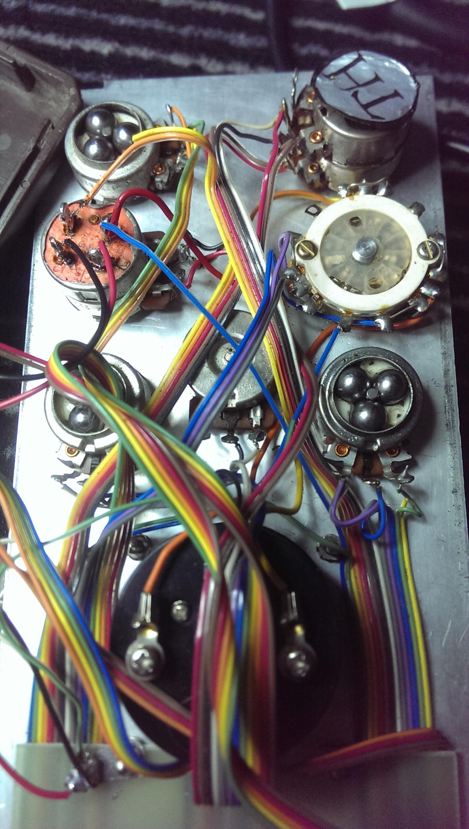

                    I will post a photograph of the detectors internals once i have fitted the toggle switch and wired the 2 new Battery Connectors in. A transistor to replace too. The phantom dabbler has tried to fix the detector before i got this detector i get the feeling. I just hope the coil proves to be good.

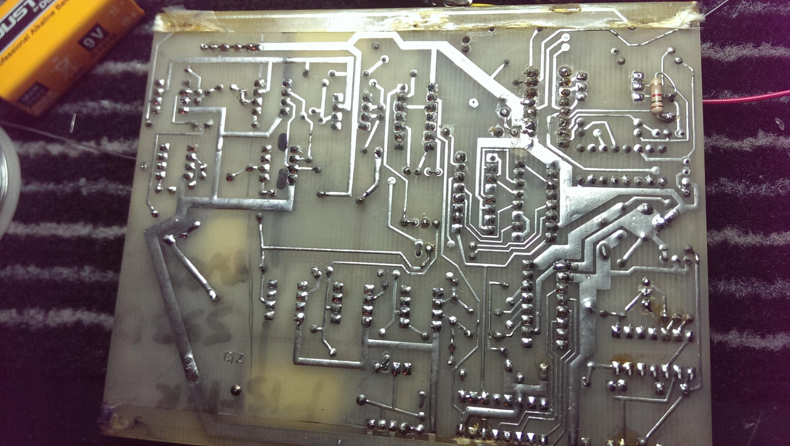

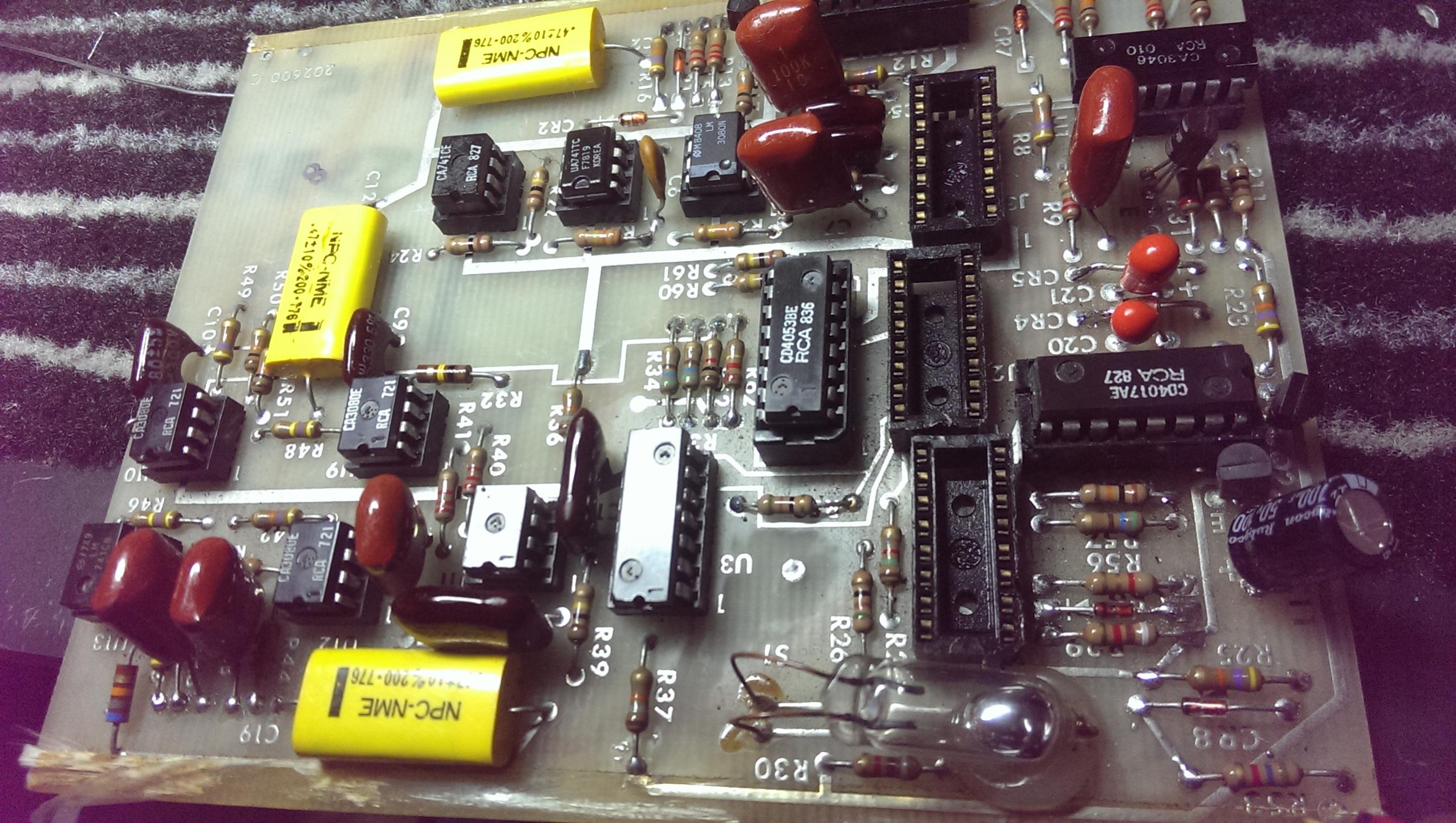

                            I hope these pictures are acceptable but it's the best i can do.
                            Did a few quick supply voltage checks on the chips , turns out some of the chips have the correct 9 volt supply and some are at about 0.5 volts will test more later.
