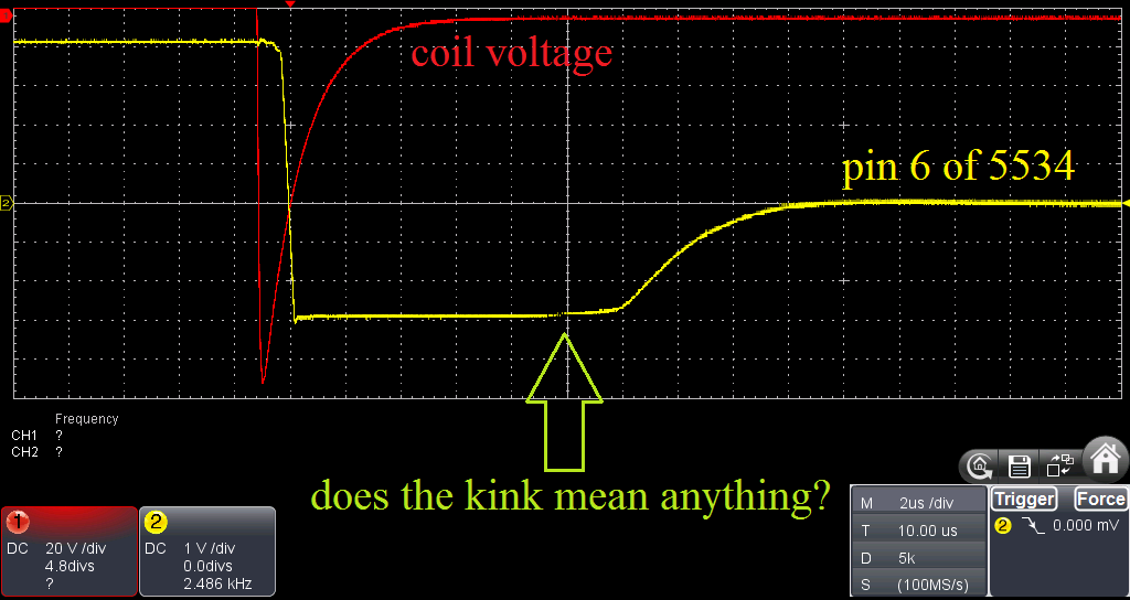

Finally had the guts to measure coil voltage & decay with oscilloscope on my Surf PI ...
  • Finally had the guts to measure coil voltage & decay with oscilloscope on my Surf PI ...
    No magic smoke coming out anywhere, my oscilloscope is still alive
    BUT, the more I use my oscilloscope, the more questions I have
    Like, does the kink in the 5534 opamp curve here mean anything or show something particular?
    Oh yes, I am sometimes regretting having bought an oscilloscope for this,
    because I can find and see so much N..O.I..S..E now and also strangely enjoying it.
    The kink is from the diode clamp recovery. Probe the diodes and you will see it clearly.
      Thanks Carl, will do that.
