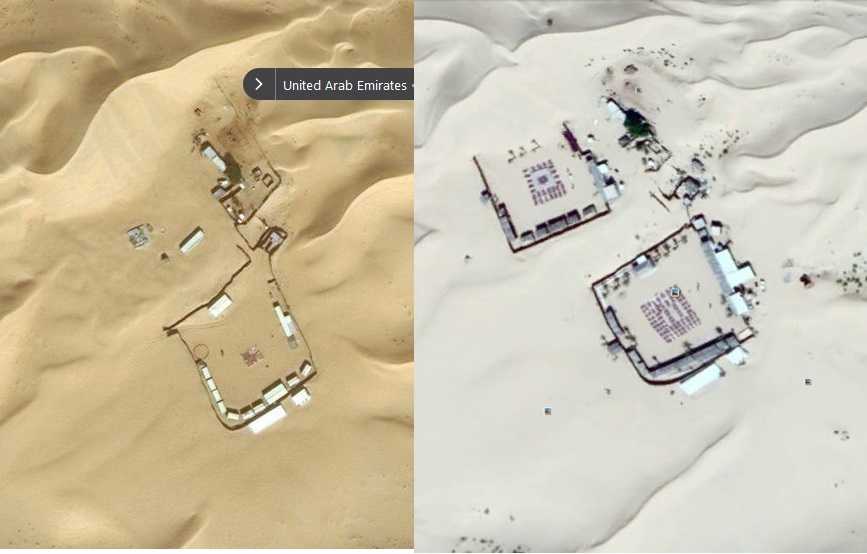

                  Wow, that sounds promising. The issue here is as the area where i'm usually working is only around 40 km from the sea and with dominant south or north winds. Unlike the snow, sand changes the shape really often and the stuff may get burried deep. So it is challenging condition. However for the purpose i need it(to check the same day when lost or maximum few days after) there is a chance to keep my guest happy. In the case with my phone(blackberry) there is a service to track it untill the battery is live. That helps me to reduce the search area. But... the blackberry protect uses a Bing map which was verry old compared to the current situation and that was challenging as well. Plus the accuracy of the GPS they give is +_ 6 to 9metres. have a look at the printscreens of the same map by google earth and bing. Find the differencies:-))) I hope this all explanation is usefull for someone who get in the same situation like me.
                  See thils below:

                    So as you suggest, due to the mixed metals used in the phone device the best setting was all metal. The phone was just around 15cm in the sand and the bounty hunter get it on both medium setting and most sensitive one. It was detected also as alluminium but later when i change the setting. Generally the device i use is not very good at discriminating.
                    When i mention the difference in the maps of Bing and Google earth i face one more issue. The coordinate system is different, so you cannot get the one from Bing and put them straith to Google earth. If you do so you will land at totally different place. I did not find fix for this issue despite trying to google import/export Bing to Google earth coordinates so finally i have to rely on my personal judgement. Luckily i drive in the same area on daily basis for the last 5 years or so and was more or less aware of the changes.
