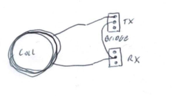

Built minpulse beach rev e followed the instructions exactly and all was well until i connected the coil (mono style 3 and 1 5 bridge) fine till i put the bridge in but now r10 gets very hot really fast and drains the battery if i take out the bridge its fine again but no detection. Circuit makes all the right noises but cant seem to get a step 3 waveform now either, does anyone have a clue what might be going on ? I have built many electronics kits over the years but this has me beat?

R10 (3R3 - 2W) is in series with the Coil. If this is ok without the jumper on the connector (bridge) then you have a SHORT on the RX side.
Re-check the soldering and connections and part values. Ensure you have the bridge on the correct pins and connector soldered to the correct pads on the PCB WITHOUT any solder shorts.
The RX side is a 1k Ohm series resistor and will limit current so something here is definitely wrong. As Qiaozhi suggests and commonly it is something very simple so get out your magnifier and Ohmmeter and re-check.
Looking at your drawing, I note that the coil is actually connected to the RX input. In that case, without the bridge, the TX will be running without the coil connected.Originally posted by qute1 View Post[ATTACH]42856[/ATTACH]
Try connecting the coil to the TX input without the bridge. I would bet that R10 will still get very hot, even with the bridge removed. This will point the finger at the TX oscillator.
Are you sure the oscillator is actually running?
