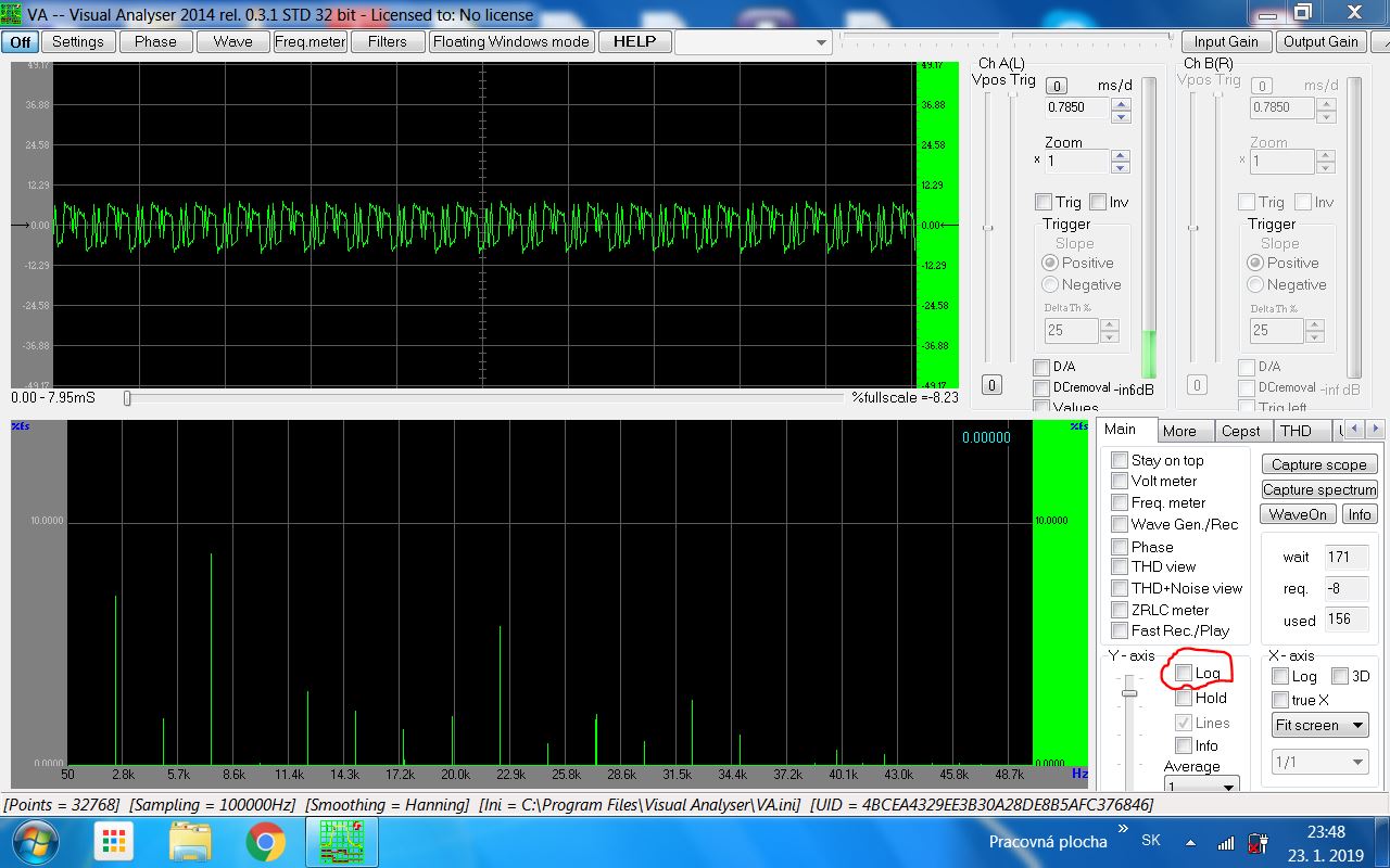

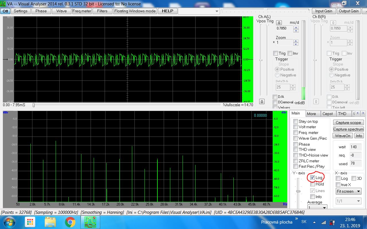

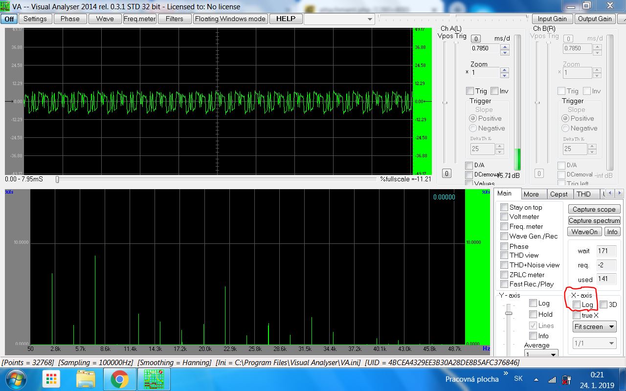

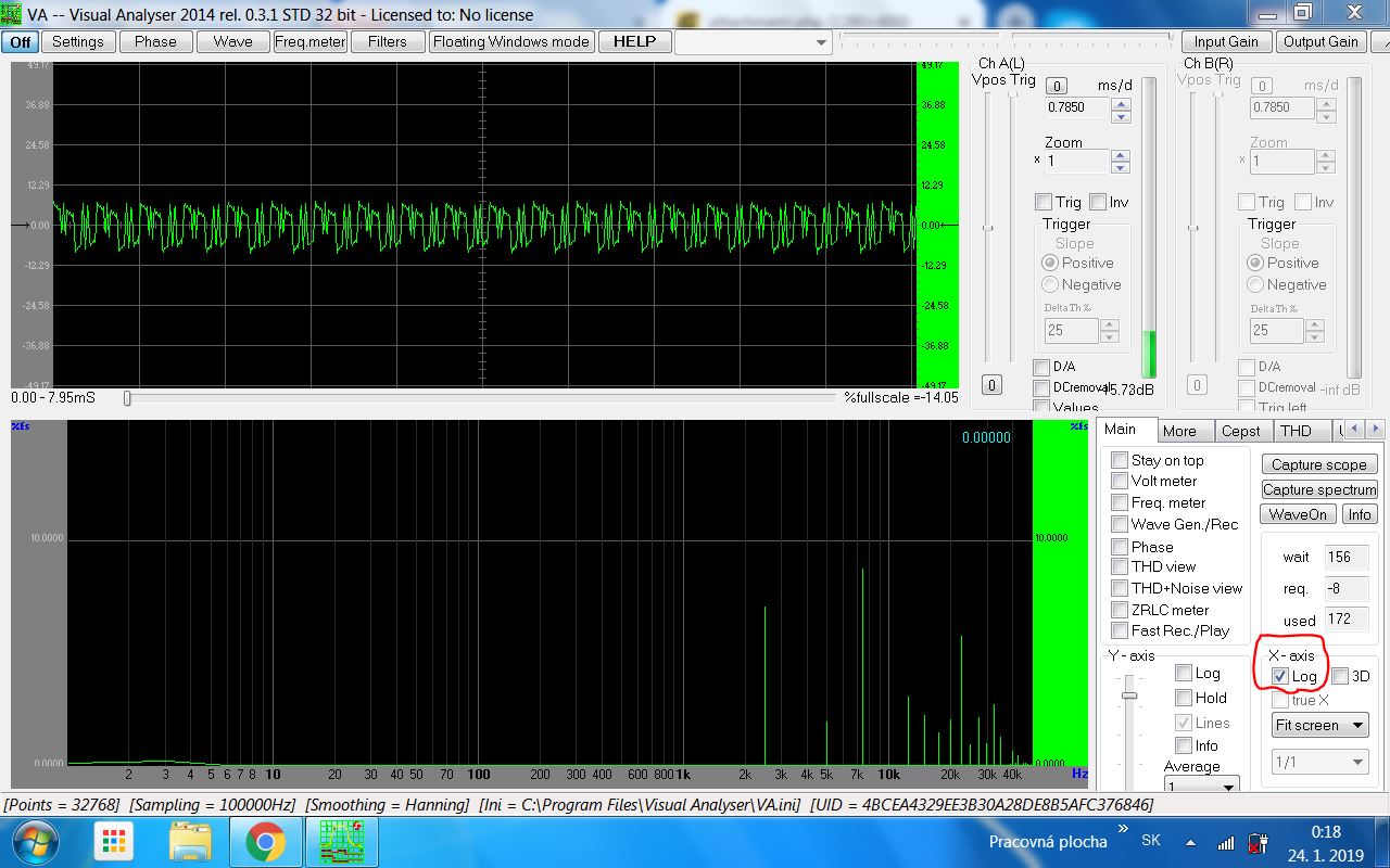

Spectra scans I made a few days earlier ... and on another laptop .., Yes, using the Y axis axis you can move down some weak harmonic frequencies .. but the last 2 scans The V3-normal-and-Bost spectra were made at the same settings ..
Minelab Equinox Challenge
My question, is there a preferred way to chart the data for this application? linear-linear, linear-log, log-linear or log-log. I'm think log-log but just a guess.Originally posted by EL NINO View PostSpectra scans I made a few days earlier ... and on another laptop .., Yes, using the Y axis axis you can move down some weak harmonic frequencies .. but the last 2 scans The V3-normal-and-Bost spectra were made at the same settings ..

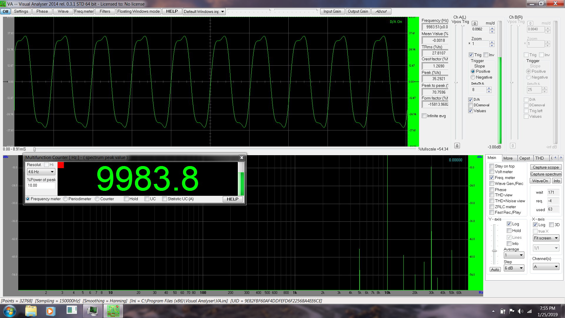

F Pulse frequency

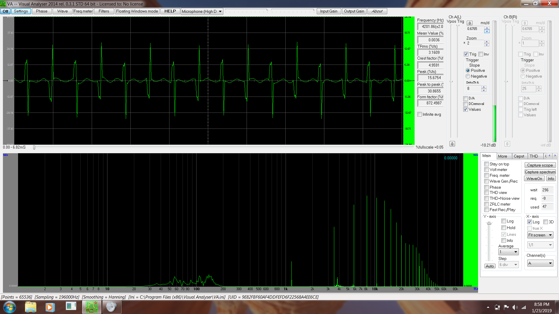

How close to correct is this frequency capture of the Fisher F Pulse pin pointer?Attached Files

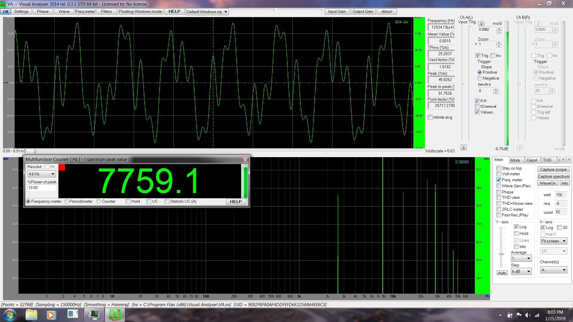

Park 1 Multi frequency

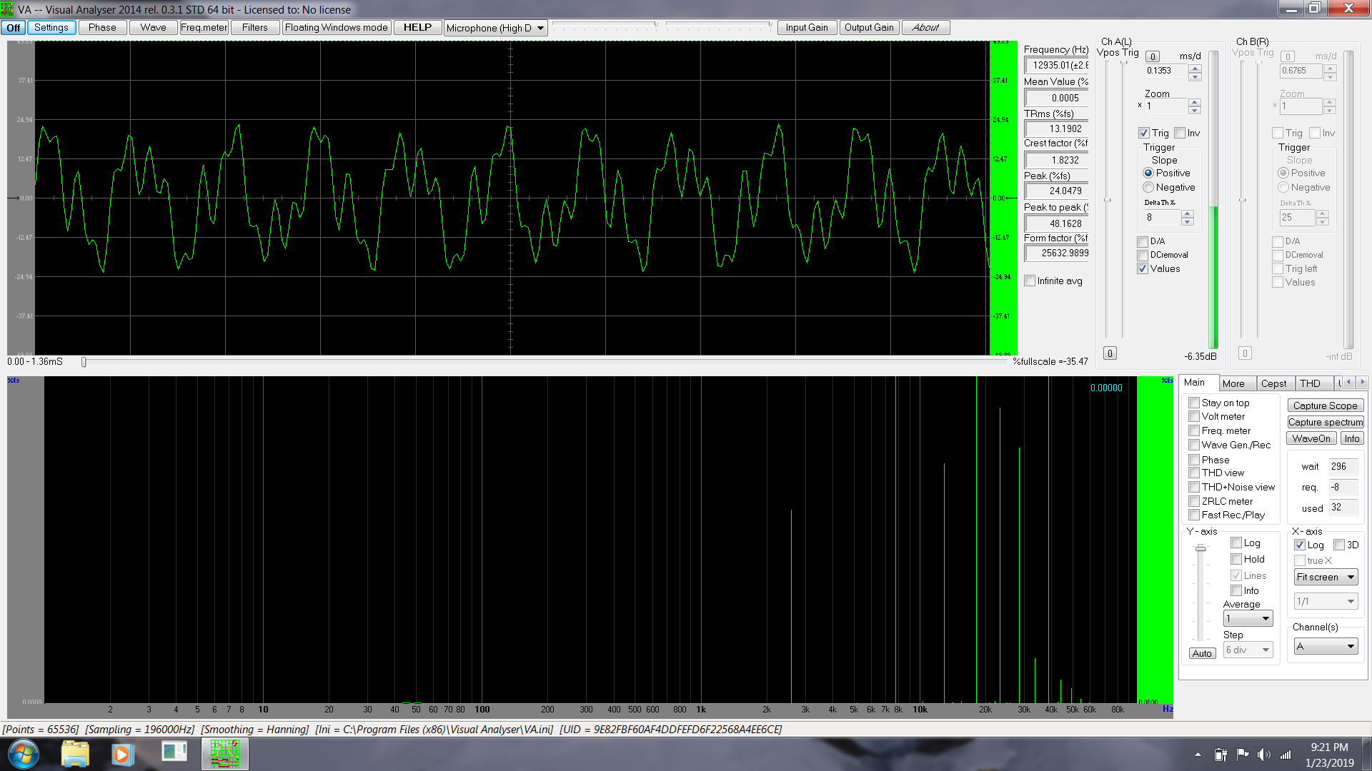

This is my scope capture of Park 1 multi.
Does this not plainly show multi frequencies being captured with the main frequency by 12kHz?
Or is that an average frequency?Attached Files

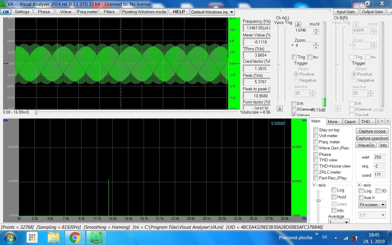

Markg should be the so-called TX multi. frequency repetition ... -but I'll get other values -22.5 kHz for Beach programs and 26kHz for other programs ...- I'm not sure about this, because the results are very dependent on the FFT setting, you set the FFT to 64,000, and I use 32,000 FFT in my measurements ... the highter value FFT-64000 - limits the range of the received frequency On the spectral analyzer to max 35khz ... what is a little...For example, the minelabs FBS has a recurrence frequency of around 14kHz...

By simply Eye-Balling the Time domain capture (scope) I can see at least two Frequencies.There are the larger amplitude wave forms with 10.5 displayed in 1.36 ms which calculates to about 7.7kH.Originally posted by markg View PostThis is my scope capture of Park 1 multi.
Then I count about 5 shorter period, lower amplitude wave forms riding along. So 7.7kHz time 5 is 38.6Hz.
The Spectral display confirms this.
There are also many Harmonics and mixing produces which also show in the spectral display. These may be REAL or can be Artifacts of digital sampling.
Since the time domain display does not show SMOOTH curves but is Jagged that shows the Sampling Rate could be much faster.
The Harmonics in the spectral display seem to be about 48kHz apart which would match the Sampling Rate/4.
Valid point. It appears the graph at the bottom indicate the true frequency. I checked my F75 and it also indicated the correct frequency.
I got very accurate results when checking the single frequency choices on the Equinox too.
It's fun to say the least.
Yes, those captures are good enough to ID the Main Frequencies. It is just all the harmonics that are suspect.Originally posted by markg View PostValid point. It appears the graph at the bottom indicate the true frequency. I checked my F75 and it also indicated the correct frequency.

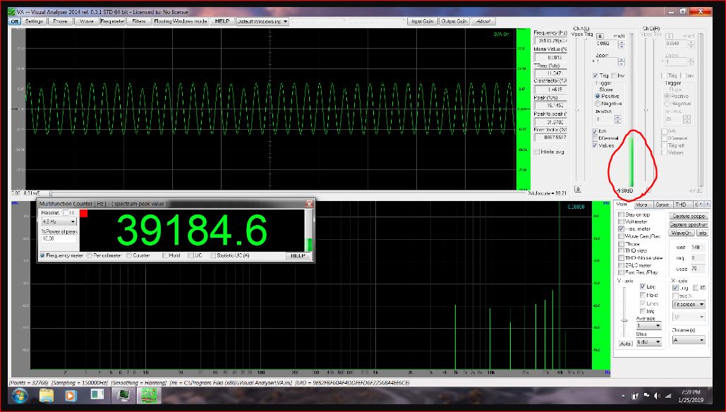

Sample Rate
Increased my sample rate close to double. It has made a huge difference. Comments welcome.

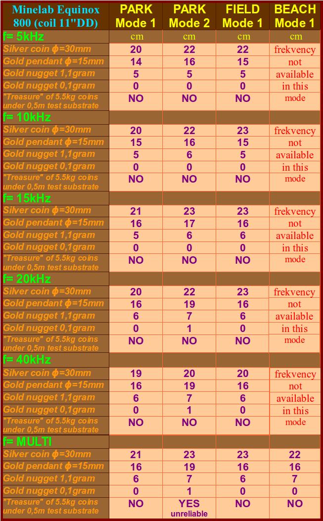

MarkG, for example, took your measurements at Park1 at -40khz is significantly lower than at Park1 -20kHz,..MarkG, for example, was interested in your measurements from Park1 aperture -40khz is considerably lower than at Park1 -20kHz, when I watched the equinox 800 tests done by colleague WM6-test on the mineralized substrate -Liapor -tam the 40khz sequence showed as much strong .. small things as compared to multifrequencies..To compare the Equinox 800 test - the 11 DD in the mineralized - from WM6 colleague, it is definitely an interesting comparison ...:
Interesting, I'll check something else.Originally posted by EL NINO View PostMarkG, for example, took your measurements at Park1 at -40khz is significantly lower than at Park1 -20kHz,[ATTACH]45172[/ATTACH] ..MarkG, for example, was interested in your measurements from Park1 aperture -40khz is considerably lower than at Park1 -20kHz, when I watched the equinox 800 tests done by colleague WM6-test on the mineralized substrate -Liapor -tam the 40khz sequence showed as much strong .. small things as compared to multifrequencies..To compare the Equinox 800 test - the 11 DD in the mineralized - from WM6 colleague, it is definitely an interesting comparison ...:[ATTACH]45173[/ATTACH]
