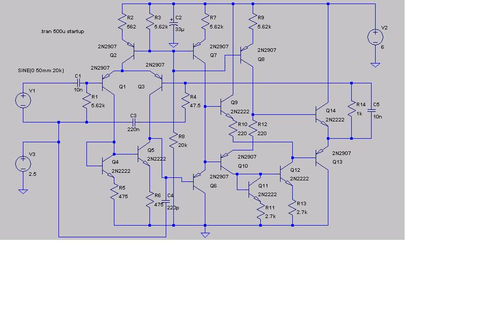

    I am trying for first time to do LTSpice simulation of Rx preamp of gold bug circuit. I cannot seem to get it to work properly. Assuming the original circuit is correctly drawn. Am I doing something wrong? Maybe I will try to do CZ5 Rx preamp just to see. Here is the file.
    I think the "original" circuit is a pile of errors. It resembles the internals of a classic opamp, but for example the current mirror does not function at all (Q4 Q5 in your file) its output should be q5's collector not its emitter. And the rest is the same, i cannot imagine how the vas or the buffer stage would work...
      Well ok then. Doesn't matter. I'm fed up with it anyways. I'll try modelling cz5 preamp. Yes I noticed that on Q5. What I wanted to know was if I'm running the simulation right with respect to the input signal.

        I would suggest starting with a signal driving an op amp. When that makes sense replace the op amp with your transistor circuit. Fewer places to make an error.
          Thanks. I knew there were several errors in gold bug preamp circuit drawn by W.L which I was trying to sort out, I simulated the CZ6 preamp circuit which works, so I wanted to get the gold bug circuitry sorted out. I am new to spice so just learning all the tricks and techniques of software. There are plenty tutorials on how to use LTspice so I be doing a lot of reading to get up to speed where I can run basic stuff without too many problems.

            SUCCESS! I have found and corrected the mistakes on W.L schematic for gold bug for Rx preamp circuit. The Rx preamp circuit now works beautifully as it supposed to. Here is the Ltspice file with the corrected preamp circuit.
