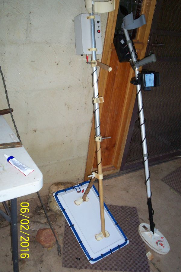

                      My crazy-tech xr71 is in a plastic box, no shielding and no problems whatsoever. I made the coil from a 48x30 square plastic tray with 3 rounds cat5 cable, end joined,(tapped at 22 turns) with last 2 rounds open-ended. With proper adjustment it absolutely hammers an Oz 20c piece at 40 cm and an aluminium can at 1.2m. I used 3x secondhand 18650 batteries, but will change it to 6 new ones, as now the red LED(low bat) is on constantly.

                        I'm sorry Tim, but that thing with the square coil has to be the ugliest homemade I've ever seen. The one next to it looks good.
