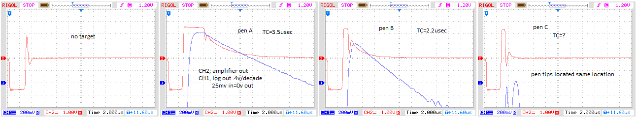

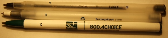

    Don't have a pen with Bic on it but some similar to a Bic pen. I'll try to find a Bic, don't know if all Bic pens would be the same. Pen A was the first I tried, about the same as a 4 grain nugget I have. Looked like an easy target until I tried pen C.
    Tried pen C again, .65us TC. Don't know if it would detect less than a 1/2grain nugget?

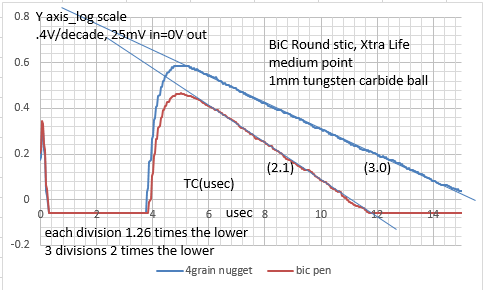

      Searched Bic pens, found BiC Round Stic medium has a 1mm tungsten ball. Did a test with one. Don't know if it's the same as the one Steve used, lot easier to detect than pen C. Not much harder to detect than a 4grain nugget, should be a lot easier than a 1/2grain nugget.
        Purchased the BiC Round Stic medium at Dollar General 10 for a dollar. Probably is a good test target. Interested in what anyone gets for detection distance if they try the BiC Round Stic medium with their detector.
