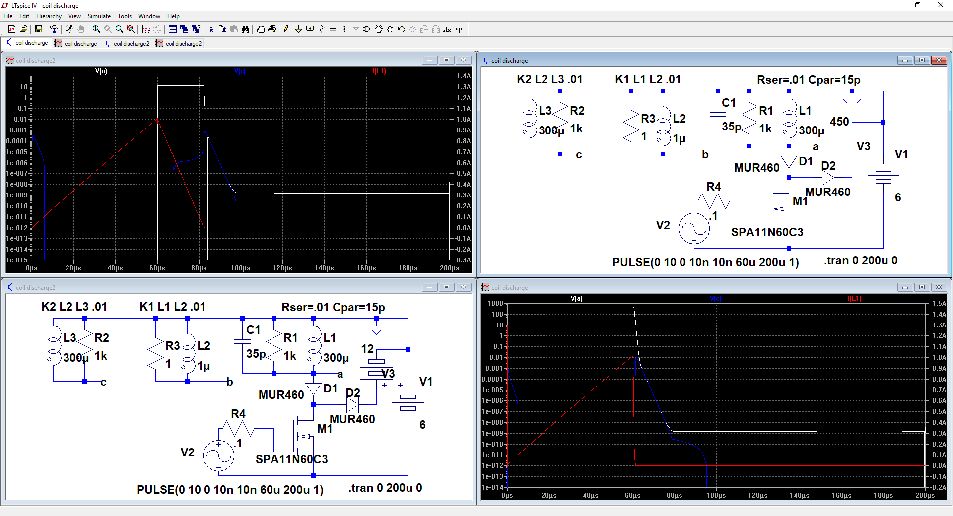

      I've been trying a spice simulation to compare different discharge times. Change V3 volts to change discharge time. Change R3 to adjust target TC. Maybe there is a better simulation? Maybe zero time could be when coil volts is 1/2 supply volts. With short TC targets the sooner you sample the better, but like KingJL posted Tx off doesn't define zero time.
        If I remember the simulations the big difference in the Vallon (and doesn't the old Impulse do this) is the TX pulse 'falling' edge is much slower verse the sharp falling edge of the MPP (and other PI's).

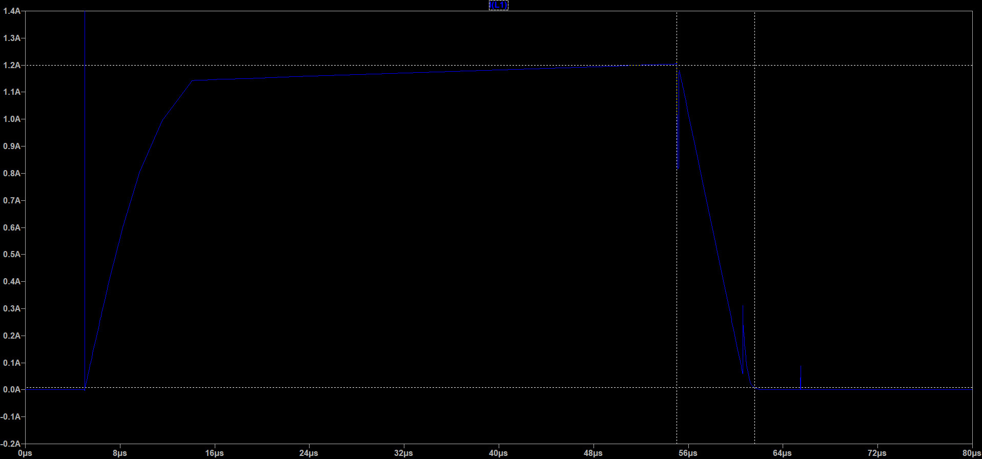

        Remember, we are dealing with coil current, not TX pulse (although the TX pulse starts everything off)! The Vallon coil current falls off fairly linearly over a period of 5.5 usec - 6 usec. The impulse coil current falls off fairly linearly over a period of ~52 usec.
        Vallon Coil Current:
        Fisher Impulse Coil Current:

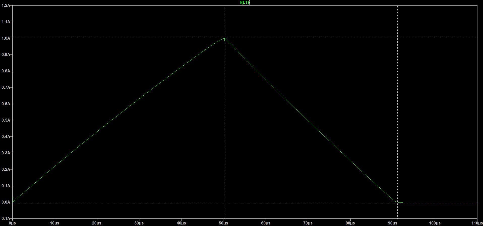

          Playing around with a half sine current waveform, it would appear that the peak target voltage is moved out to the outer limit of the coil waveform (closer to the area that can be detected by the pre-amp. What would your analysis that was applied to the Vallon vs the MPP show with the half sine?
            From your analysis, it appears that the vallon coil current drops off sharply within about 6 uS, allowing sampling of low TC targets. But how far is this from the end of tx pulse?

              Qiaozhi,
              I've been thinking about this, and my conclusion is that playing around with the TX wave shape does not provide any benefits with regards to detection of low conductivity targets. The target is maximally stimulated when the TX-off transition is as short as possible. Using slower transition times (or altering the shape of the waveform) only delays the time when eddy currents in the target reach their peak, but that peak will be a lower amplitude than for the short transition, and the associated TX coil current delay is also delayed by the same amount.
