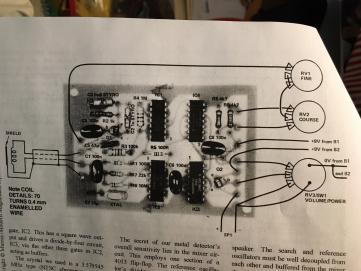

    Would this be a bottom view or top view of the pot’s on the ETI651.
    Back of pot view. How do I know? You could not solder any wire to front of pot, only on back of pot housing(for grounding) as shown. This is good clue as to orientation of pots in diagram.

        I kinda figured the back as well just because if it was the front they would be a small circle in the middle to represent the stem and as you said connecting to the bottom of the base. Also I’m not sure it would make a difference other than the log pot, I not sure but I thing the other 2 would work either way. I would like to know for sure if anybody wants to collaborate.

            Yes, it usually makes a difference. Normally you'd want to turn clockwise to increase, anticlockwise to decrease, generally speaking. So the wiring to the outer lugs are important to get right. I've connected pots the wrong way many, many times, Sometimes I get lucky. I just switch wires around, no problem.

              The clockwise/ anticlockwise is when viewing from front panel
                I should have mentioned, as you stated, the log pots, pin 1 is ground. And it definitely makes a difference getting the wiring correct.
                I noticed the volume pot in your diagram, pin 1 is connected to ground, so I'm guessing it's a log pot. The other two pots most likely are linear pots? I guess the components list would specify.

                      I’m going to go ahead and assume (which I don’t like to do because it makes a a!! Of u & me) that it is the bottom view just because they don’t show the stem and as you said term 1 to ground on the log pot. Thanks for the help. Rob.
