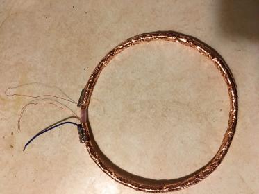

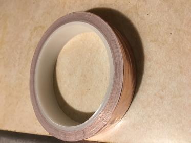

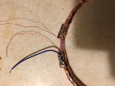

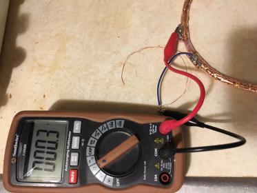

    Has anybody tried this copper tape from amazon for shielding a coil. It can be easily solder on and it says that even the adhesive is conductive which I have proven be wrapping 2 1 inch pieces at each end and soldering them down. As you can see in the pics only getting .3 ohms resistance through it. I hope the adhesive is conductive because I ripped the tape in half once while I was wrapping it around the coil but right now it seems to work fine. Any thoughts?
    Well, if you are getting continuity between both ends, it means that it's having connection all the way around. And that's what you want. And you left the gap. About the resistance, I can't say.

              I must say I was pretty amazed how this stuff works, easy to solder to and the fact that the adhesive is conductive so if it breaks you can carry on and still have a complete circuit . How long will the adhesive keep conductivnees is the question. And it says its resistant to corrosion but for how long. Time will tell. Let me know how it works for you as well.

                      Tibuck19- so for my test have came out more that I expected, compared to aluminum foil. I have ran some simple test with it and it seems to work great although I haven’t actually tested it the field yet. But what I have seen so for compared to using aluminum foil is a major difference. I will let you know more after I do more test at a later date. Please if you try it let me know your findings as well. Thanks, Rob
                        The way that tape looks to me is the same you use to solder the dense Smd on mobiles, tablets laptops etc and there it stops the heat. Am I right or this is different copper tape? Also don't you afraid at lower delays it will be detected as target? Think the best way is to build two twin coils one shielded one not and see how it will be. Whether the shielding will or not decrease dramatically the dept. Off cause all I say depends what are you going to search for, so accordingly it may do or not do the job in your particular case. I'm sure though I've read somewhere in the forum that copper tape it is not suitable, only not sure which type exactly.
                          I use the copper tape all the time, works great. The 1/2" wide tape is easier to wrap around. I cut the tape to about 20" lengths and overlap the ends. Just make sure you burnish down the tape after its applied to make sure you get full contact.
                          You must make sure you buy the copper tape with "conductive adhesive". Usually will have a green core. There are many copper foil tapes that do not have conductive adhesive with a white core--depends upon the seller.
