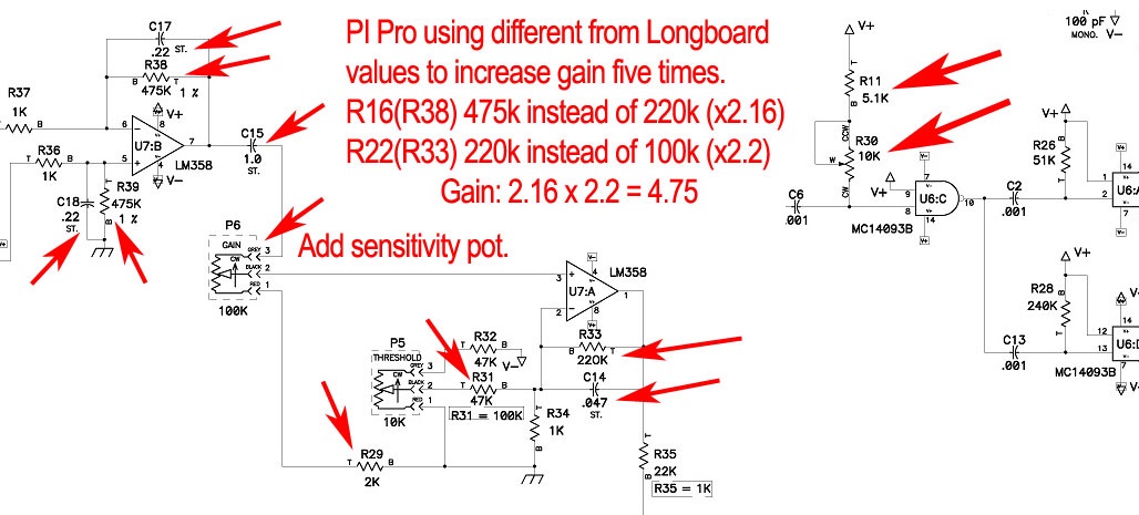

        I've done the surf PI to PI Pro conversion, but cause i have no 1uF for C7 avaiable i keep the old value of 470n cap. Is it critical (especially as the gain increases) or i can carry on like this, or may be two 470nF parralel aregood idea?
        Thanks.
          2x 470nF parlel =960nF- try it
            that should work tolerance on polyester caps would put it in that range any how.
              Mhm, thanks will try that and post a short movie to show you am I on the proper track. I have that feeling interference is way too big and response not exactly as it should be.
                Do you have details of the surfpi to pro conversion? i have a couple of surfpi also that i am thinking of putting basic VCO on but may upgrade at the same time!
                  Yeah, i dig the forum nicely as this topic was interesting to me. It is something everyone talk about but the info is spread all over the forum. I can post here, however if you need i can also send to you to save you from few days searching. The main problem is i have no osciloscope and simple replacing of the components may work or may not. One for sure need to adjust after. For example,somewhere i've seing 470nf replaced with 220 as on the schematic. Somewhere they are replaced with 330nf. Which one is suitable in my case i cant say only by experiments.

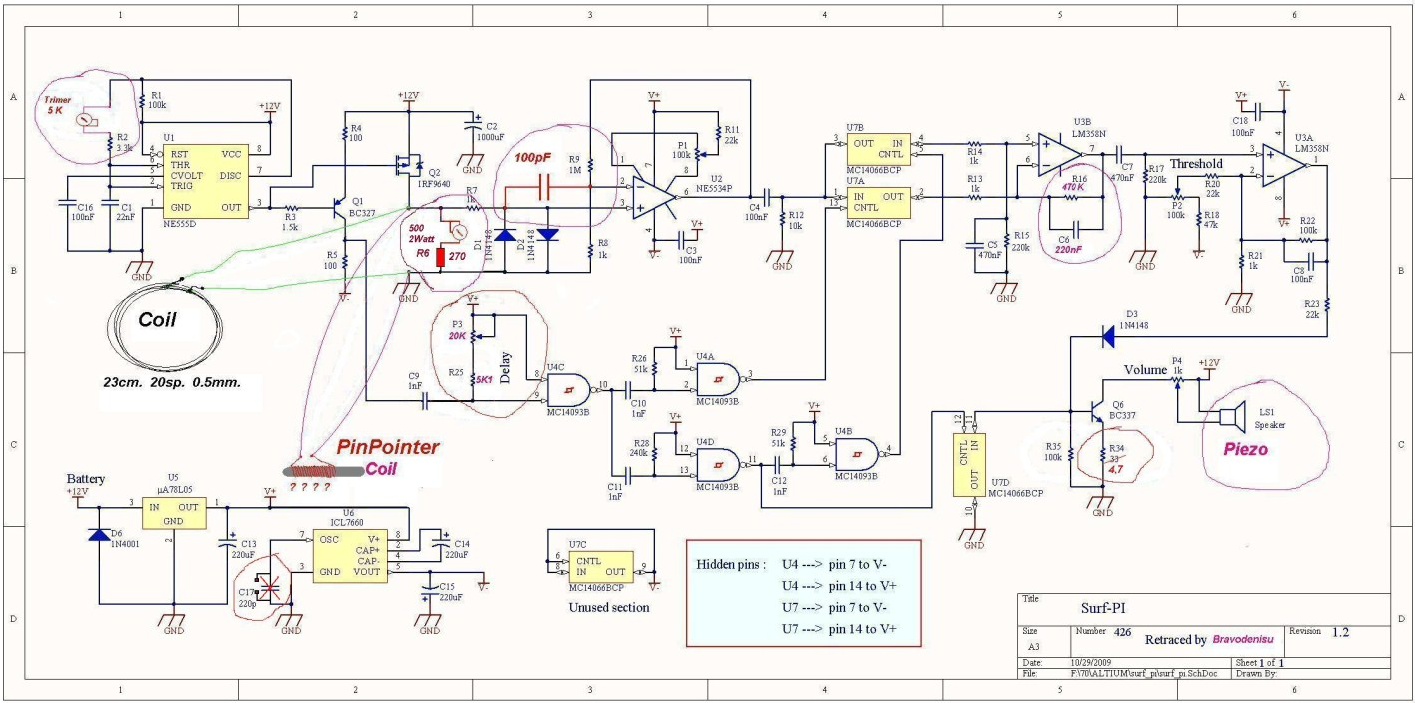

                      Surf PI to Surf PI PRO mods
                      Here are all the files i have in regards to the Surf PI to PI Pro modifications.
ID:	351869 Click image for larger version
                      All credits for the above files go to Tepco , Quiazoschi, dbanner and Dennis. Esquse me if i miss someone.
