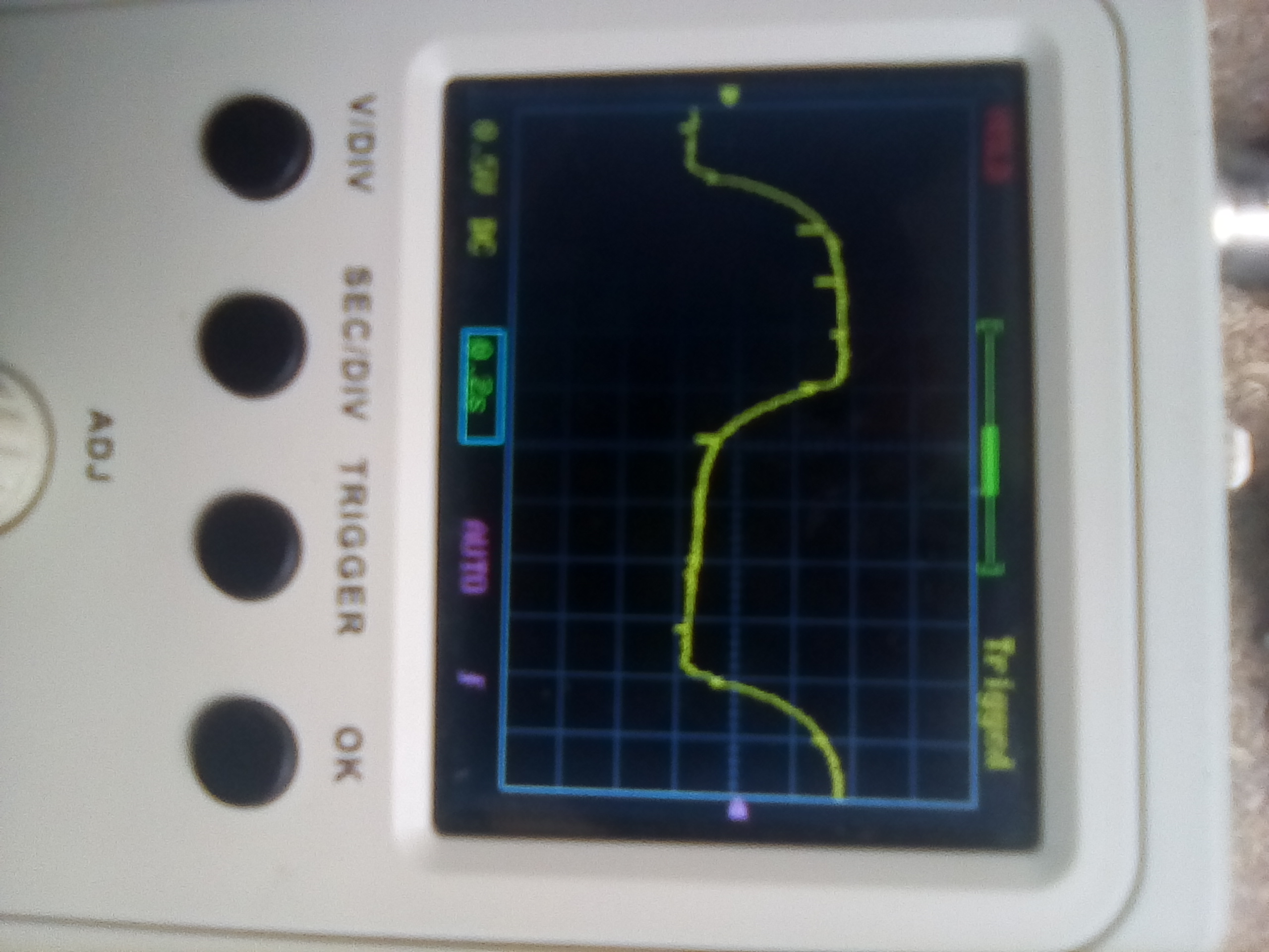

    Hi everyone,
    during my last session, i got trouble with surf PI.
    When i got the coil plugged, i can hear the speaker at a frequency around 1Hz.
    When i unplug the coil everything is fine.
    i've checked the signals, the parasitic signals seems to come from -5v: it looks like a step function (maybe a capacitor making an oscillation on -5v).
    I've tried another coil -> same problem
    Replaced pre-amp -> same problem
    Replaced 4093 -> same problem
    555 doesn't have any parasitic signal on output
    Replaced MOSFET -> same problem
    I'm still working on it
    Any ideas ?
    Thanks in advance
    Here is a picture of the output of integrator 0.5V/div 0.2S/div

      What about picture of the -5V? Isn't that the problem (based on the thread title)?
      Look at output of -5V reg (U6 pin 5 the ICL7660) and on the -5V input pin of the op-amps.
      If the -5V input opamps is bad you will not fix this be swapping coils or opamps.
      Is the +5V clean?
      Please do try to get pics in better focus.

          Problem solved: it was the LM chip.
          discovered by de-solder the capacitor at the output of integrator (to seperate the audio from the signal processing).
          So if you hear one BEEP per second you know where to search
