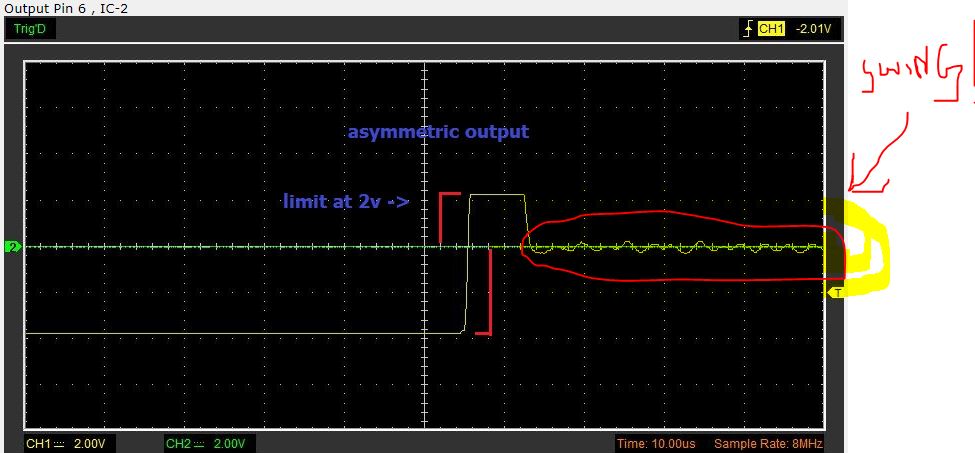

    Hello All,
    i need help, i have output preamp asymmetric swing,
    i use two IC preamp NE5534 non-inverting input.
    Output Pin 6 , IC-1
    Output Pin 6 , IC-2
    at IC2 pin 6 positive swing not same as negative swing, how to solve this problem,
    Thanks,
    Wahyu

        I have been swap IC-2 LME49710, same result, max swing at around 2V, and yes my room it's very noisy,
        Thank for reply
        Regard,
        Wahyu.

                my problem is actually not in noise, but the problem is in maximum swing on positive + rail, which is only around 2V at IC-2 swap LME49710 same result, noise will disappear if I try outside or without coil installed
                Thanks for reply
                Wahyu.

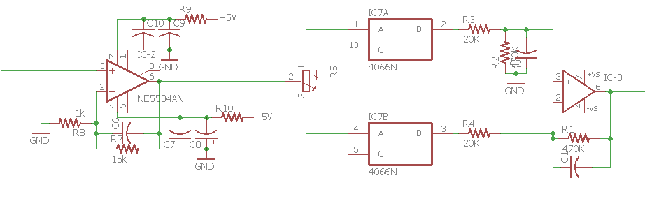

                  Depending on what the second amplifier is driving, a resistor from IC-2 output to +5v might make it symmetrical.
                    Hai Green, second amplifier driving 4066 and integrator, schematic ;
                      I would try a 4k or 5k resistor from output of 5534 to +5v and see what happens.
                        Hello Green,
                        I have tried with 4k7 and or 5k6 resistors to +5V , it still has a maximum swing of about 2 volt,
                        Regard,
                        Wahyu

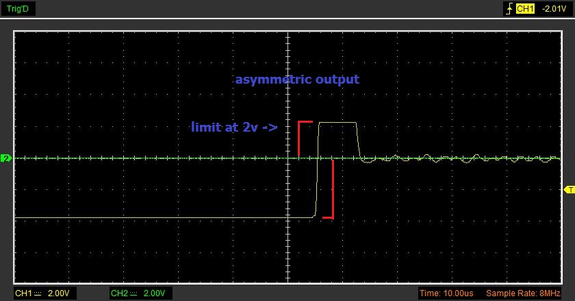

                          Not what I expected. Maybe someone could explain why.
                            ...the texas instruments 5534 data sheet specifies within 2 volts of rail supply typical with 3 volts worst case ... so with +/- 5 volt supply from the data sheet you can expect +/- 3 volts or +/- 2 volts worst case. I have never liked running the '34 off less than +/- 12 volts for this reason ...
                              Elementary opamp basics. Output distortion it is called.
