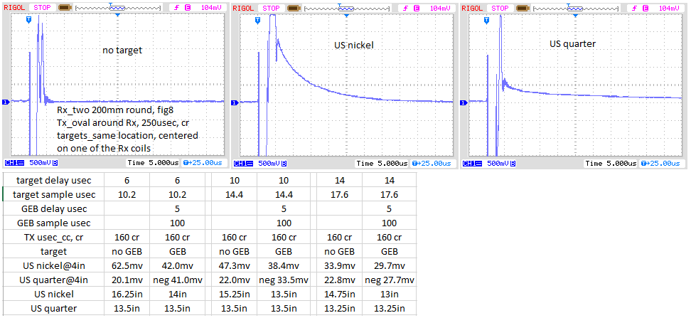

                Many PI designs are more sensitive to low conductors than high conductors; they almost always detect nickels deeper than quarters, even though quarters are bigger. From Carl's reply#8
                Some data for a nickel and quarter. Charted data I did awhile back, scope pictures tonight. Easy to see the nickel is higher amplitude.
                GEB was adjusted to cancel ground when enabled.
                Maybe MTammet scope pictures will explain the difference in detection for his rings.

                  A PI detector design I'm working on at the moment has a better response to quarters than it has to nickels. In this particular case, a nickel has 64.3% the depth of a quarter.
                  The relationship between the depths of these two coins depends on the TX pulse width and the main sample delay. If the detector is optimized for small low conductivity targets, then it tends to be desensitized to high conductivity items, and vice-versa. As usual, it's horses for courses.

                      Pictures reply #37. Signal for nickel higher than quarter before 25usec, lower after. Are you just sampling latter or have you found away to get signal for quarter higher than nickel for early delays?

                            I'm sampling later.
