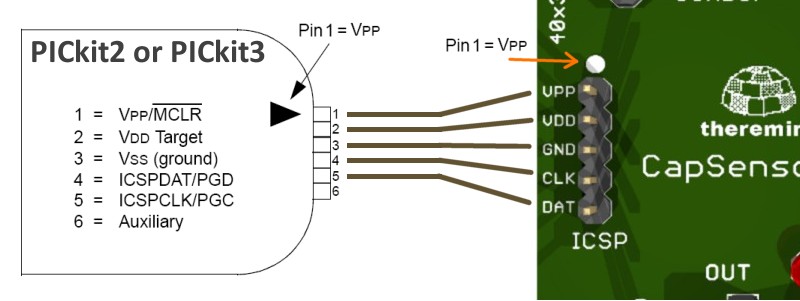

    i have bought a cheap Pickit 3.5 from ebay.
    I want to make a connector to program my PIC16F676.
    I searched for the wiring in google and found this picture which confused me:
    DAT and CLK are inverted.
    Do i need to invert them too?
    I found another picture where the pins were connected like this:
    VPP/MCLR (PICKIT) ---> Pin4
    VDD Target(PiCKIT) ---> Pin1
    VSS Ground(PICKIT) --> Pin 14
    ICSPDAT/PGD(PICKIT)--> Pin 13
    ICSPCLK/PGC (PICKIT)--> Pin 12
    Which one is the right one?
    Thanks in advance!
    The pins 1 to 5 should go to VPP, VDD, VSS, PGD and PGC in that order.
    VPP = programming voltage
    VDD = power rail (e.g. +5V)
    VSS = ground (e.g. 0V)
    PGD = program data pin
    PGC = program control pin
      That diagram shows how to wire up a theremino capacitive sensor board. Do you have such a board?

        Yes correct and this are the pinouts to your target.
        PICkit Target
        1 MCLR --> Pin4
        2 VDD --> Pin1
        3 VSS --> Pin 14
        4 PGD --> Pin 13
        5 PGC --> Pin 12
