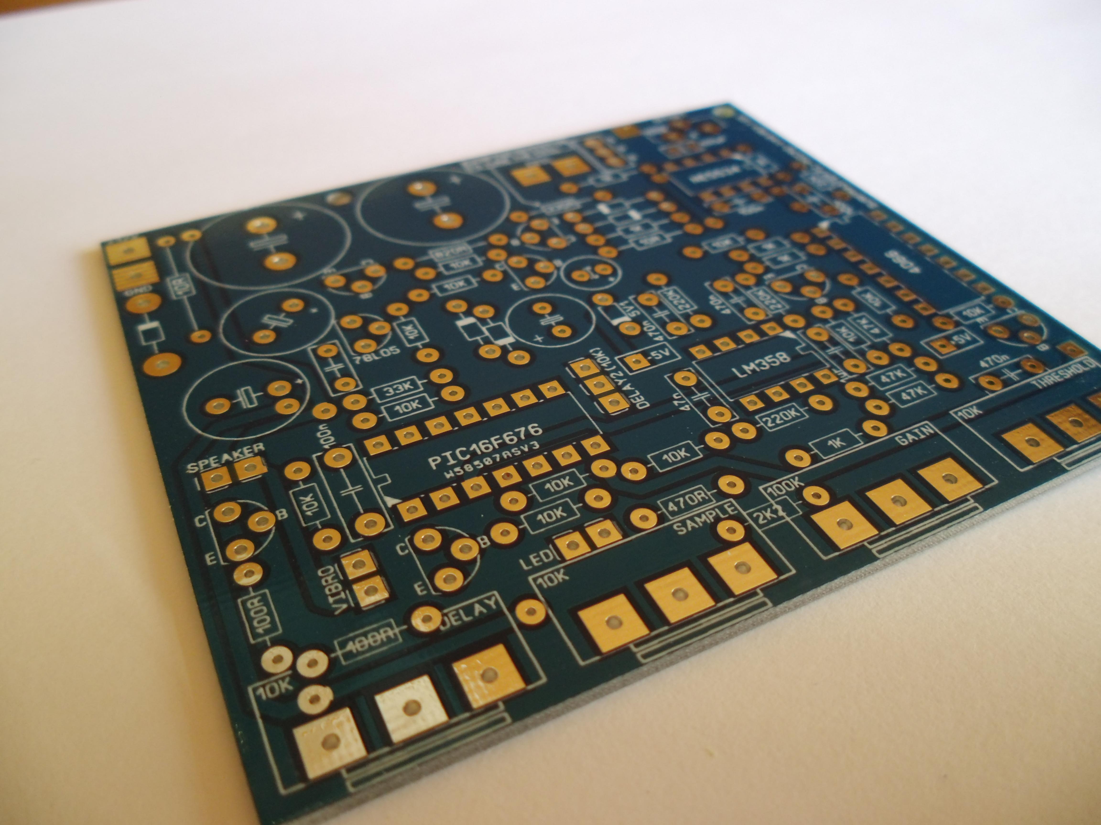

    i have 20 pcbs from this project: https://www.pcbway.com/project/share..._Var_1_00.html
    My Problem is that i dont have a bill of materials. I dont know which Transistors i should use.
    I can find a schematic from the smd version but i need tht parts.
    I can find the majority of the parts at the silkscreen but i need the missing parts.

      Hi andi,
      i already saw this schematic. But the problem is that it uses smd transistors, i need the tht equvalents for it.
        change first '8' on '5' in a trans type and you get equvalent. no secret, everyone knows this rule.
          My proposition :
          BC807 - BC327-16
          BC817- BC337-16
          BC856- BC556A
            Thanks. I never made any smd project.

                          Can i use 1N4148 instead of BAV99?
                          I need to replace this transistors:
                          BC817 --> BC517
                          BC807 --> BC507
                          BC856 --> BC556
                          Can i use 2N2222 and 2N2907 too?
                            Try the transistors, they should go.
                            Pay attention to the pin assignment of the Transistors!
                            Instead of a BAV99 you need 2x 1N4148
                              I think i just have to put normal 1N4148 in the holes at my pcb.
                              Is BAV99 a dual package? D4 and D5 in one BAV99
                              Or do i need to take 8 x 1N4148 Diodes?
