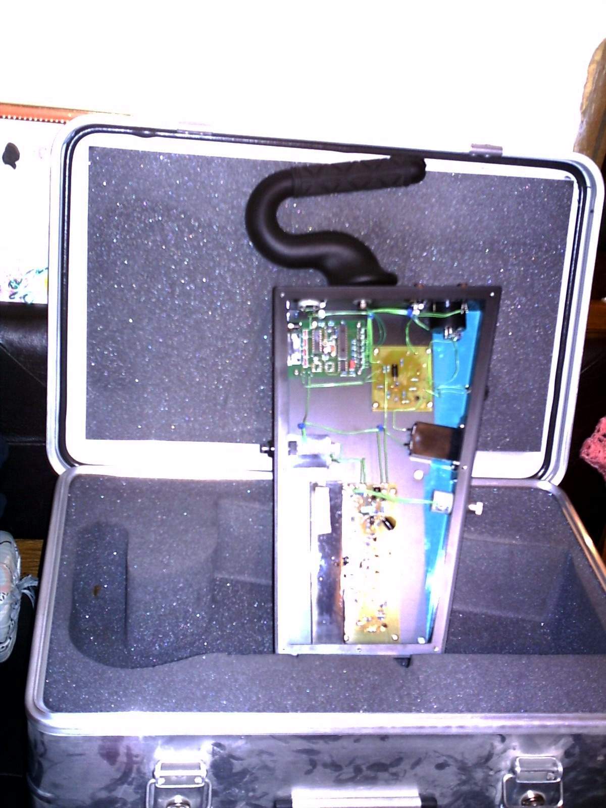

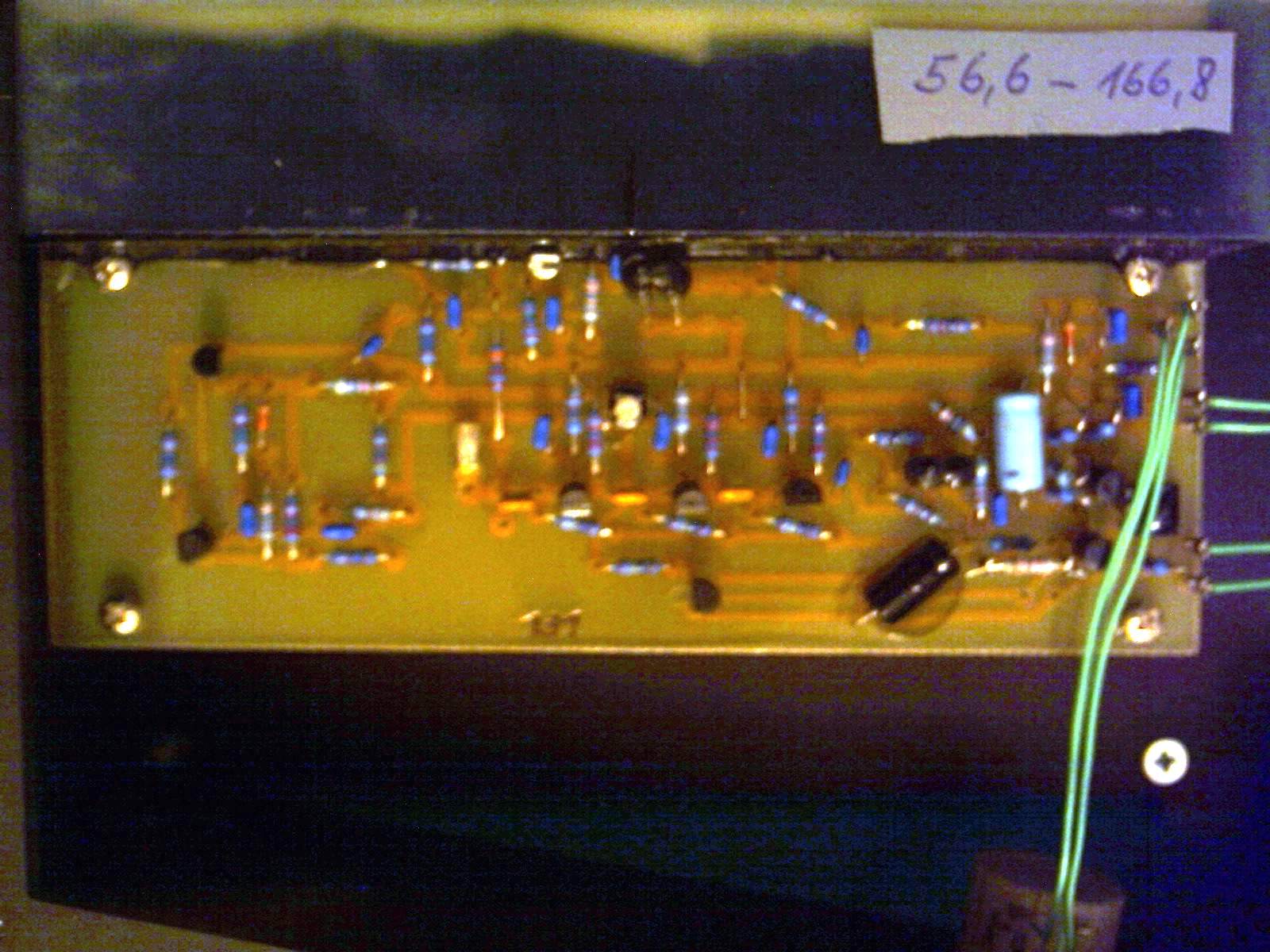

                      As far as i recall; Emfad UG12/24 is working in 56-156kHz range.
                      Look the photos:

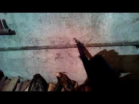

                          At the end of this video you can see the directional behavior of ferrite rod antennas.
                          Rods are just 10cm long.
                          More "directional"-ity will be achieved with longer rods.

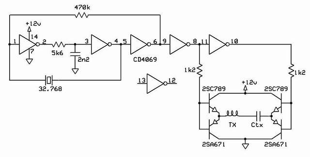

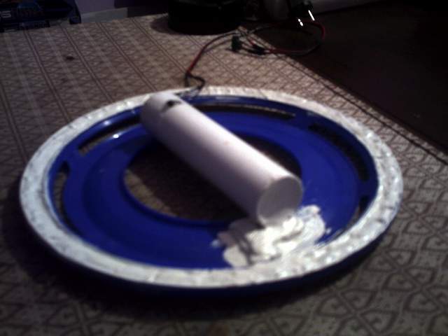

                              Some years ago i made local TX for similar purposes.
                              I had demand on 33kHz working frequency, so i used simple clock crystal and it was easy thing to do.
                              It served as "exciter" to extend and improve Cscope 33XD sensitivity and depth measurements accuracy.
                              The results were far over my most optimistic expectations! It did the splendid job.
                              Now.. at this current subject; only output part from schematic can be used to boost 56-156kHz signal from some adjustable oscillator.
