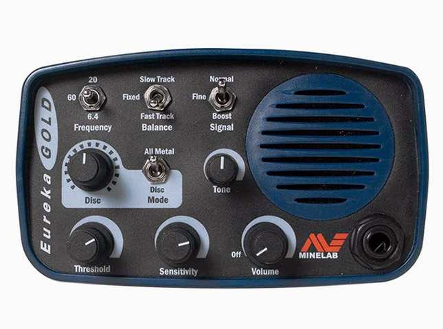

                    this oldie ML eurika gold. has 3 frequencies. enough. 71 freqs is sure clear adwerts way for me.

                      I call the Eureka/XTerra/Deus selectable frequency detectors.
