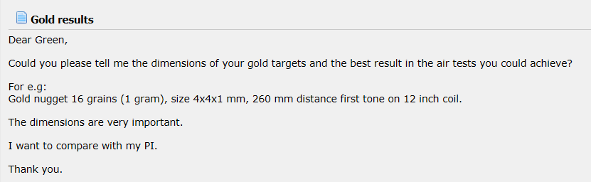

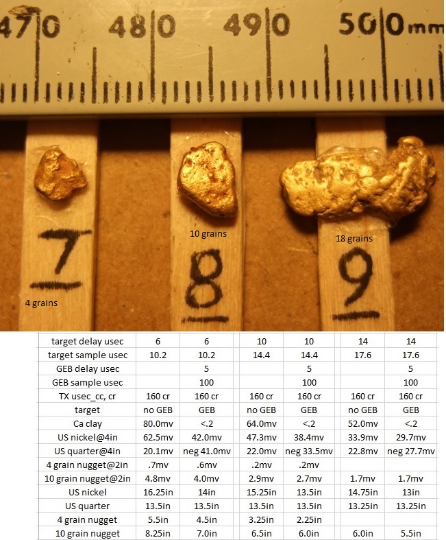

    Haven't visited the forum in awhile. Had a PM when I looked today. Including results from a past test changing delay time and sample time to balance ground signal(GEB on, GEB off). Think test was done with Rx(two 200mm round coils, figure eight)Tx(oval surrounding Rx)1A peak coil current. My detector isn't working so I can't repeat the test right now. Didn't test the 18 grain nugget. Didn't see a better way to answer the PM. I am also interested in how my detector compares. What detection distance should I expect?
    The last time I tested the US nickel the results were a little better, don't know about the other targets.

        A detector I've been working on for a long time now. Thought I had it about as good as I could get it when I read a reply in another forum about detecting a quarter at 24inches with a GPX4500. 13.5inches is a lot less than 24inches. What would I need to do with my detector to detect a quarter at 24inches?

                  I agree with most if not all with what you are saying. I started the thread as an answer to a PM. PM asked about dimensions of my nuggets, other than a picture and weight I didn't know how to describe them. No way to compare nugget detection distance. We need some standard targets. I have some ideas for standard targets, what thread would be a good place for discussion?
                  If I remember right my figure eight coil is close to a mono coil the same size as one of the Rx coils. The figure eight Rx does reduce EMI, better S/N. It also reduces ground signal but I think the detector is unusable in my yard with GEB off. Other than playing with my detector in the yard I've never done any detecting so just novice thoughts.
                  For comparisons with a PI. Thinking of a chart similar to reply#1 for detection distance(add coil size and what else is needed)tester fills in what he can. Integrator out values would be nice. Need some standard targets that most could find.

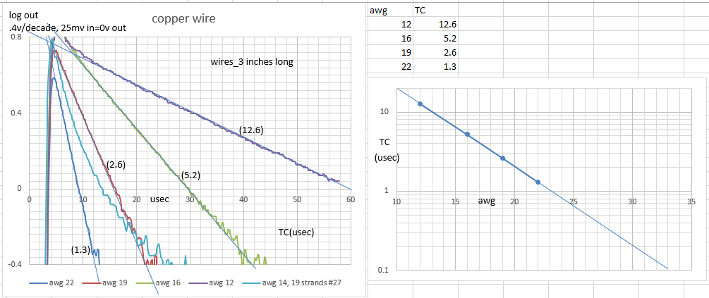

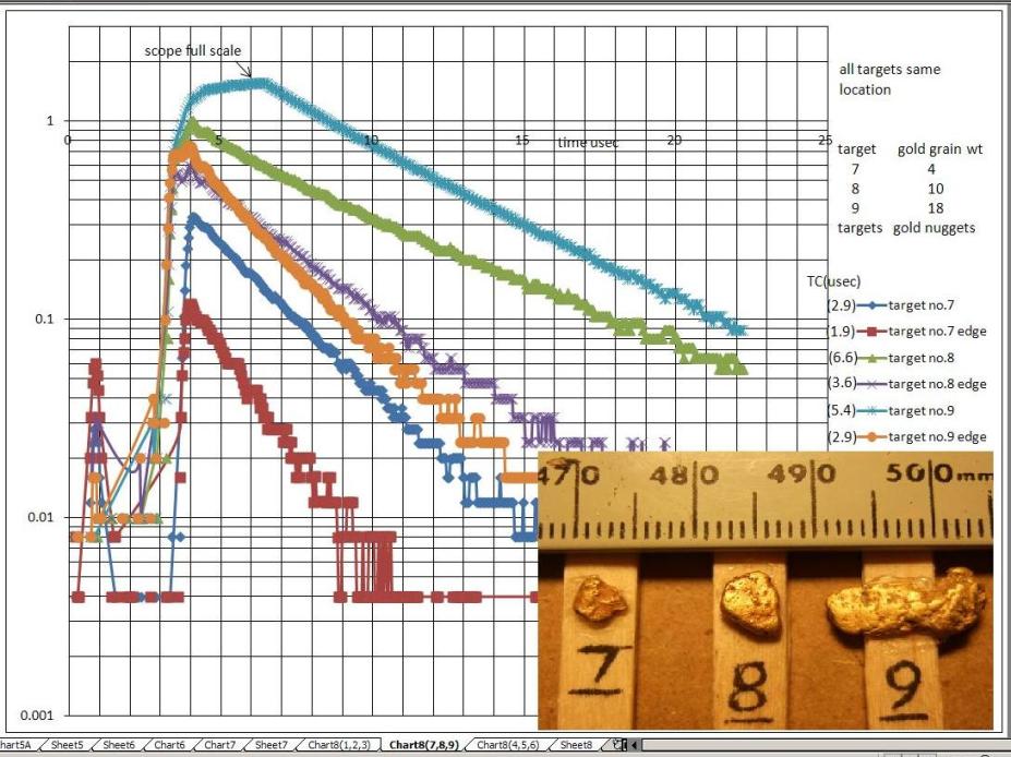

                              Some test data I did awhile back for my nuggets and some solid copper wire. Depending on nugget orientation, TC varied between 1.9 and 6.6usec. Wondering if a piece of solid copper wire AWG22 to AWG14(TC 1+ to 8usec) might make a good standard target. Maybe a piece 10 or 20mm long. Copper wire should be the same anywhere and available. Need to finish my detector to try, maybe someone could do some testing, detection distance.
                              Nuggets on edge have a shorter TC because targets were in center of coil. Depending on orientation, TC could be close or the same as flat centered when over coil edge.
