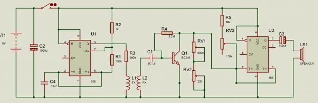

    Sorry to bother you guys. I am preparing the presentation now and I need to figure out the working principle of 'matchless metal locator'. In my opinion, at the normal condition the Rx will receive a small signal and after the amplifierClick image for larger version
ID:	370861 the signal voltage is still less than the 2/3Vcc so the ICB1 part will produce a high voltage. If a metal is near the coils, the received signal becomes larger and the amplified signal is larger than 2/3 Vcc so the chip could produce a square wave signal, am I right? Or the circuit works due to the change of frequency of received signal?

      The first opinion is correct, though I'm not 100% sure about the threshold level. Sounds right, tho.
