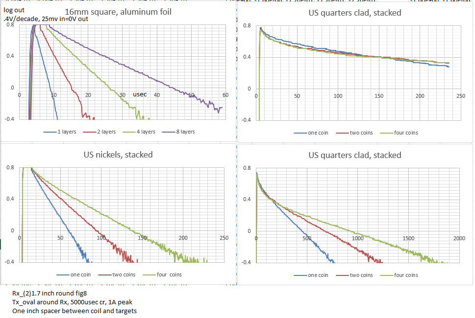

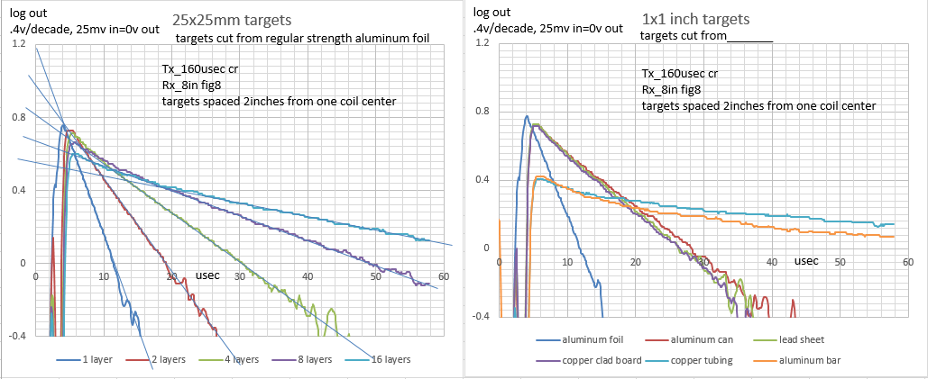

    I've been thinking different:
    Response conductivity is target metal type and target thickness
    Response inductivity is size, width and length mainly width(maybe only width)
    Response strength is due to surface area
    Have read in some of the replies skin effect effects thin targets not thick targets. When I search skin effect, current isn't the same thru out target thickness(higher on the outside). Been thinking if target charts straight line decay linear log chart, target not effected by skin effect. If decay isn't straight line decay, faster decay in the beginning its because of skin effect.
    Including some charts with examples.
    TRT_29: Stacked foil targets chart straight line decay, not effected by skin effect. Slopes not the same so would effect detection depth.
    Quarter and stacked quarters, not straight line decay, effected by skin effect. Chart straight line decay at longer delay times.>2 or three target TC's? Chart close to same at normal sample times so wouldn't effect detection depth.
    TRT_32:second graph, copper clad board and lead sheet chart same(TC=(L/R)). 1oz copper clad board 1.4mils thick, for same resistance lead would need to be 16.7mils(measured 16mils, close enough)
    Probably been discussed in other threads but I couldn't find what I was looking for so I'm starting a thread labeled skin effect. Maybe I'm thinking wrong or it's a matter of definition.

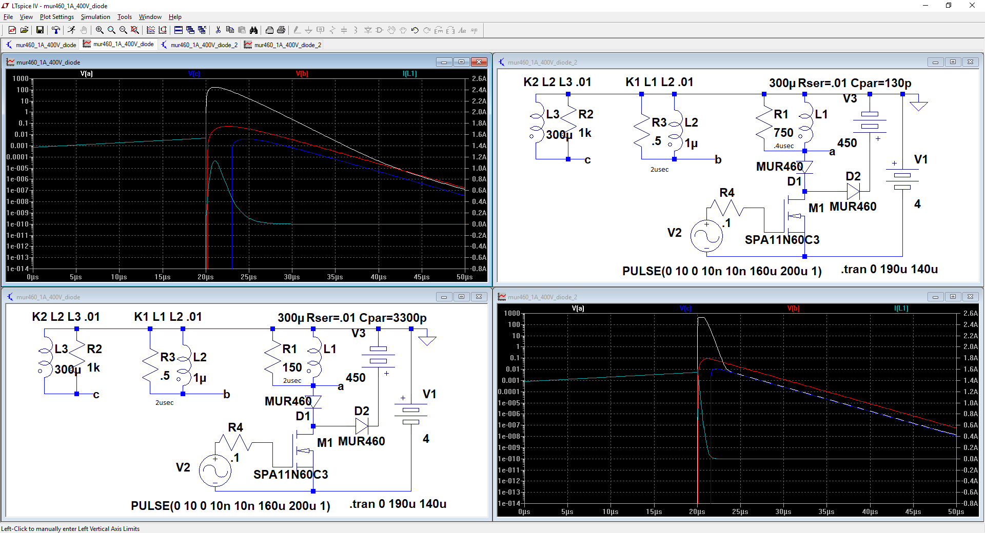

      Trying to understand 5 times faster TC. Tried a simulation in spice. Left side, Tx TC=target TC. Right side, Tx TC=1/5 target TC. The target signal(b) and Rx signal(c) are a little higher after 5usec delay when Tx TC=target TC. Signals are lower when Tx TC is 1/5 of target TC. Tx(a)mono coil maybe not usable when Tx TC=target TC. Maybe doing something wrong?

        Another thing to consider is where on the TX current rise graph, the current is being turned off. If you turn off the current at 3 current rise TCs then the current is on the more horizontal portion of the current rise graph at about 95% and penetrates the target more. However, if you turn off the current at around 1 TC the current rise graph is more vertical and less efficiently stimulates the target due to cancellation of some of the charge current.
            Green,
            The mono coil presents a problem with the discharge TC due to the fact that the op amp input resistor and clamping diodes put the input resistor (typically 1K ohm) in parallel with the damping resistor until the voltage falls below the diode on voltage (typically about 0.6V). Even a 1K ohm damping resistor would look like a 500 ohm resistor while the clamping diodes are conducting. A DD coil would not show this problem and allow some earlier sampling compared to a mono coil.

              Very good point that I had not thought of. Thanks.
              I did find that concentric and DD coils do allow earlier first sample than a mono coil.
