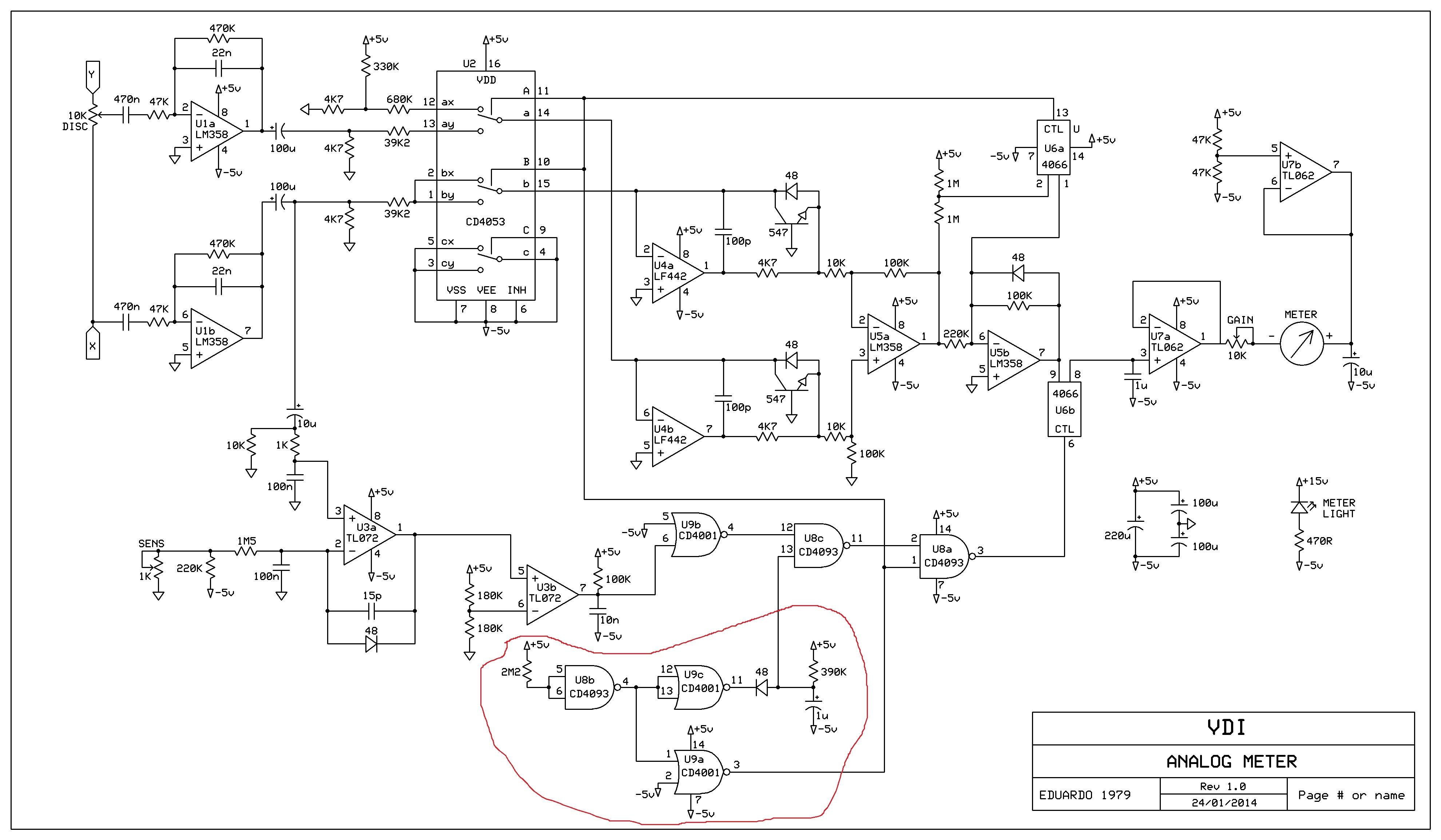

        Originally posted by eduardo1979 View Post
        VDI 5900
        Hi. Here is an analog VDI that works very well. I did it a few years ago. I was inspired by the original VDI of the Whites 5900, and cut parts of some components.
        Hi Eduardo, what function does this part of the schematic perform? I think there is a problem. Greetings.
