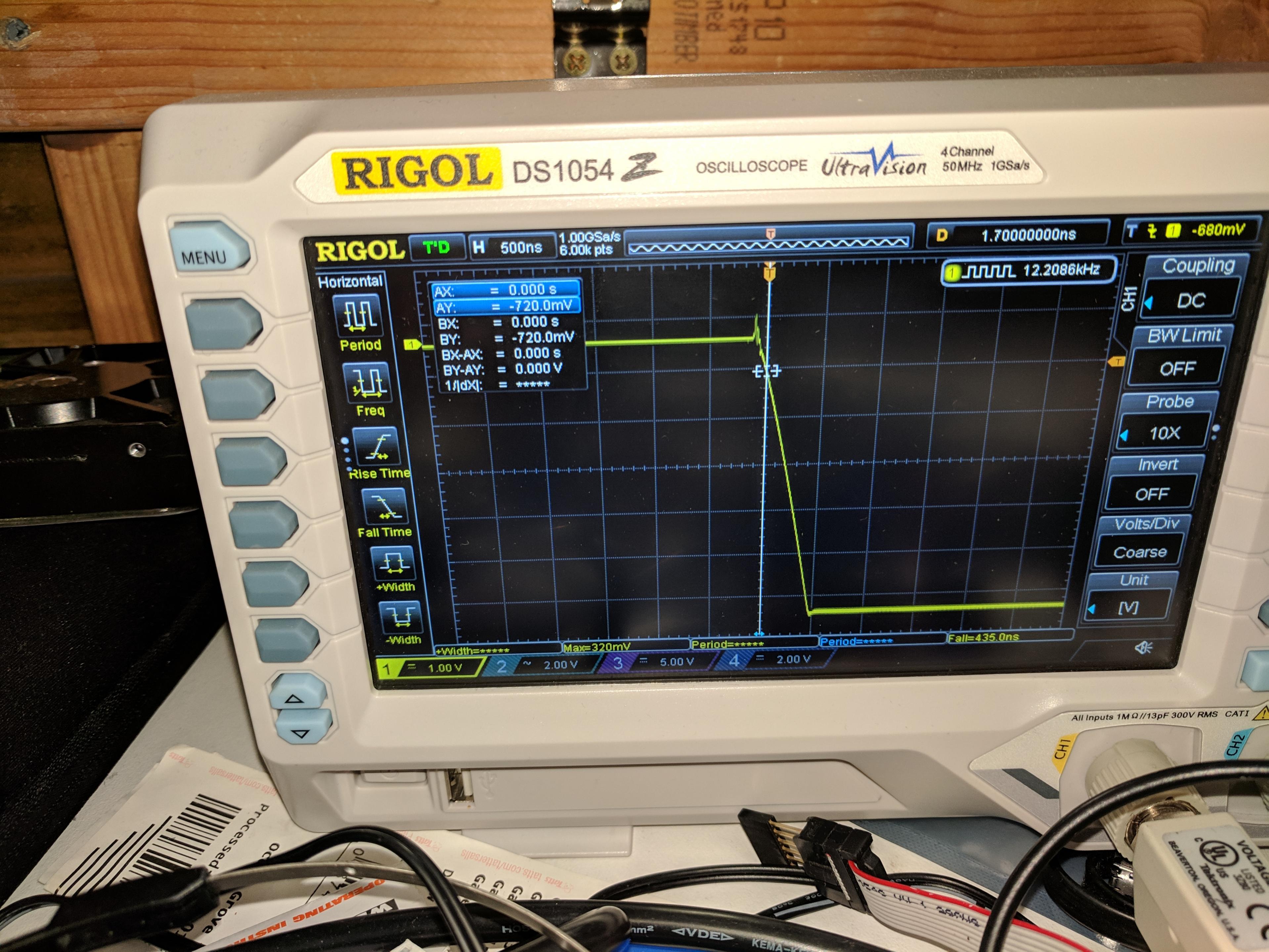

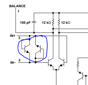

    A nice opamp ... except ... it has diodes across the differential inputs .... these go into conduction in typical PI ccts and cause more trouble than you might think. :-)

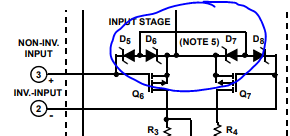

    Even a mouldy old 3130 does not have this ... ( it has zeners ).
    http://www.geotech1.com/forums/attac...6&d=1545558852
    Alot of designers dont consider this .... just sayin' :-)

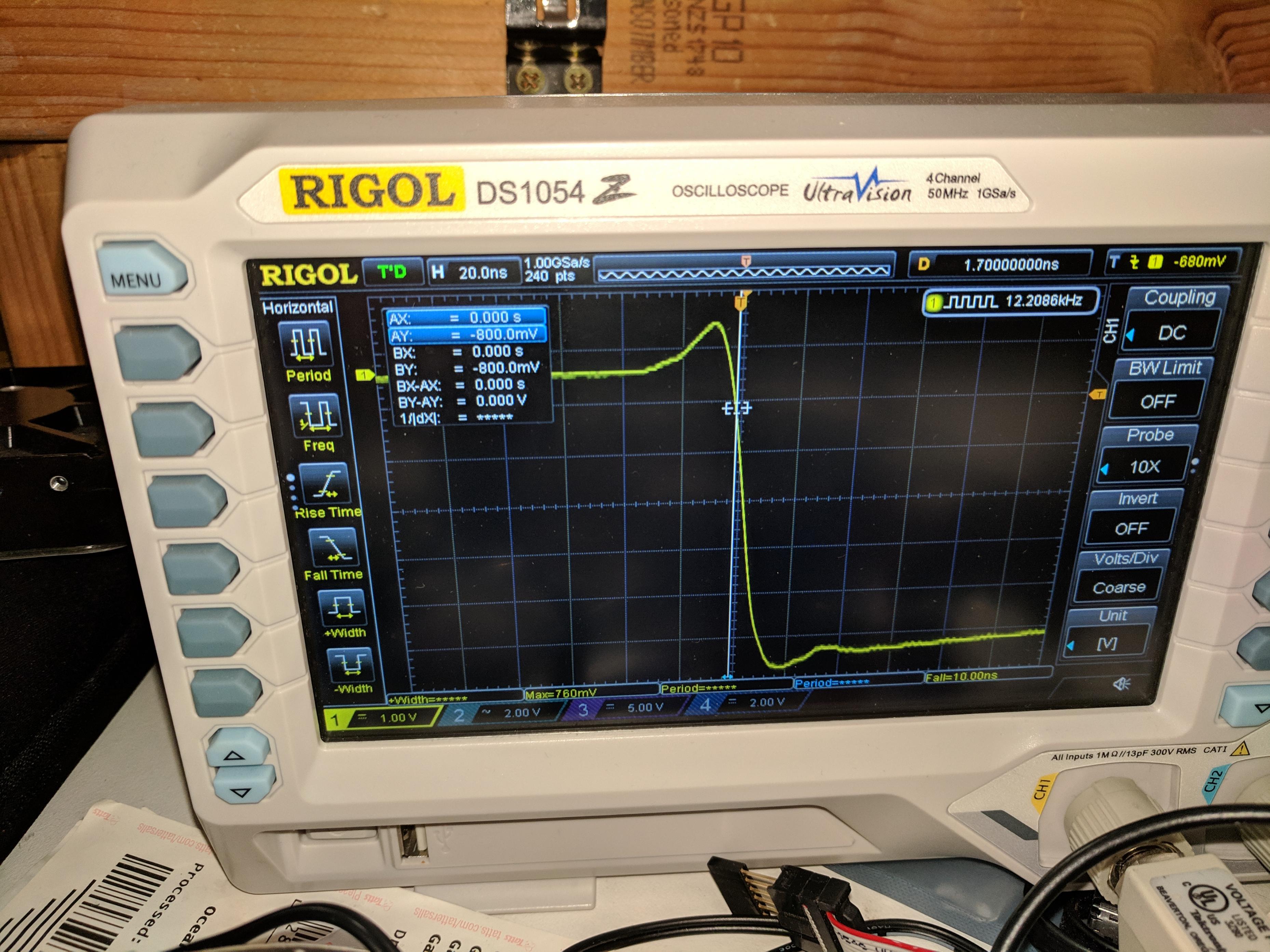

    ...as we can see from these two shots the fall time for the ne5534 is around 440 ns whilst a non clamping amplifier achieves 10.4 ns and recovers properly ... the ne5534 is still railed after it falls.
    lm6171
    ne5534

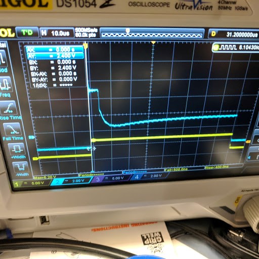

                  swapping the 5534 for a non - crowbar opamp reveals the benefits :-) in a PI frontend
                  5534 is about 8 microsecond delay with poor rise time and ringing artifacts. ( diode conduction and opamp recovery / slew rate )

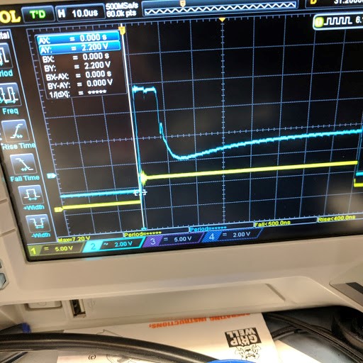

                  LM6171 considerably better.
                  same circuit ... gain set for 100. Mosfet autoswitch PI front end.
