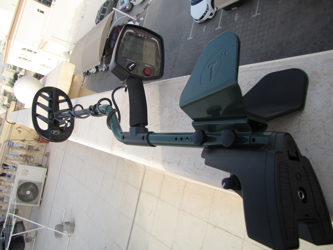

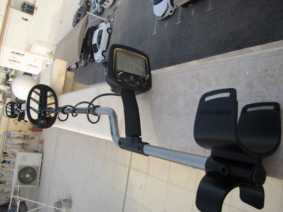

    I try helping a friend who have an event including team building with treasure hunting game. However the supplier who was about to sell the 18 detectors have stock of only 4:-(. So instead of going to the proven brand, he went to another shop and buy 5 teknetics T2 which work more than satisfactory. However the rest 13 of the detectors are chinese Goldfinder G2(they look exactly as the Teknetics G2). Aditionally the Goldfinders have no coils but they are supplied with the Teknetics T2 coils. After getting all that bunch i figure out the following:
    Teknetics are suitable(the target is an iron box, so shouldn't be much of a challenge).For some reason though the Goldfinders are detecting that 20x20 box and even more massive iron pieces only at around 12cm. What can be the reason? Is it possible that the coils are not apropriate or have a different pinout(all the 13 pieces react the same way?!?!?). Is there a chance i'm missing something in the setup which look quit intuitive?!?!? Please let me know if you have experience with these as the event is tomorrow evening and i have no idea what else can be the issue.

    My experience with Chinese knock-offs is that they are good at copying circuits, they are good at copying software, but they are bad at building coils and they are bad at calibrating everything at the end. Probably why they gave you T2 coils, though I would not assume they are real T2 coils. I've seen counterfeits of those as well. But probably the units are not calibrated properly.

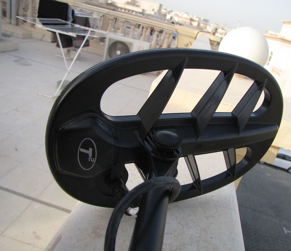

      Obvious point - Teknetics T2 coils aren't the same as Teknetics G2 coils, different L,R values, different winding configuration (T2 is centre-tapped transmit, G2 is single winding) and the pinout on the connector will differ. You need coils specifically for the G2, which includes the Fisher F19, the F5, the Teknetics Gamma, Delta 'Greek' machines etc , probably a few others ..

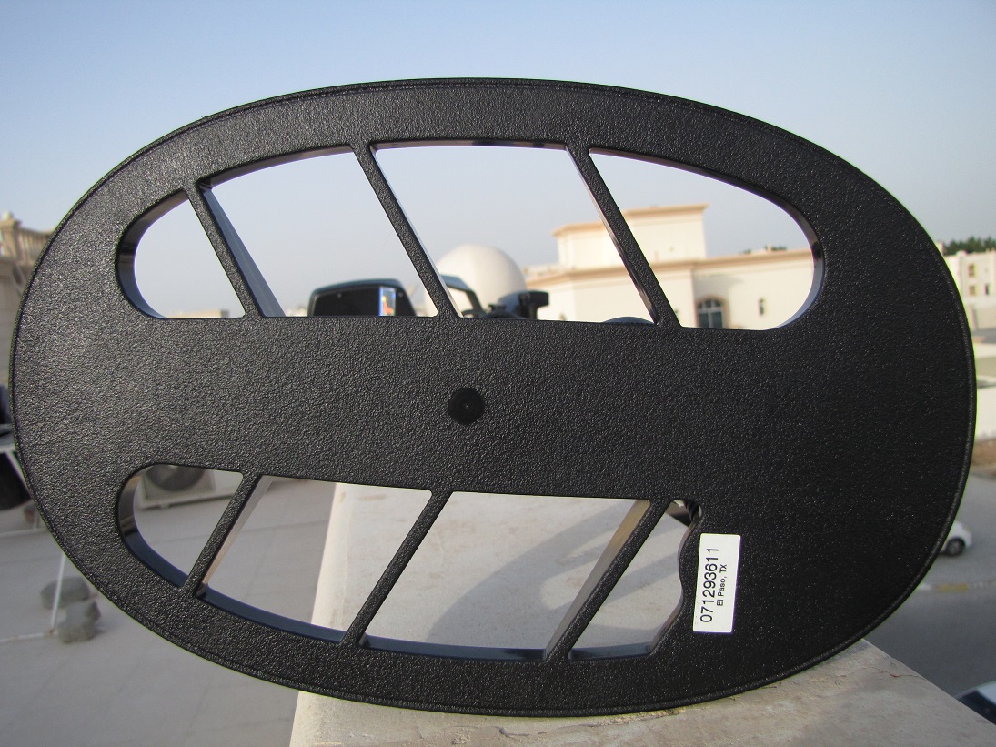

              Yeah,looking at the shape of the control box, all mentioned by sven match the descriptions. When looking for reviews and manuals i first hit the one for FS2 and i worn the guy to not buy them, but he decide to take the risk. I can give you pictures now before he come to take the one i got for repair. Thanks for the customs info, but that's not issue as they'll be used only today and if i get those free i will take them with me in Europe. As per the coils, all the T2 work fine on T2 cant say fake or not. Obvious they've being exposed to sun as despite well packed all have the external insulation around the strain cracked. Did anybody know the pinouts of both these models as the bolts are sealed with something and i dont like to take the risk opening them before they are used? Actually it is a miracle they work at all on G2:-). Forgot to mention that together with the auto ground balance the pinpoint function also does not work. I attribute it to the wrong coil.
                Here the culprits;-) Control boxes have sort of holographic stickers,but not the coils. The white things on the cable are the cracked parts where as per me Teflon insulation is visible(looks like paper though).
                  I have been to the T2 factory in China. The tx winding of the T2 coil is center-tapped, so it cannot be matched with G2. Match the right coil for optimum performance
