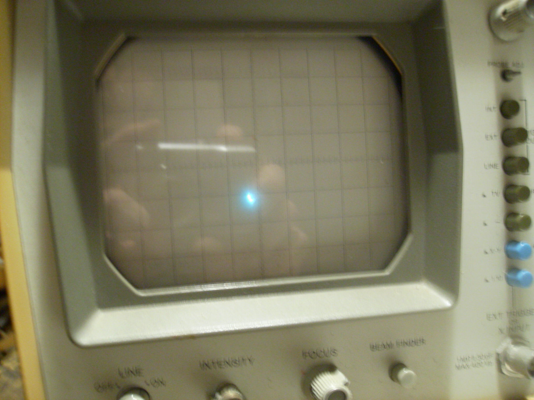

    Well it doesn't look like I won't be doing any more measuring. Blasted scope refuses to scan.
    But it's old and needs to be trashed.
    ???? Fix it. Dang you must have more money then I do.
      I gave it some thought until I noticed it was manufactured in 1974. I guess I'll trash it.

                What is the model # of the scope? If both of us have the manual of the scope this might be doable. I have many years of repair/cal experience on older HP and Tek scopes. Old analog scopes are pretty straight forward and unlike newer scopes are actually repairable.
                Rick
                  1220A
                    EVERYTHING one could ask for to revive that thing is at hand, man. Take advantage of it. Hell I wish I had a scope of that caliber. What is the model number ? Dhooooe , Here ya go ! EVERY THING you could ask for ! http://tinyurl.com/7slcrrz

                          That pdf is for the 1222 not the 1220A. The manuals I found were either very incomplete or mostly unreadable (very poor copy).

                          Are you sure the scope time base is being triggered? No trigger (internal or ext.) with the brightness turned up can produce what you see.
                          The operating instructions part of this manual are just clear enough to be useful. The schematics and parts layout are mostly illegible.

                            The most I get from the scope is a single glowing dot in the middle of the screen. I've adjusted every possible setting in the original manual. I can adjust the focus and move the dot around using the horizontal and vertical adjustments, but the solid line across the screen will not come up. I've used both inputs and applied a signal to each, but the dot never changes.
                            Since the scope doesn't have the capability to measure coil frequencies (with ID's) repairing the unit wouldn't contribute to my detecting interest, I'll probably trash the unit or give it away.
