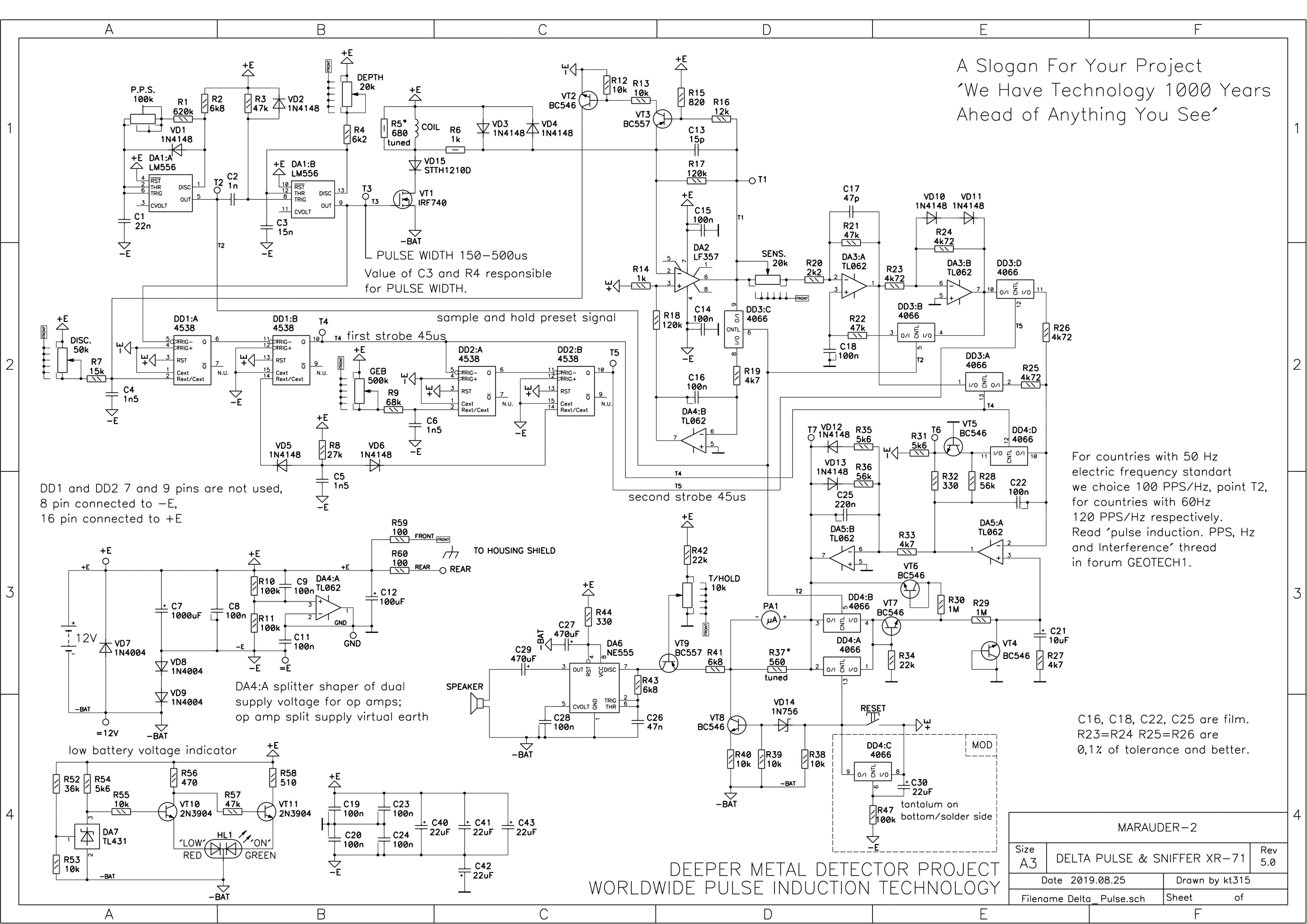

      Can you share the dp rev5 latest schematic?
        latest

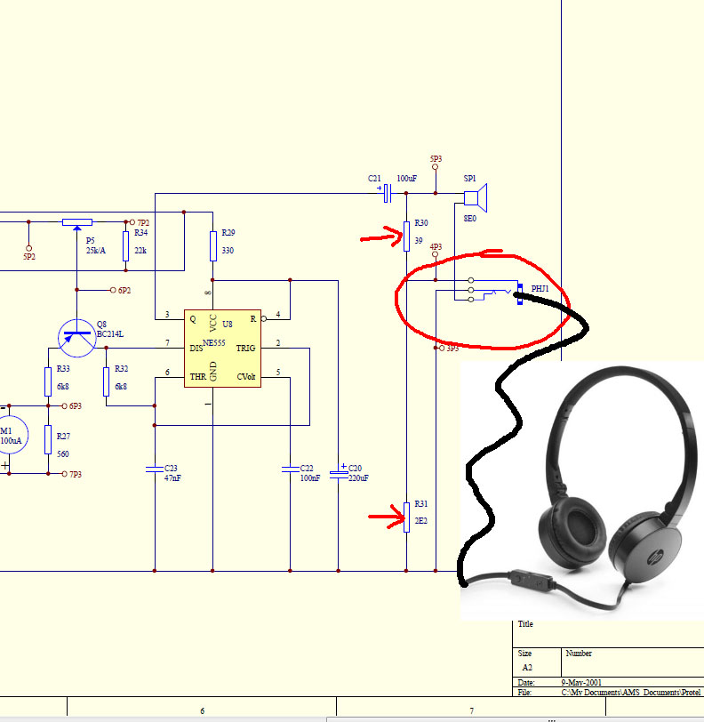

          I see The changes are c27 c29 and r46 (with rev3 schematic)
          is there any other change??
            r45 and r46 were in old circuit. i deleted them because nobody uses a headphone they were for. no need.
            also, i had noticed people have a problem to find out the resistor with low value 2.2Ohm. now this problem disappeared
            c27 an c29. modern polar capacitors have less sizes vs old ones so set 1000uF x 16V.
              reporting you smallest changes in DP board had (HAD) done and soon i will order new pcb batch revision 5.0.
              i promise you that EVERYONE will get this board with 2-5 meters of the depth on cola can/banka.

                    In my opinion this change causes more current to speaker
                    This may increses the sound of deep target
                    What is your opinion?
                      my opinion learn all documentation i gave. look all files. current in speaker is small

                                For r23 to r26 i dont have access to 0.1% telorance resistor
                                Can i use from 1% telorance?
