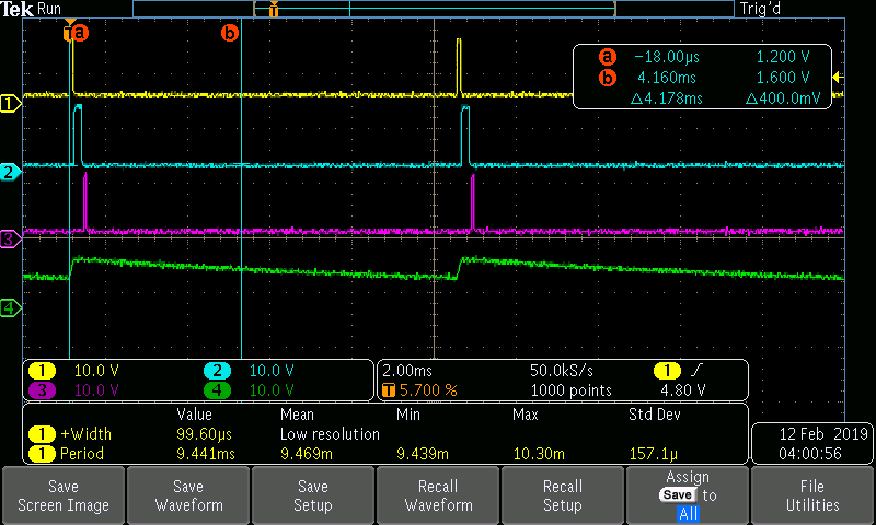

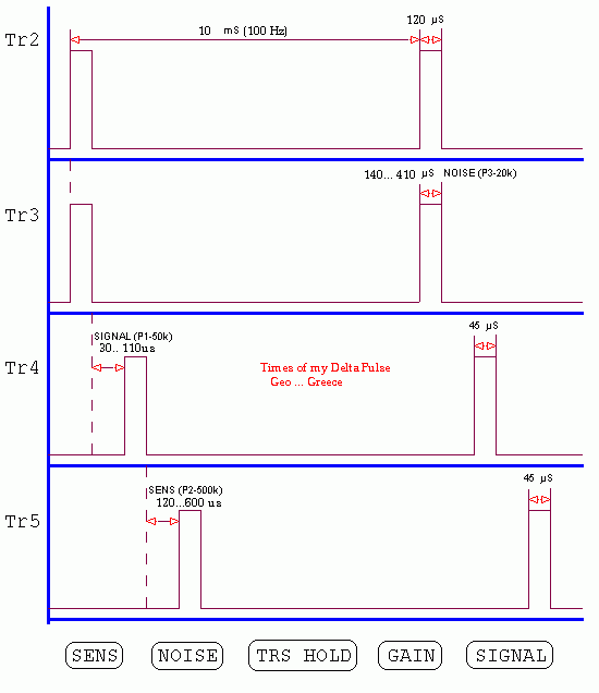

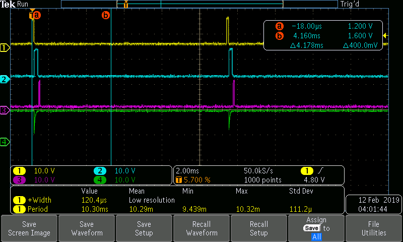

                I have a timing diagram for XR71 from KT315's info dump
Name:	Correct diagram_by_Geo.gif

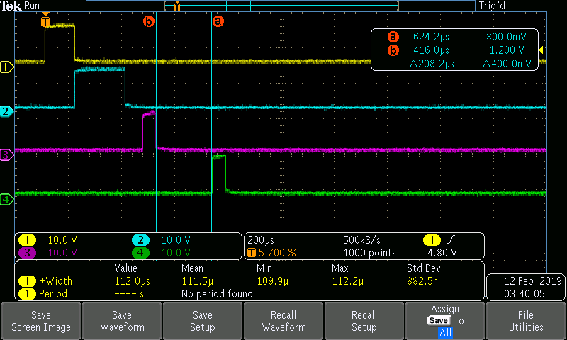

                When compared to my scope measurements I have an issue with TR3 (Gate leg at FET) - the timing diagram shows alignment with TR2
                The timing measurement shows TR3 behind TR2 :: Yellow=TR2 and Blue=TR3
                I then checked triggers of pin6 and pin8 of 556 chip and there is a relationship but I dont know if its correct or not....This is where my foundation knowledge and experience is lacking
                Green=pin6 or 8, Yellow=TR2, Blue=TR3, Pink=TR4
                pin 6
                pin8
                Question: Are TR3 and TR2 supposed to be aligned (rising edge)?
                If so, what are the best guesses as to why it is delayed (trigger or threshold or other???)
                All the other signals look pretty good, spacing and width are adjustable by potentiometers
                Thank you all for the input
                Last edited by Fugazi; 02-12-2019, 05:47 PM. Reason: added color reference for plot legend

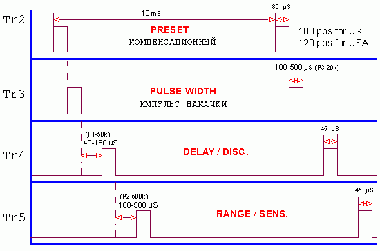

                  sorry you are operating by very old data diagram that was corrected many many years ago by russians.
                  so i could not share this diagram neverwhere.
                  right one was posted 1000th times but as you are newibie for the forum you do not wish actively
                  to use advanced research knob (laziness maybe).
                    Thank you for the update, diagram looks more like what I measure
