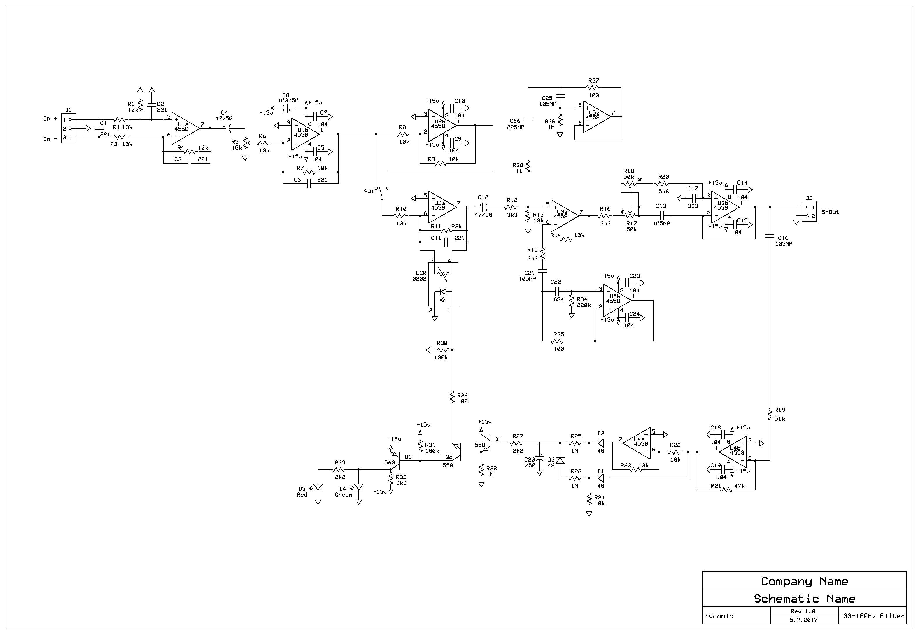

                                I was also annoyed by "tic tic" sound at various diy's i replicated through the years.
                                Than i saw Dooley's design and i made it. I like the solution. Pleasant sound.
                                Later on i randomly stumbled on decent batch of cheap yet pretty fine LCR 0202 analog linear optical couplings.
                                I was about to make precise adjustable 30-180Hz band pass filter.
                                So i bought several pieces from Aliexpress.
                                I used only one of those so far. Delighted with how fine it behaves actually.
                                Several others from a batch still keeping unused.
                                So i was thinking to make variation of Dooleys approach but with LCR0202.
                                Separate module, for to adding on any PI design.
                                In meantime i started to learn bit better programming. So now i want to control LCR with PWM from uPc.
                                Working around it in spare time.
                                Just to get the idea; here is the schematic of filter i made and the application of coupling:
