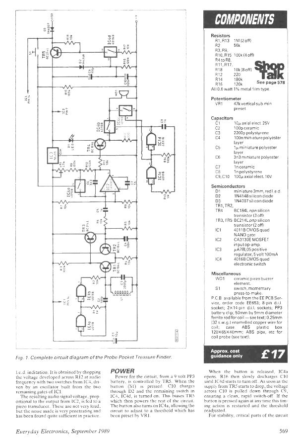

    There's definitely some work gone into the design. These days, it would be sensible to replace the differential pair with an SMD dual transistor, which are dirt cheap. Back in 1989 , there wasn't much choice, dual transistors were expensive niche components.
    The 'soft' power switching is an interesting feature.
    It's nice to see a design that doesn't have more preset pots than fixed resistors.

          There's definitely a few improvements/changes could be made, using newer tech. The 78L05 could be replaced with a lower quiescent current equivalent, to reduce power drain. There's scope to make it run on two Lithium cells, as long as the 5V regulator keeps working, the rest of the circuit should be fine. A schottky diode for D3 (in series with the battery) would improve low voltage operation.
          I would choose to put two LED's in parallel, and have one on the rear of the case, one on the front. When you're using it down in a hole, you need a rear LED. Using modern high efficiency LED's will get round the reduced current draw. Or .. use an additional transistor , one to drive the beeper, one to drive two LED's in series ... more efficient.
          It would be good if it could be made to work at a lower frequency, like 30kHz, which is more appropriate for the typical targets we find.
            What transistors are you going with ?
              I am using BC549C for the NPN I have a lot of them, the BC184L is nothing special has a simillar gain 450-900 to the BC549C gain 420-800 see how it goes can always change them if i have to.

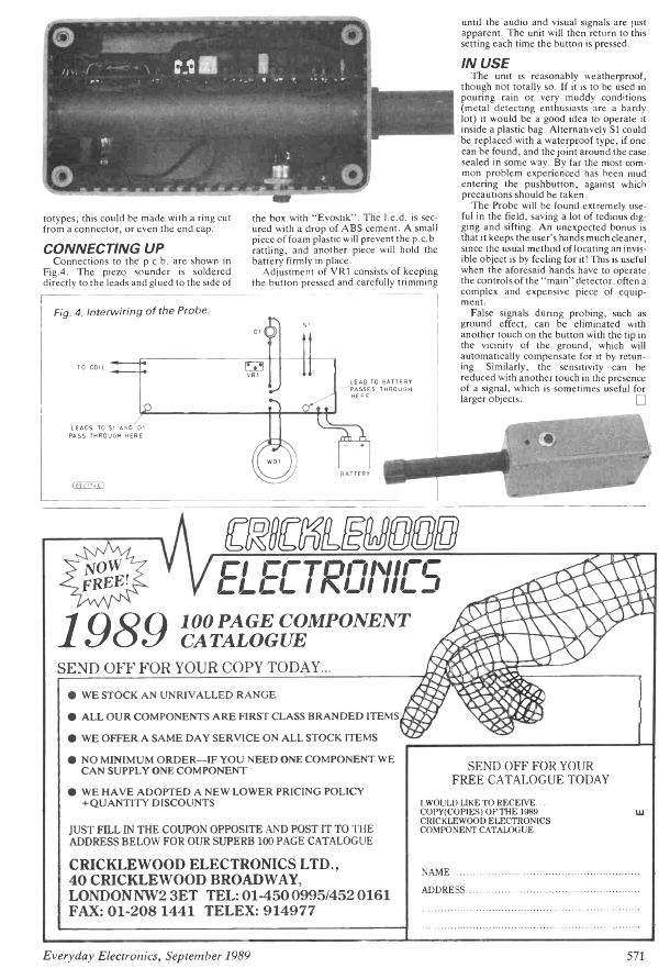

                  Cool article on the pinpointer. The author did however violate the first commandment of DIY building: Test each subsystem before adding more parts.
                  TESTING When the coil has been wound, the p.c.b. can be tested. The author has built quite a number of these units, testing being limited to simply powering up the complete p.c.b.'s and dealing with faults as they arose.

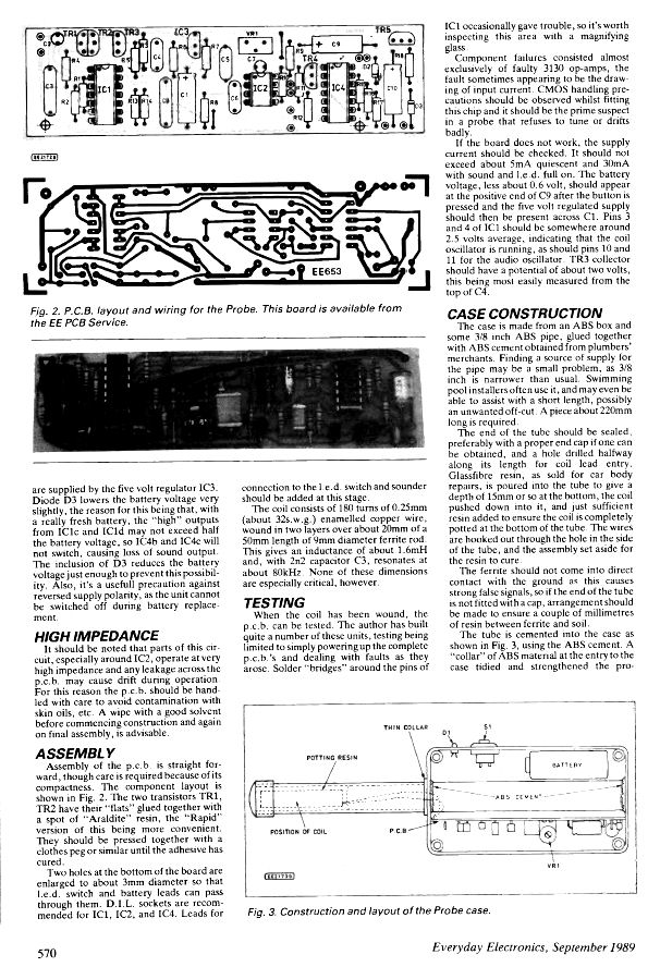

                      Here is the layout in Sprint. I've modified it for radial elecrtrolytic caps instead of axial, and some minor spacing adjustments.

                              Beta matching on a cheapo multimeter should suffice for the transistor pair. A vibro motor salvaged from old phone might be a good modification.
