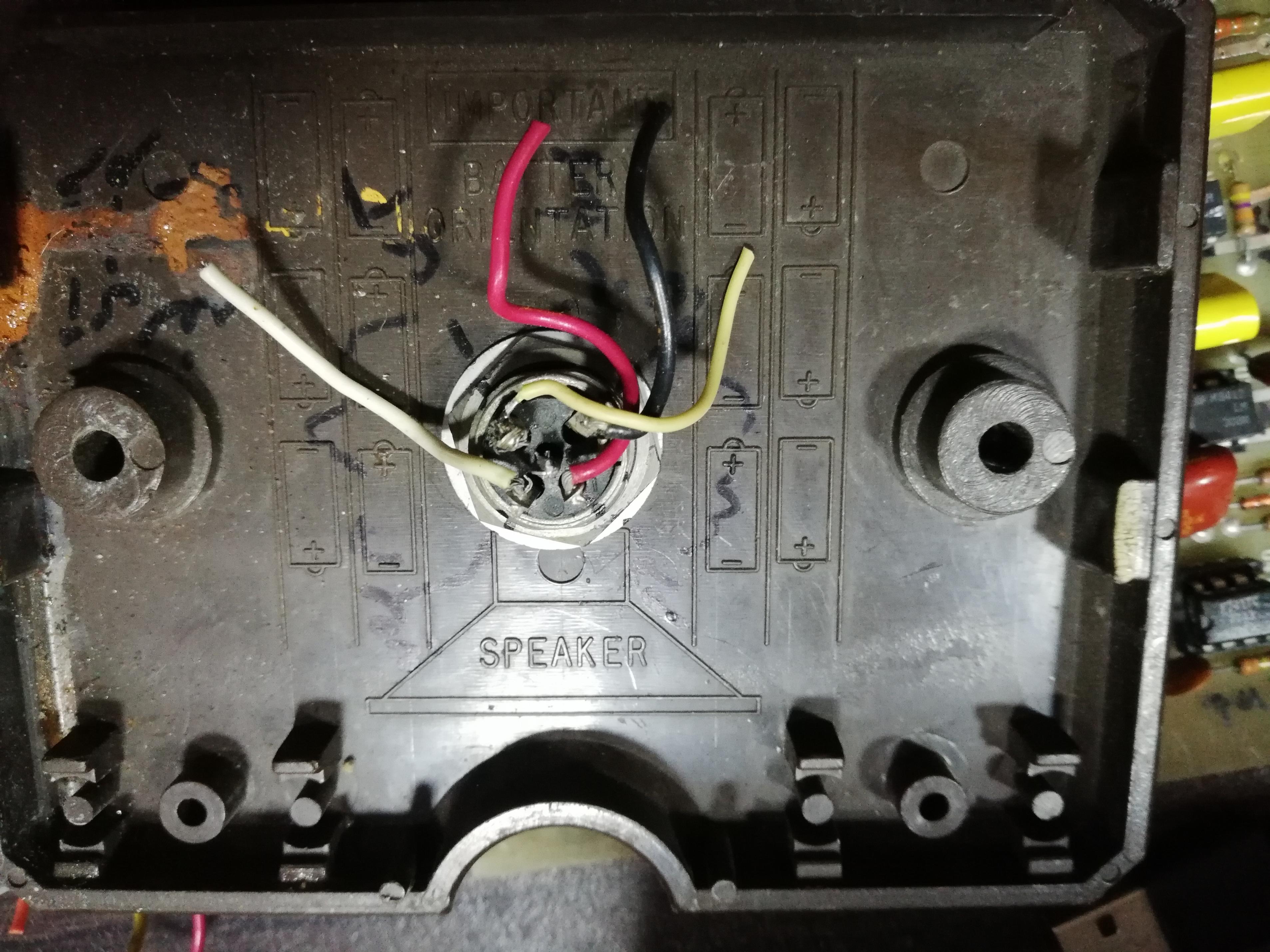

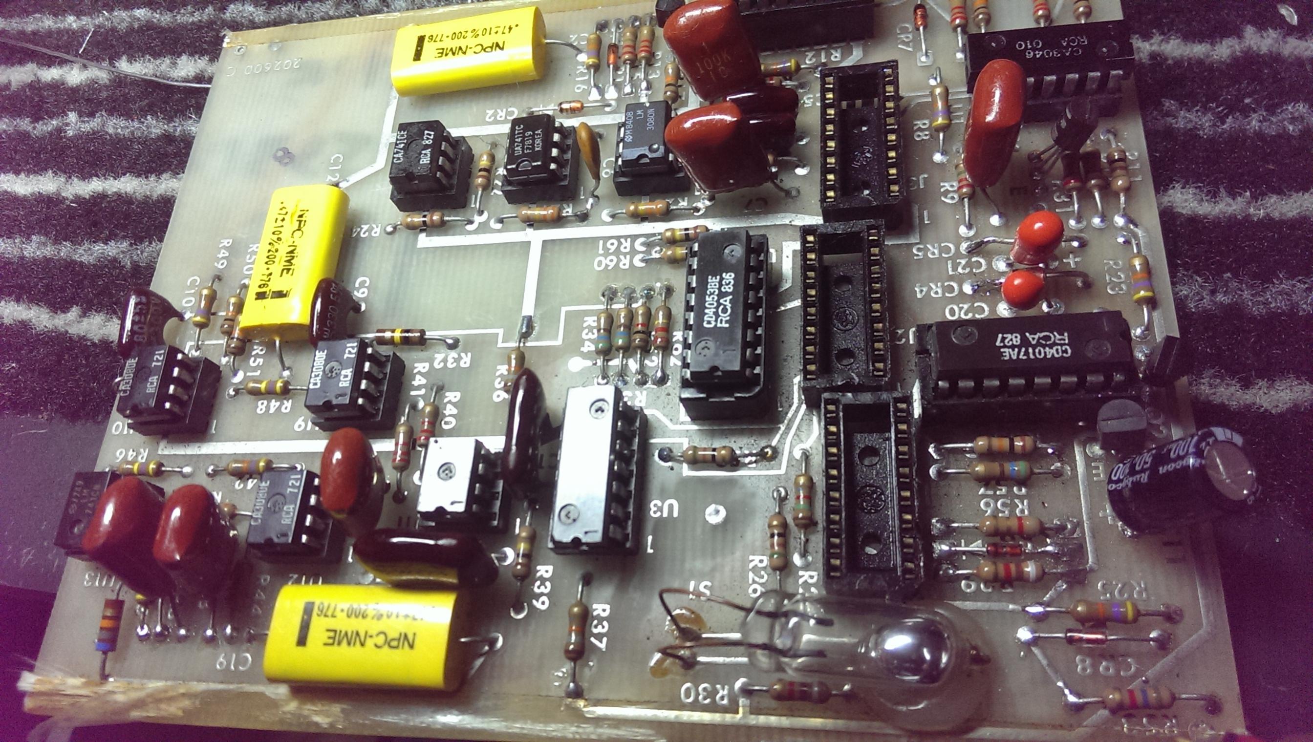

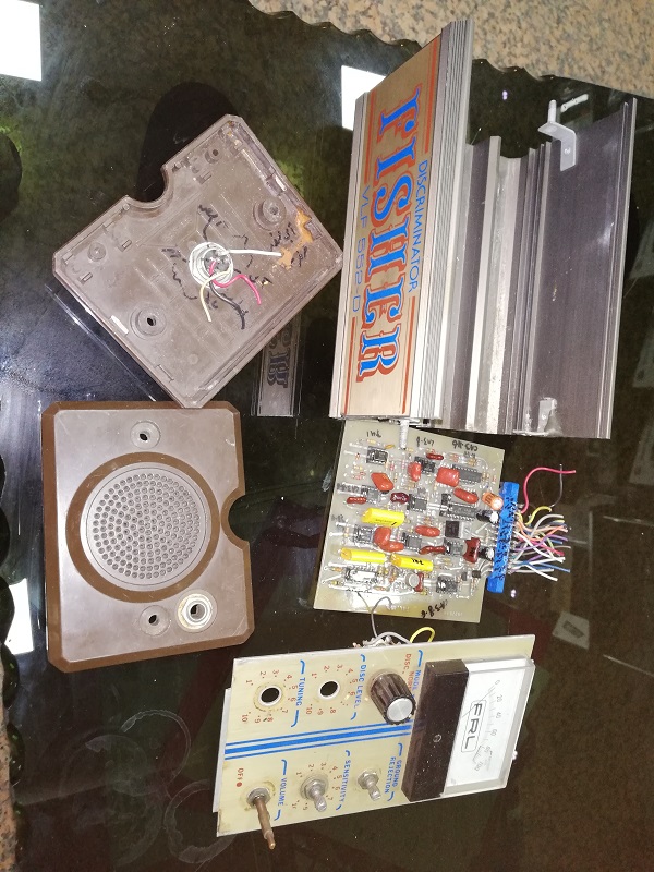

    I have a fisher 552-d vlf metal detector.I satisfied with my metal detector, but unfortunately my brother broke its at all and diswired all of connections as you can see in attached picture. So I hope you will help me to fix it. Actually I have experience with electronics device repair and I can iron it if I have a wiring diagram or schematic of this device.
    If anybody have this metal detector please send some pictures from inside .Click image for larger version

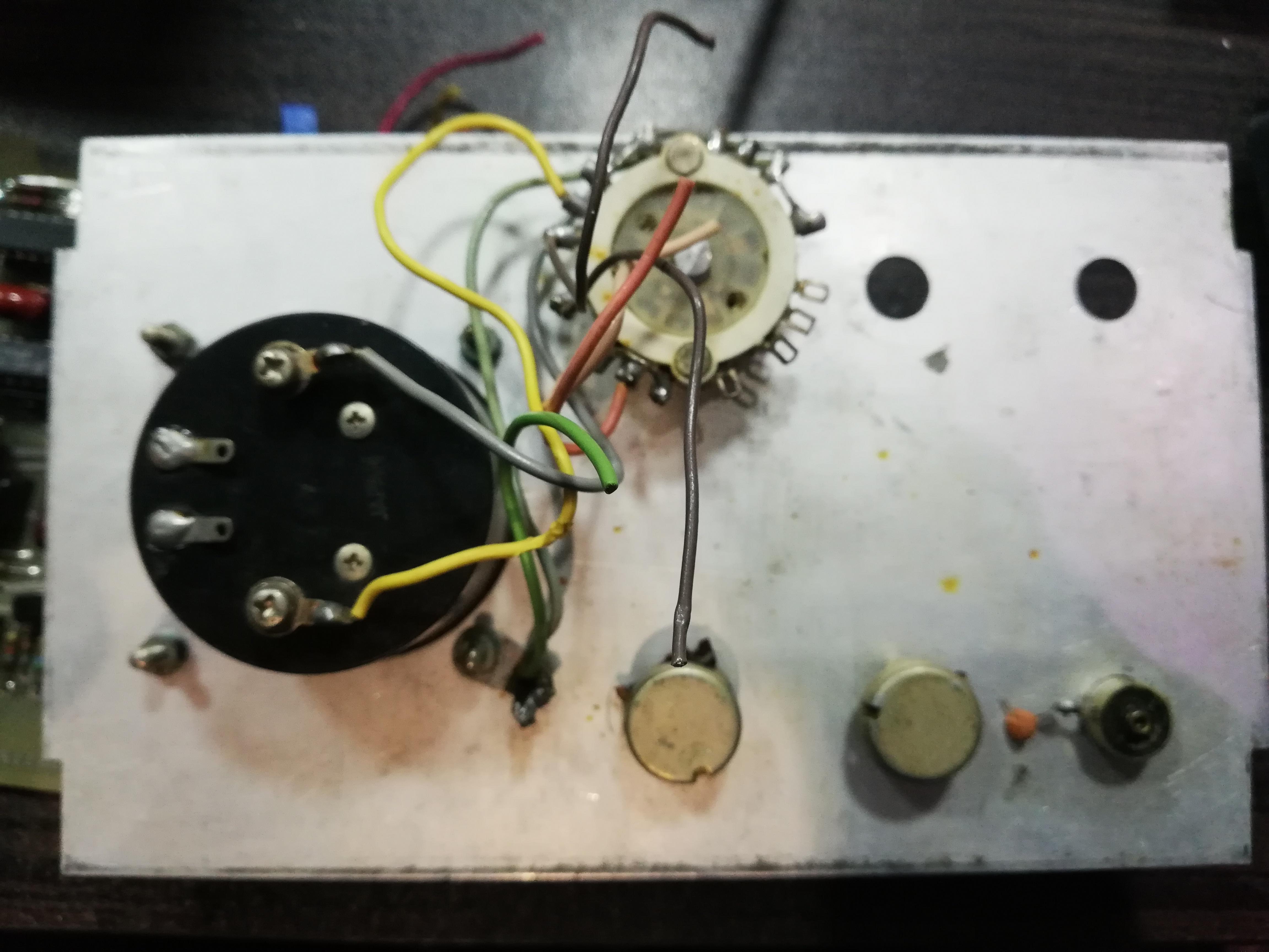

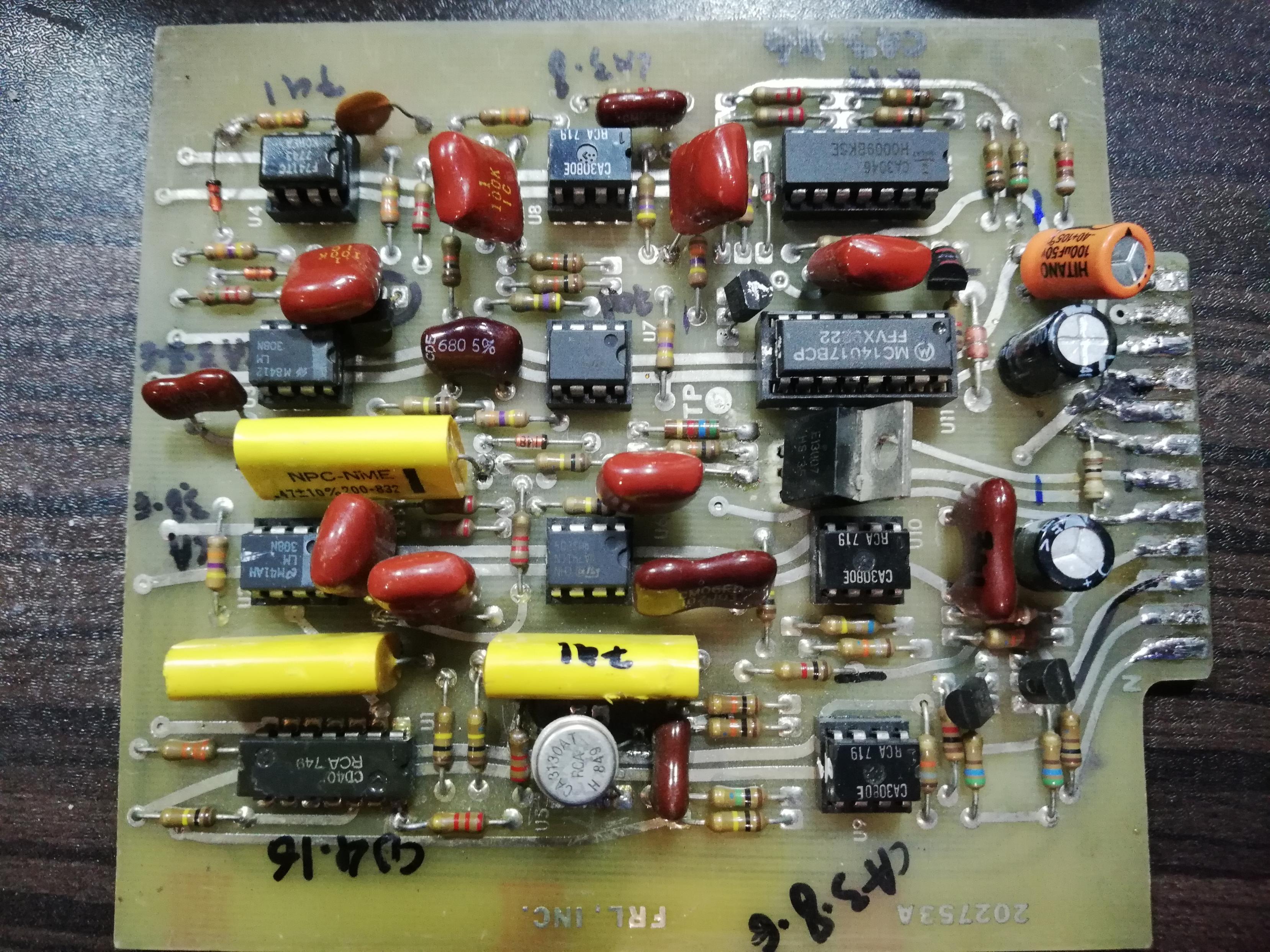

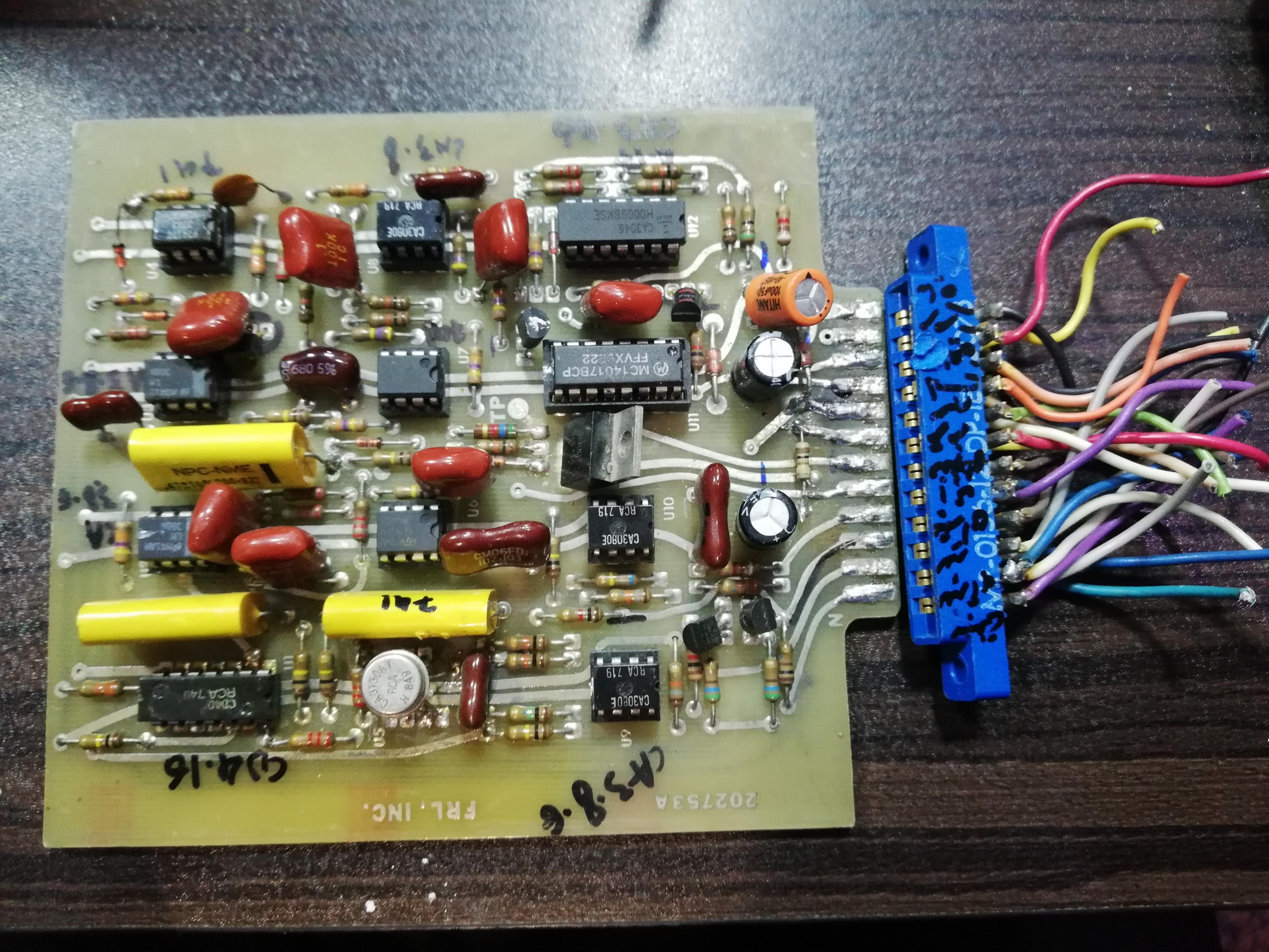

                But my detector version is so different from yours .I'm confused because it has a 24 pins socket that cut all of wires and some of pots are broken or missed.
                I send some better pics .
                Thank you againClick image for larger version

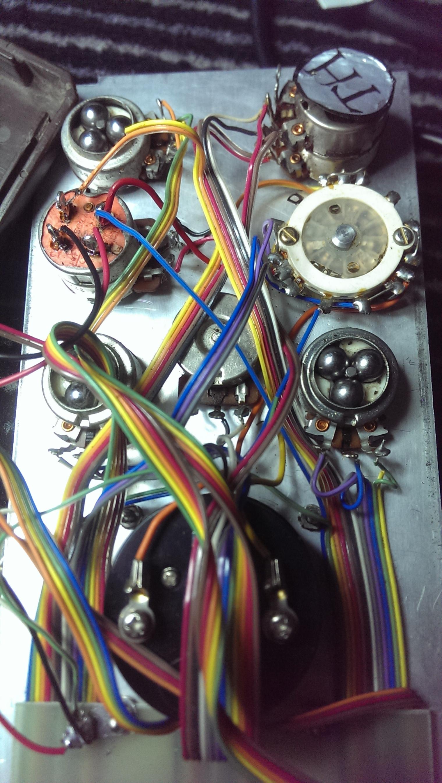

                  and thisClick image for larger version

                    i am glad to help but my archive does have not pics of 552-d board. just 440, 553, 555 and polish detector ALL-1 based on 555.
                      Listen to me carefully guys, I know for a fact that their is schematic of the 552d, here on forum, just that nobody recognized it as such because it was not correctly labeled. I have it on my laptop somewhere. I try to find it.
                        Ok , KT315, please put Fisher 555 schematic from your archive. That one is in fact the 552d and not the 555.

                            Check in the folder titled "555", this is the schematic for the 552D. If you give some pics of the back of the panel, and the top and bottom of the PCB, I will show you where all the wires are connected. I can draw wiring diagram for you.
