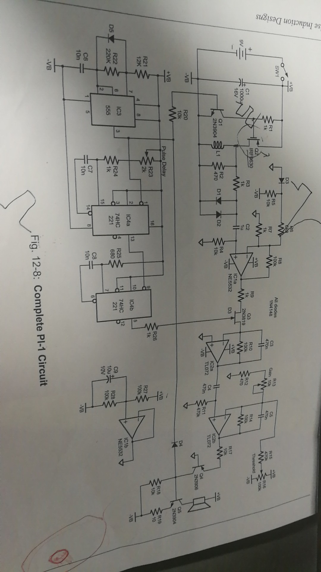

      I wanna simulate the design below and try to learn how does it work. However, while I using the LTspice, there is no ne5532, tl072 and 74hc221. I do not know how to continue to analyze it. Have you done the related simulation before and how did you achieve it. I wanna change the circuit to produce 2 delayed clock signal but I do not know how to do it. Thanks for your help.

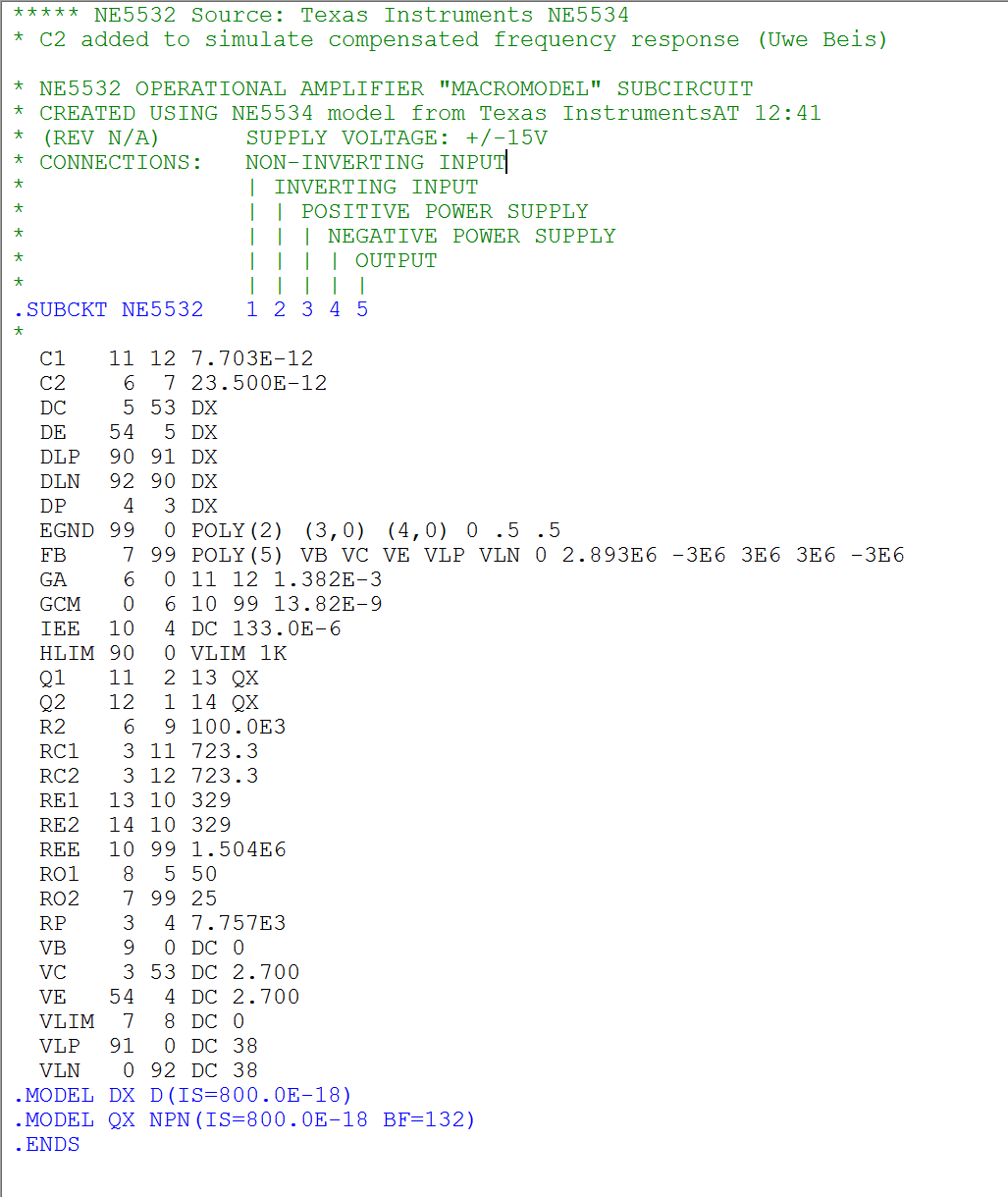

        I also tried to use the LTspice software and Found a model file for NE5532. However, the output of the preamp part is a square wave instead of a clamped signal.
          It is useful to simulate the TX and preamp portions in Spice, and see how the flyback & decay respond to changes in the timing or circuit values. You can even introduce a target by using a mutually coupled LR (this shows up in other threads, you'll have to poke around to see).
          Once you get to the demodulator (FET switch) the simulation becomes more difficult and hugely time consuming. This is where it's far more useful to just build the thing and play with it in real time.
            I need to simulate the circuit to compare with the results of the circuit I built to see if it is correct. But the simulation output from the preamp ne5532 part is different from the practical results. I wonder if you have done a similar simulation before and give me some advice to achieve it.

                I have probably never simulated this circuit, and certainly not the '221. But I have simulated PI circuits all the way through the demods. Using idealized switches and clocks. Models for the 5532 & TL072 are widely available on the Internet.

                    Here is the ne5532 amplifier model I found and the output from the chip a is a square ware instead of the amplified clamped signal as shown below. In addition, this design from the book introduces to create a 'ground' and compensate the offset signal on NE5532. But when I read the design of Surf or Hammerhead, I found the designs are different. What is the advantage of the book design?Click image for larger version

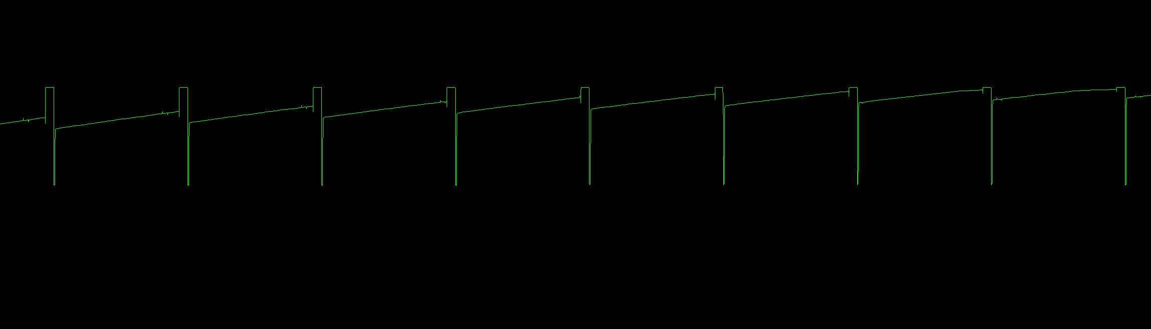

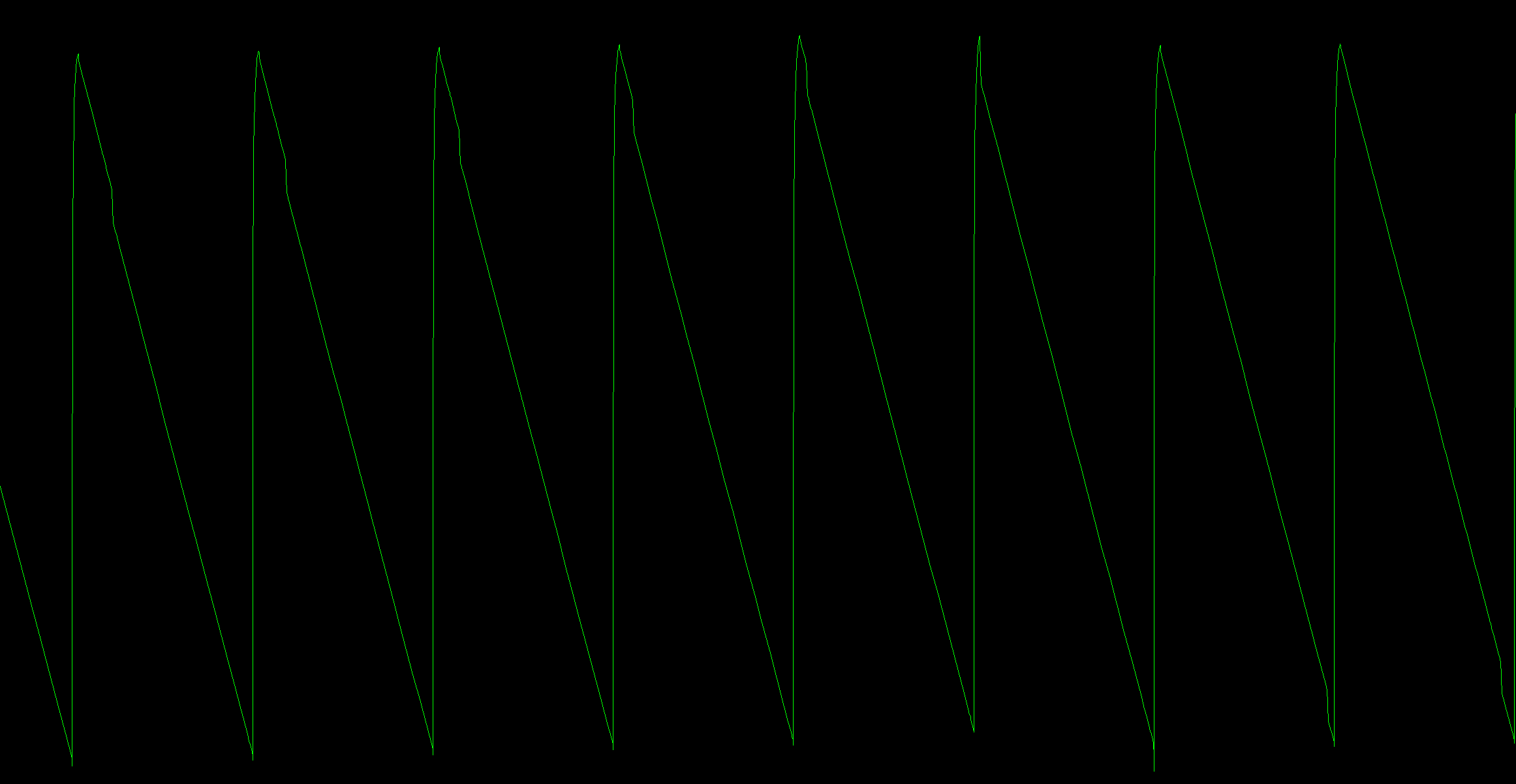

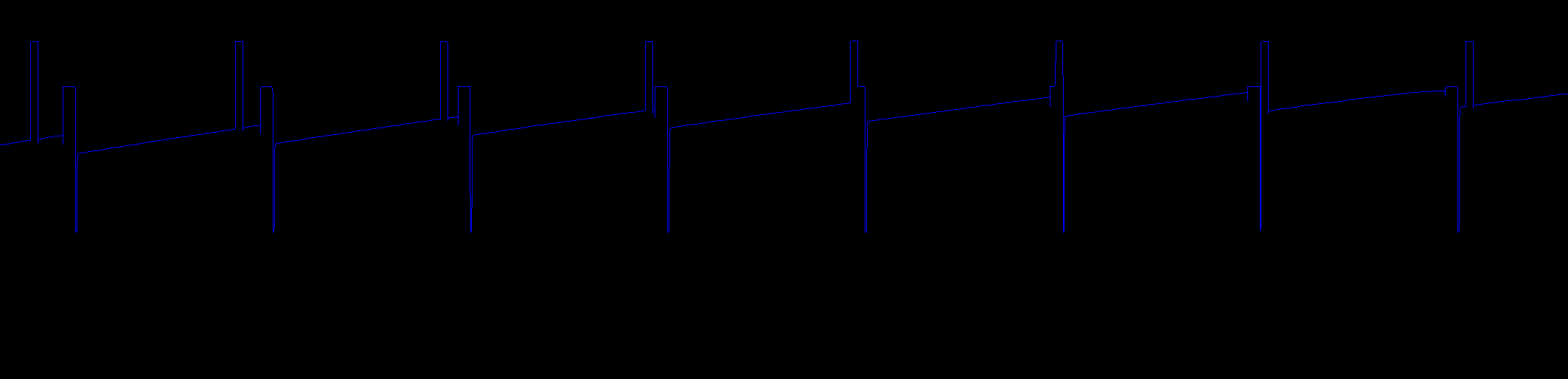

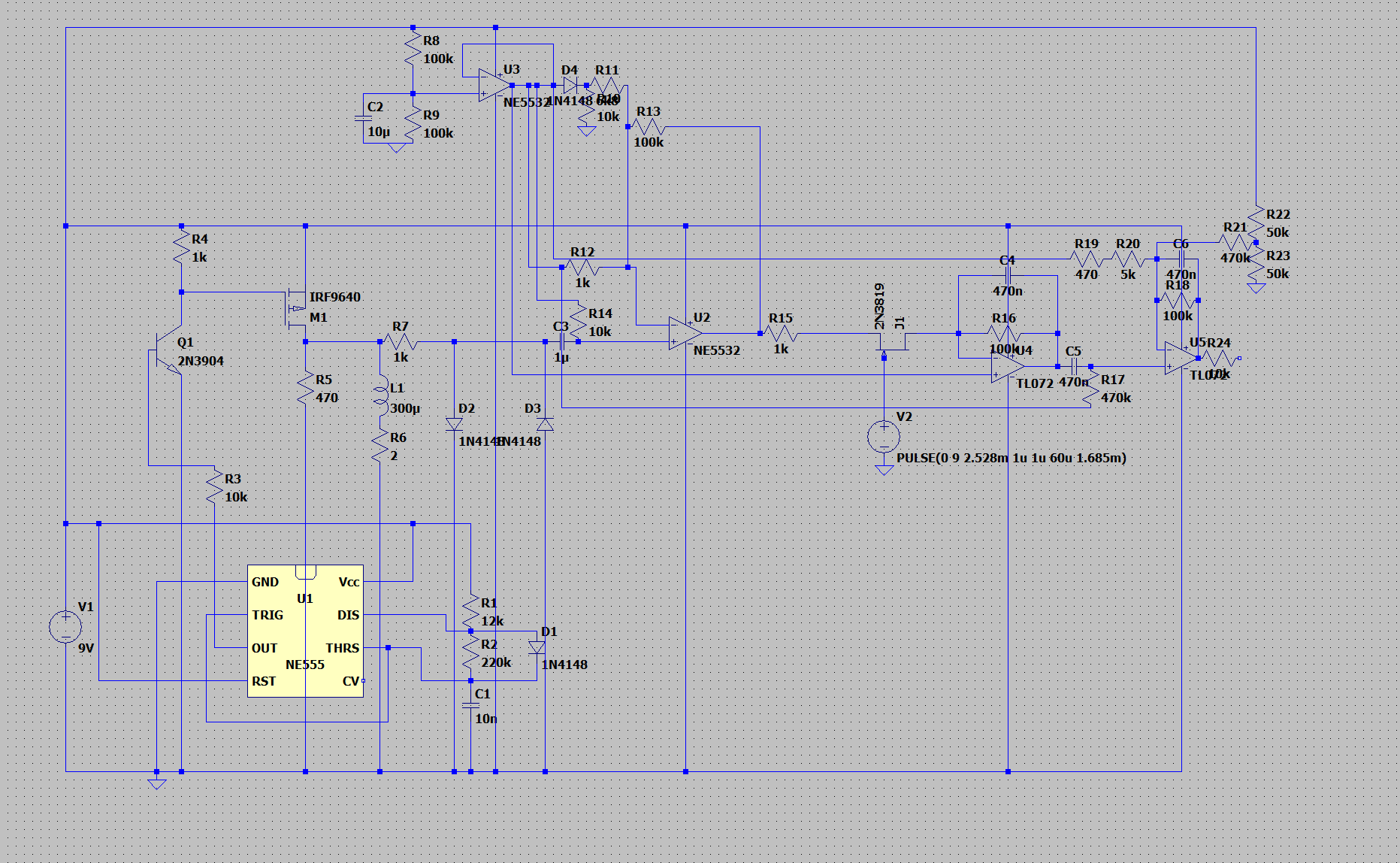

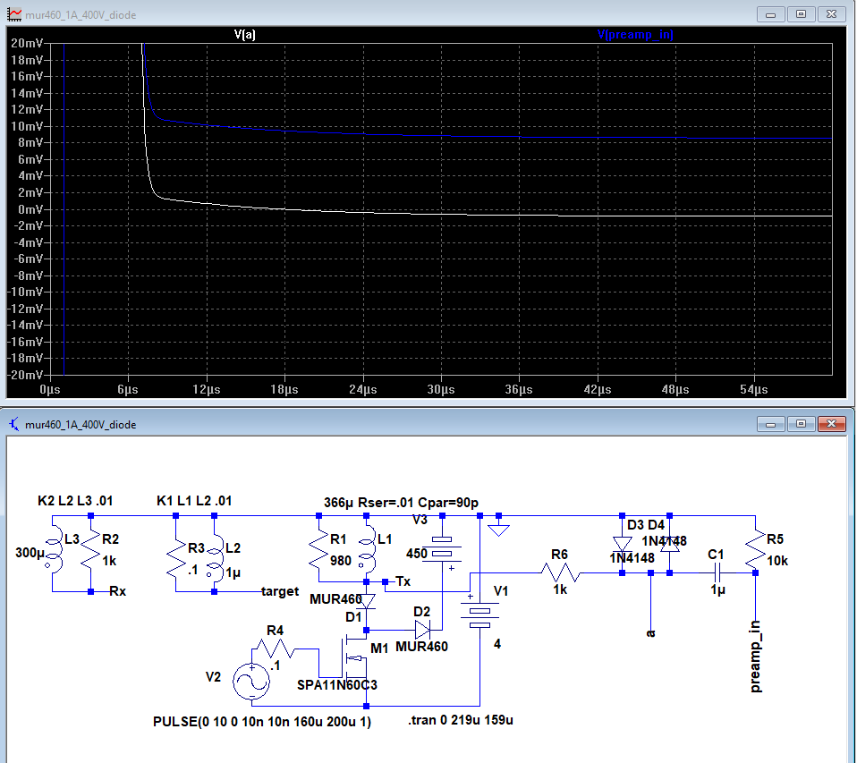

                              Yeah I just do not know why the C2 needs 30ms to be set. In addition, I built the circuit in ltspice. The output of ne5532 is shown and i use a voltage source to produce the delay. However, the result from ne5532 shows that it keeps changing which is strange and after the 1k resistor the signal has an additional square part and the integrator circuit does not output a certain DC level and the output of TLO72 keeps raising. Could you please help me to solve it.
ID:	353451Click image for larger version

                              signal pass through 1k resistorClick image for larger version

                              integratorClick image for larger version
