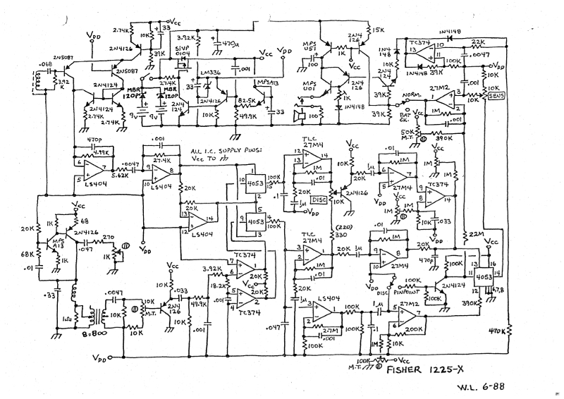

    hello I ask for help for a metal detector Fisher 1225 when I operate the pin point the metal detector detects the object, but after a little it loses sensitivity gradually until you feel the object just resting on the plate, Thanks for any help and I apologize for my English translated by Google

      sounds like my 1265x which turned out to be a capacitor
      https://www.geotech1.com/forums/showthread.php?24776-Small-problem-pinpoint-mode-1265x&highlight=1265x
        From the schematic you posted, there is 1uf capacitor connected to the pinpoint switch and pin 5 of the op-amp. As Koala stated this could be a bad capacitor. It may also be dirt and oxidation on the circuit board. Which could cause the 1uf capacitor to lose it's charge through leakage currents. Try cleaning around that 1uf capacitor (top and bottom) of the pcb with alcohol with a toothbrush before changing the capacitor.

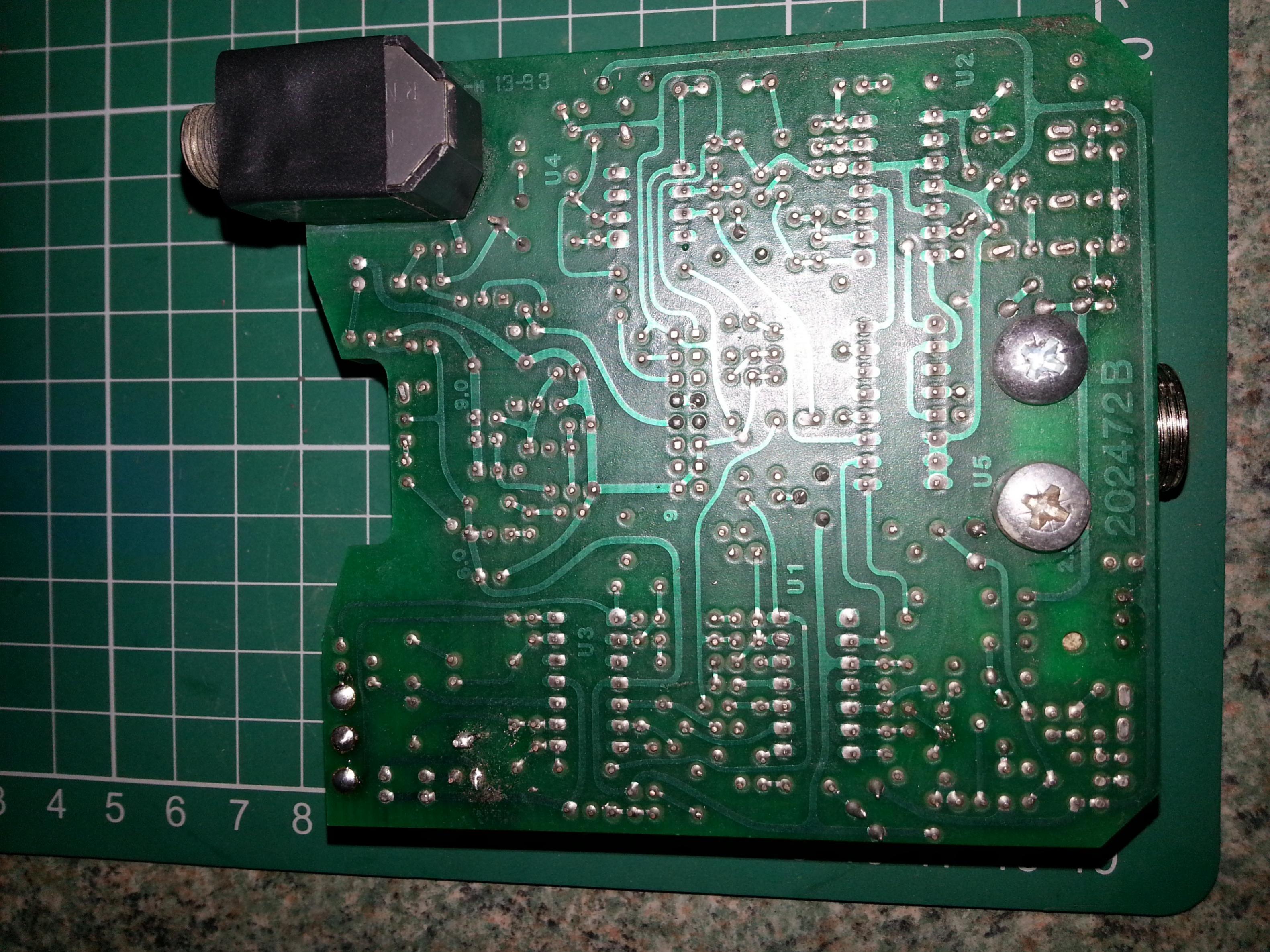

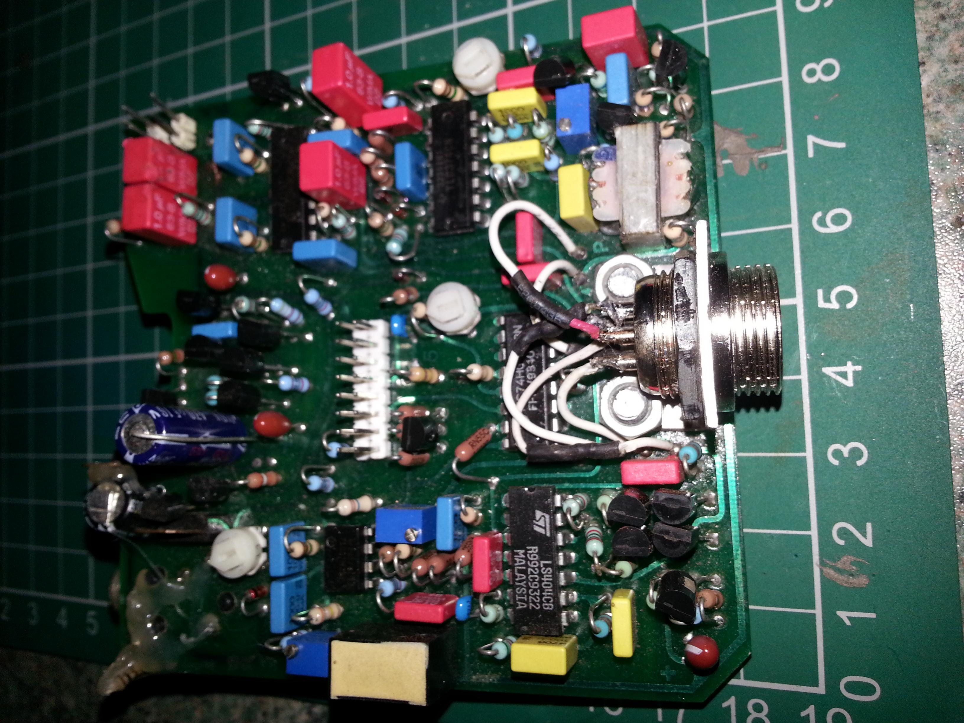

                    please send pics of your board in hight definition HD on good light on my email [email protected]
                      thank you very much for the pics you sent me but... please read my opus before to do
                      https://www.geotech1.com/forums/show...here-share-out
                      sorry that i must teach you by those ABCD like in 1st stage of beginner school.
                        Hello everyone, I cleaned the circuit board but no result, so I replaced the 1?f capacitor but still no result the pinpoint does not improve. Sorry for my english translated by Google
                          Capacitor 1 micro f Sorry
                            guys
                            i ask you to help sending me perfect pics. you send pics like a trash. I REALLY WANT TO HELP YOU BUT WHY YOU DO NOT WANT HELP YOURSELF.
