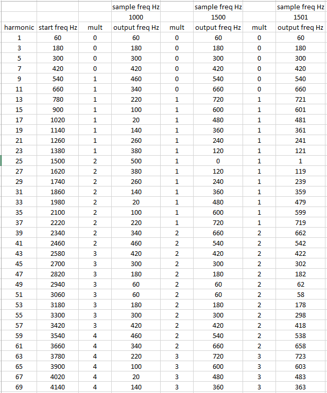

                            Still trying to understand why. Thinking sampling theory. Wondering what causes beat frequency. Two frequency's summed causes beat frequency, something else? Wondered if aliasing could be causing it. Excel program calculates frequency out with 60Hz and odd harmonics. Don't see that being the reason. What is causing the beat frequency? Does the sample frequency need to be an exact multiple or is .1% close enough?
                            Does the sample frequency being in sync with the 60Hz reduce he noise, cancel the beat or both?

                              Similar to sum/difference of two frequencies.
                              A PI detector pulses coil on then does Sampling (analog switch) into detection circuits (integrator).
                              Let say this rate is 1500kHz, a 666.666... sec period.
                              60Hz AC's period is 16.666... msec
                              Therefore the PI circuits samples the 60Hz AC 25 times (16.666ms/666.666us) in one 60Hz cycle then repeats again and again.
                              There is no beat since both repeat exactly: 1 60Hz cycle for 25 PI cycles.
                              Now if the PI frequency is off a bit, say it has a period of 665usec, frequency is 1503.459398...Hz.
                              Then there are 25.06265664 PI cycles per 60Hz cycle. This creates a beat of:
                              1503.06265 - (25 * 60) = 3.759 Hz.
                              If PI period is 660us, frequency is 1515.151515... Hz & 25.2525... times 60Hz so beat is:
                              1515.151515 - (25*60) = 15.15Hz.
                              These Beats will be heard from the SAT stage if threshold is too low and causes the threshold to be raised to
                              not hear this but this looses sensitivity and depth. This can be seen on an O'scope at the integrator and SAT outputs.
                              There will also be some addition mixing products if the primary 60Hz is not a clean sine (motor spikes, etc) that
                              create noise if the primary AC is allowed to create beats. so the answer to your question is it does cancel the beats and
                              help reduce noise that is coherent with the 60HZ AC mains.
                              It will not reduce random or broad band noise or interference at some other frequency like being close to an AM band
                              broadcast station.
