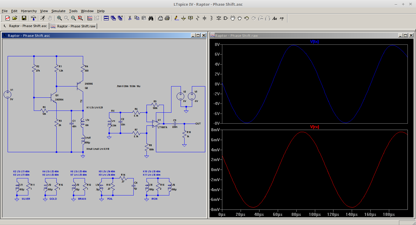

    Using these targets in my own simulation (attached), all targets gave a phase-shift to the left and an amplitude increase, which is incorrect for iron. The iron target should provide a decrease in amplitude. However, this represents major progress, as the simulation is now responding correctly to non-ferrous targets for a concentric coil.
    Target Vpeak Phase-shift In-phase Quadrature Degrees
    Silver 48mV 5us 4mV 44mV 85
    Gold 48mV 4us 6mV 45mV 82
    Brass 32mV -5us 20mV 32mV 58
    Foil 12mV -6us 8mV 11mV 54
    Iron 10mV -18ms 9mV 6mV 34
    None 8mV 6us 0mV 7mV 0
    The attached LTSpice simulation is based on the Raptor transmitter and preamp running at 10kHz.

            I'm skeptical of using an LR model for ferrous targets. The LR model is valid for eddy targets which are limited to a phase response from 90-180 deg. Magnetic responses have a range from 0-90 deg which the LR model can't do, plus have a different frequency response. You need to figure out how to implement a B-H curve in Spice, some simulators support this and some don't.

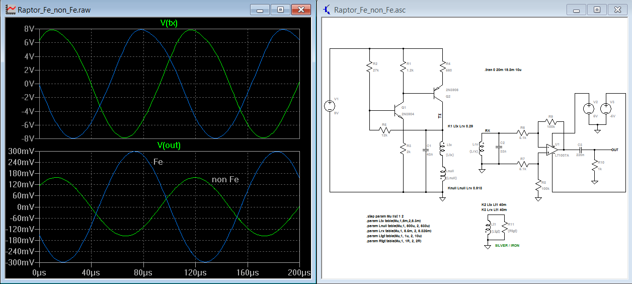

              All targets have an inductance value that's added to the inductances of the Tx and Rx coils thorugh the coupling coefficients. The issue with magnetic targets is that besides an inductance they also have a magnetic permeability that contributes a further increase of all inductances.
              My approach to the simulation of ferrous targets is to step the Tx and Rx inductances from their nominal values to higher than nominal due to the increase of . Then you will see a decrease of the amplitude because the Tx inductance is higher, and a lag in the phase because the frequency of the Tx oscillator goes down.
              In the sim the assumptios are:
              - The of the ferrous target increaases the inductances by 5%
              - Silver target is 1uH, 1 Ohm.
              - Ferrous target is 10uH, 2 Ohms.
              I've also inverted the connections of Ltx to get the correct phases.

                I can see what you're trying to achieve in your simulation, and the theory behind it. In particular, the "table" syntax is interesting, as I've never used that in LTspice. This is a very useful feature which allows multiple values to be stepped in unison. I could have used that several times in the past. By the way, there's also an undocumented feature of LTspice called "ako" (A Kind Of) alias that allows you to substitute different models into a simulation to make comparisons. I can visualize many ways to combine "ako" and "table" for some fun and games.
                My first comment is that (for a concentric coil) the FE amplitude should be lower than the residual voltage with no target, and the non-FE should higher. However, the simulation shows that both targets have a higher amplitude than the residual, and the FE target is greater than the non-FE.
                My second comment is that an increase of 300uH in the loop inductances seems rather high. To test this in practice I took a Tesoro concentric coil and measured the inductance change with a rusty 33mm long bolt placed directly onto the coil. The change of inductance in the TX loop could not be measured, and the RX loop inductance increased by 20uH. In conclusion, I think this is an interesting "fudge", but the results don't really match reality.

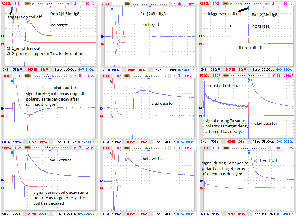

                    Another great thread. I have also tried getting the target models to show what I see on real PI detector.
                    I will be trying suggestions.
                    Also working on a new PI detector that uses IB coils and a PIC32 to sample and analysis both TX on and TX off wave forms. Hoping to do FE discrimination from the TX on.
                    I haven't yet started a thread on this but plan to in the near future.
                    Good simulation models will be helpful.

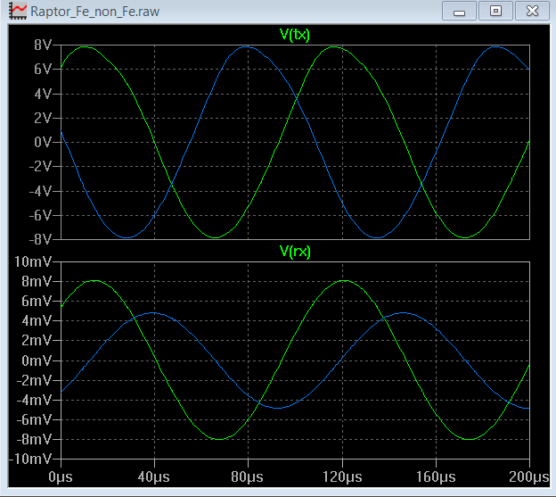

                      In my sim I had the bucking coil change with mu in the same proportion as the Tx and Rx coils, which is probably less since the coupling with the target is much lower.
                      Ive modified the parameters as follows:
                      .step param Mu list 1 2
                      .param Ltx table(Mu,1,6m,2,6.03m)
                      .param Lnull table(Mu,1, 600u, 2, 601u)
                      .param Lrx table(Mu,1, 6.5m, 2, 6.5325m)
                      .param Ltgt table(Mu,1, 1u, 2, 1u)
                      .param Rtgt table(Mu,1, 1R, 2, 2R)
                      Inductange change with ferrous target: 0,5%
                      Null coil change with ferrous target: 0.15%
                      Fe and non-Fe having the same shape, same inductance, same resistivity.
                      This is what I get (blue trace = Fe):
                      The amplitude without a target is 7.6mV, so I believe this better mimics your real life tests.

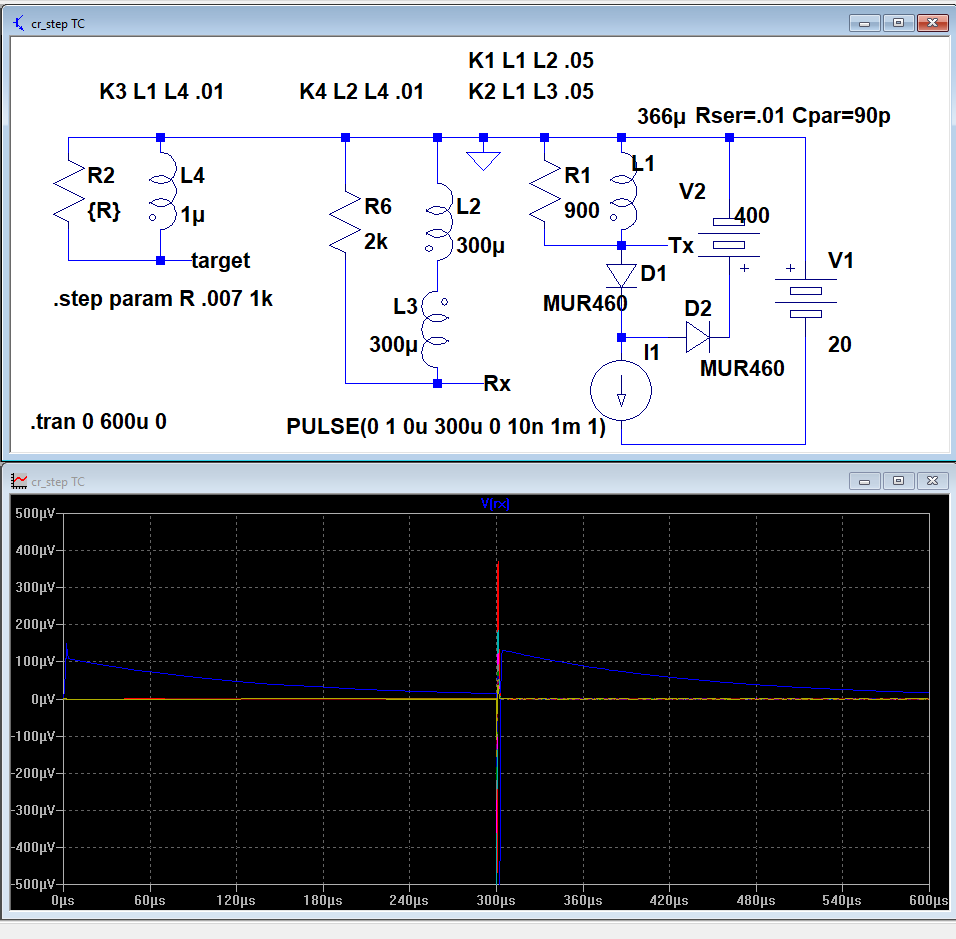

                        What I get with my PI. Don't how to simulate ferrous targets either. Simulation kind of compares with my detector circuit with a 143usec TC target(clad quarter). Simulation straight line decay linear log chart(signal amplitude similar at beginning of coil on and target decay after coil off) where quarter is not straight line decay until after 150us so signal is higher at beginning of decay compared to coil on amplitude. Think ferrous simulation should look similar to what I get with my detector. Simulation_143us target and 1ns target(no target).
                        Not awake again! scope pictures labeled wrong for Rx coil size, should be reversed.

                          Hi Teleno,
                          The results look more realistic than before. However, I can't help thinking that this is more of a "fudge" than actually what happens in practice. Although the target affects the coil inductance to some extent, the small change I measured was with a large iron bolt in contact with the coil.
                          In reality, the differences between ferrous and non-ferrous targets has more to do with the phenomena of absorption and redistribution.
                          Non-ferrous conductive targets will have eddy currents generated in the surface, which (according to Lenz's law) will generate their own opposing magnetic field. The produces an imbalance that can be detected by the RX loop. In addition there is a phase shift produced when compared to the applied TX field, and the amount of phase shift depends on the conductivity of the target. Different targets also have a resistive element that causes some of the transmitted energy to be absorbed. Likewise this can be detected by the RX loop.
                          I suspect that a core model may be the only way to go.
