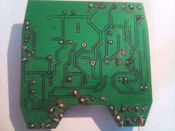

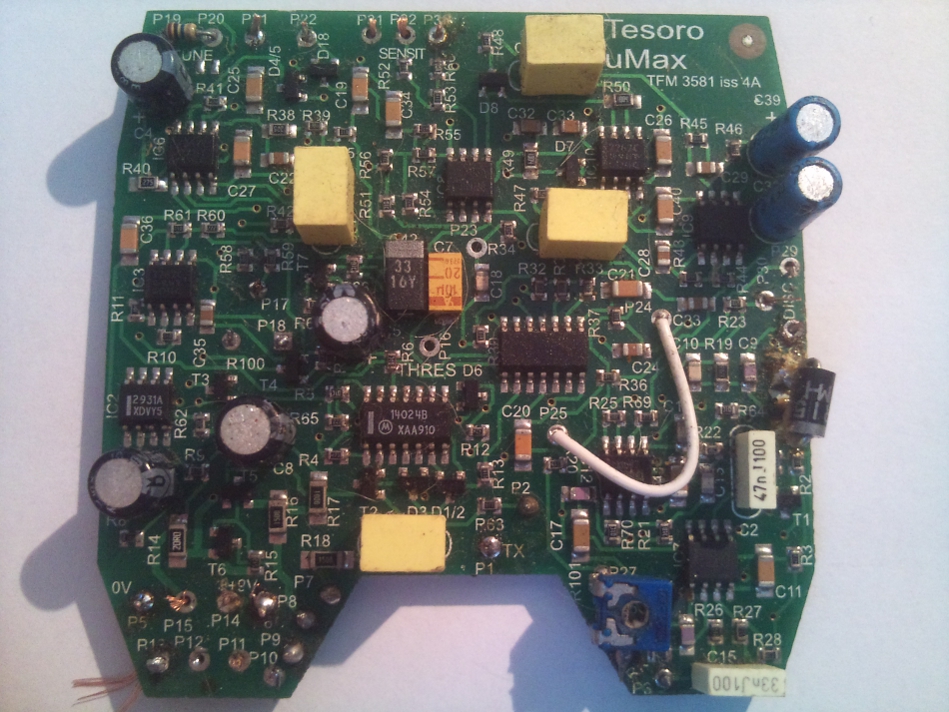

my tesoro silver uMax is "broken" if I power the unit with battery i only measure 2.4 V across the battery (fully charged) and no sound came out (detector dead), the battery is drained fast.
if i power the unit with a bench power supply the unit works as normal...
it is obvious to me (i hope) that there is some form of "short" somewhere and the bench power supply has enough power to feed the short and the circuit too, but the normal battery can't.
what I'm asking:
have you ever experience a failure like this ?
in which part of the circuit i should look to find the problem ?
additional information:
the repair process....
i have desoldered audio transistor thinking of a failure of the audio stage but they are good, so i have tested the micro controller (pic16F73) and i have noticed that no "audio signal" is coming out from RC0 RC1 (pin 11 - 12).
if i connect the bench power supply a beautiful 390 KHz square wave came out of those pins..
so i decide to reassemble all to discover that with bench power supply the unit is working as new...
